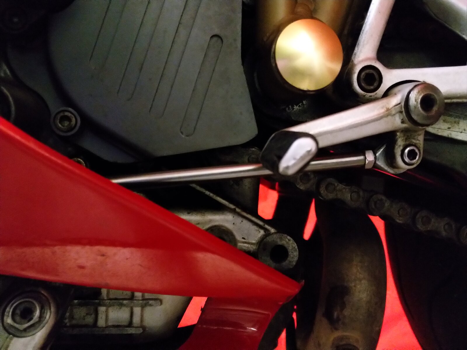

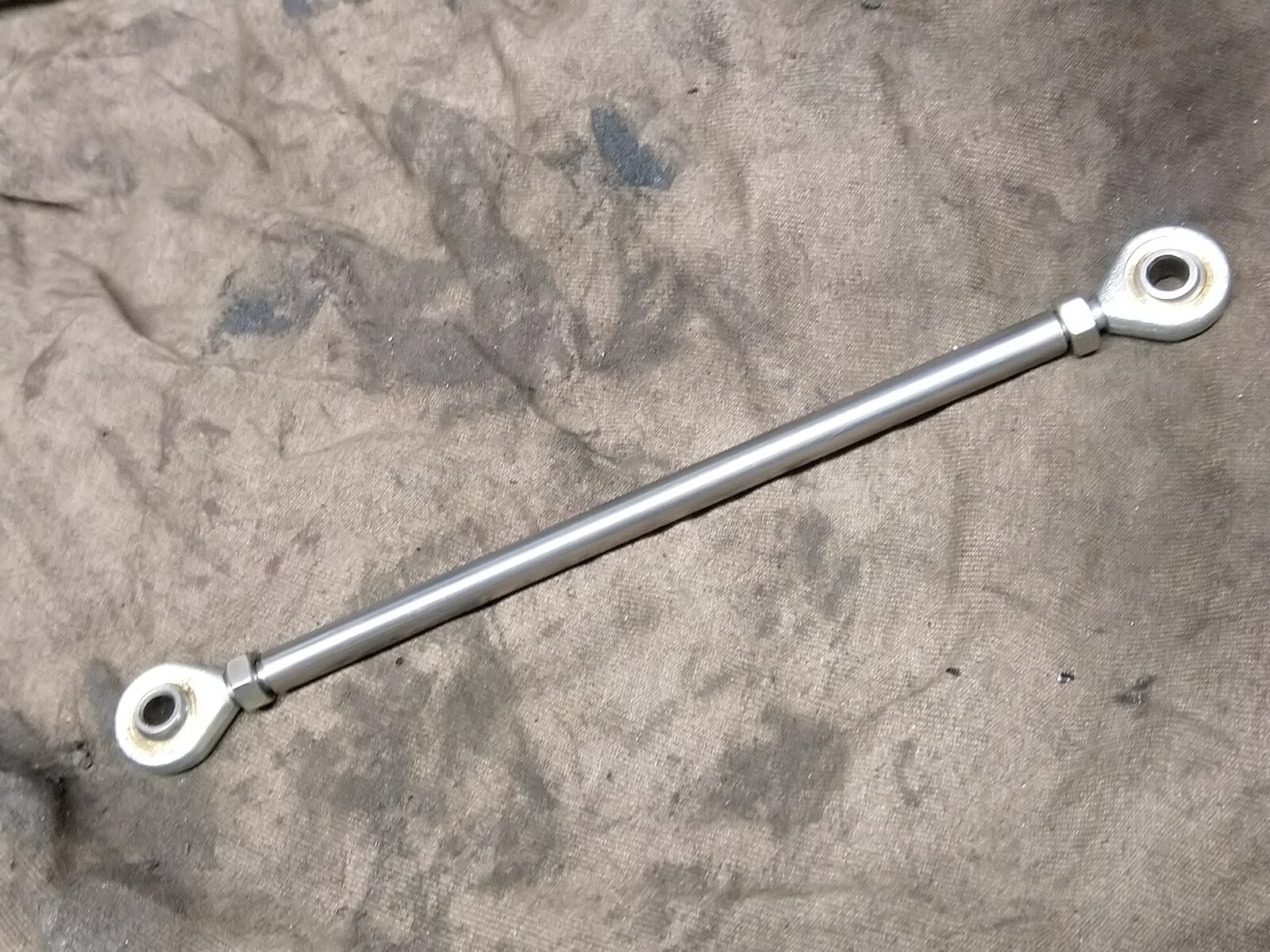

    Having removed the quickshift, I have no linkage on the gear selector, so I ordered a 150mm length of titanium tube, 7mm o/d and 5mm i/d.
    I've never worked with titanium and couldn't believe the heat generated just cutting a thread by hand, had to take it very slow and the smoke was pouring off the cutting oil. Eventually got it threaded by working through all three taps, 1 turn in-half turn back.
    Once tapped I polished the rod on the buffer and the bolts that fix it in place
    And then fitted to bike, simple and clean.
    Need to do something about those tacky gold frame bungs - what should be in there? Nothing?
  4. Great work mate :upyeah:
    There should be no bungs, just whip em out and all good
