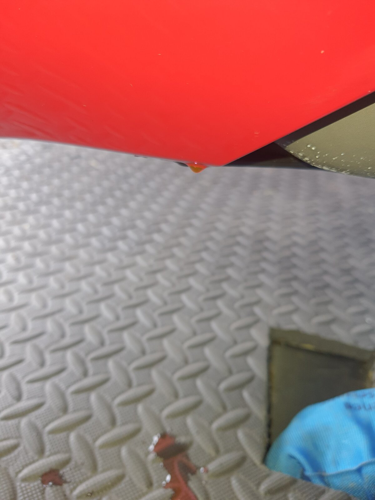

  1. Good evening sir. Red fluid on the garage floor sir? Perhaps you should present yourself for questioning at the police station sir...

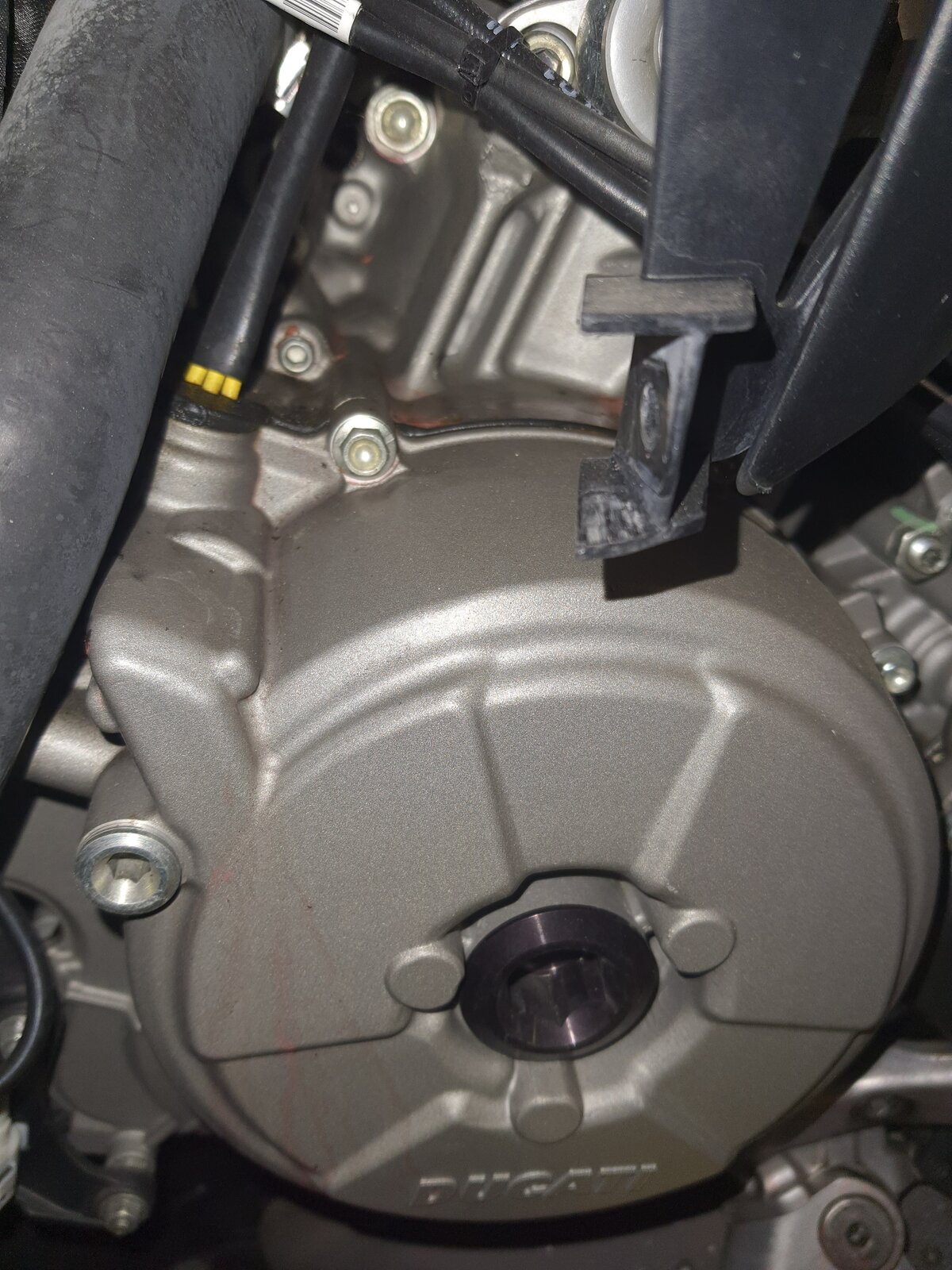

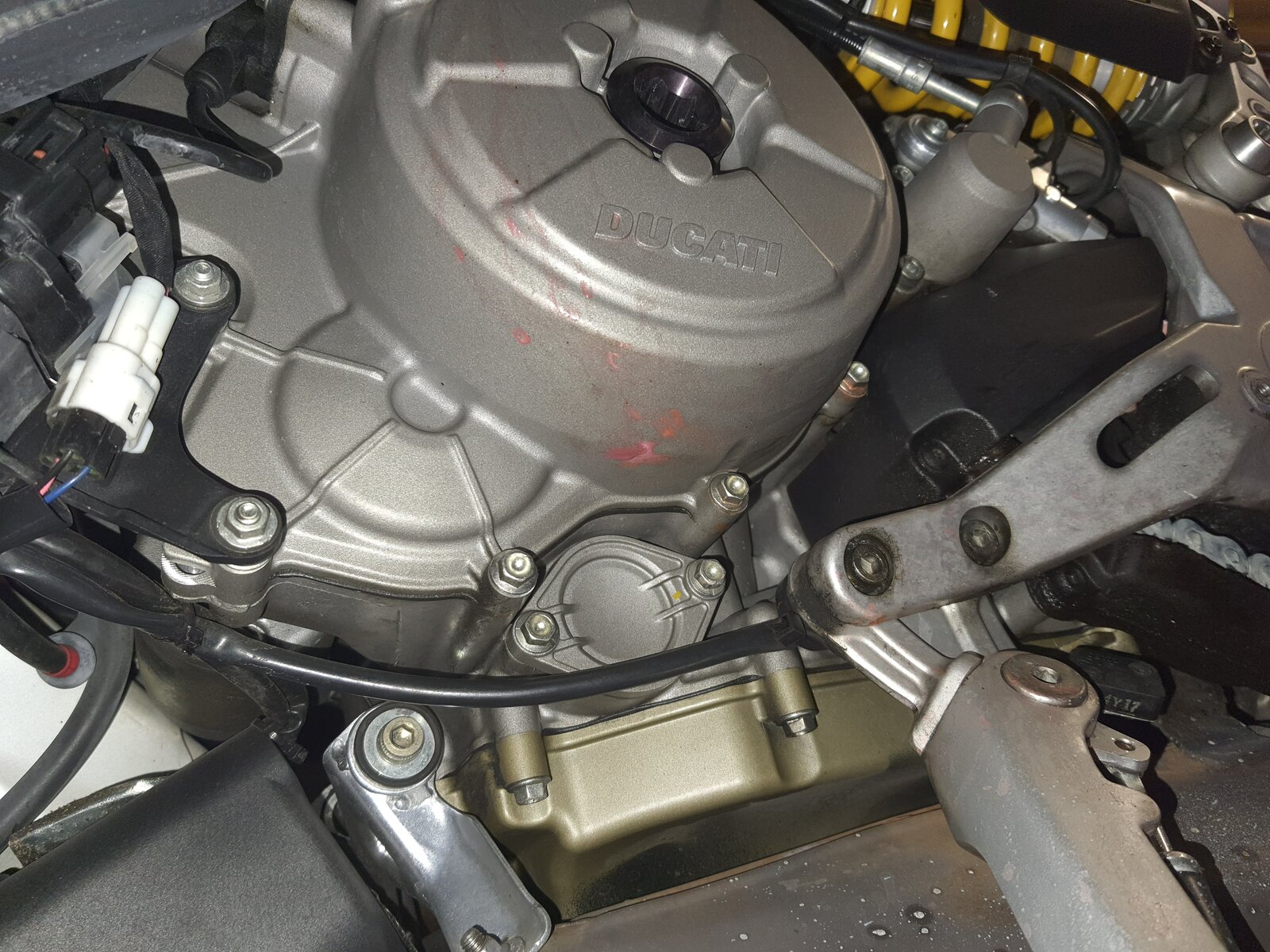

  3. Run the bike today to ensure battery wouldn't go flat and greeted with more fluid on the floor. Also discovered the coolant level window and looks empty.
  4. It's the water pump failed, had it on my 899, my mate had it on his new 959 and I've seen dozens, infact if you google it you'll see loads of threads on it. Coolant starts to leak out of the relief hole at the back of the water pump (between the V) and when on a side stand it runs down around the front of the stator and out the bottom of the fairing.

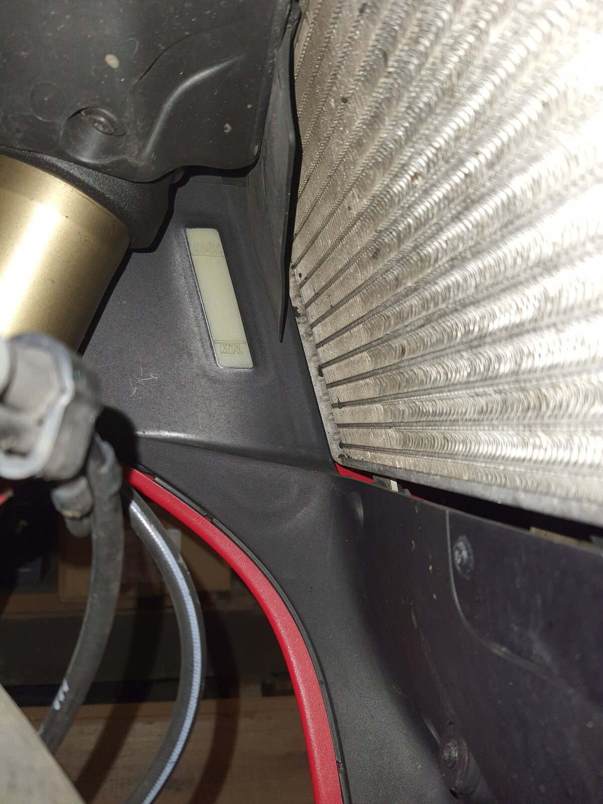

  5. No way of seeing it as can't get light into it
  6. Took the right side fairing off and checked the clamps, and the radiator cap. All look fine. Will take off the left side tomorrow and run the bike to see where it originates from. Hope it isn't the water pump.

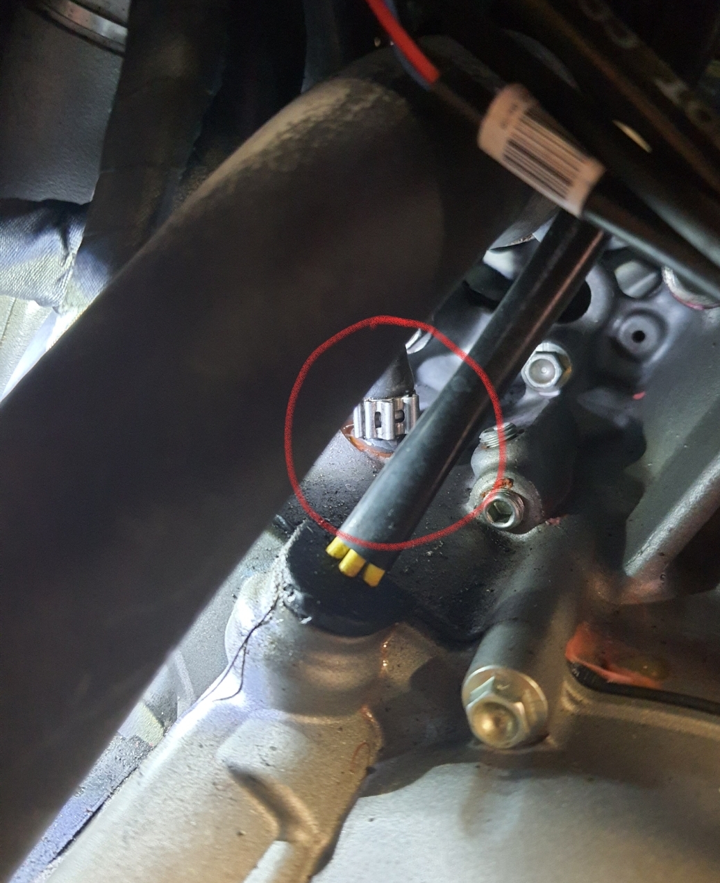

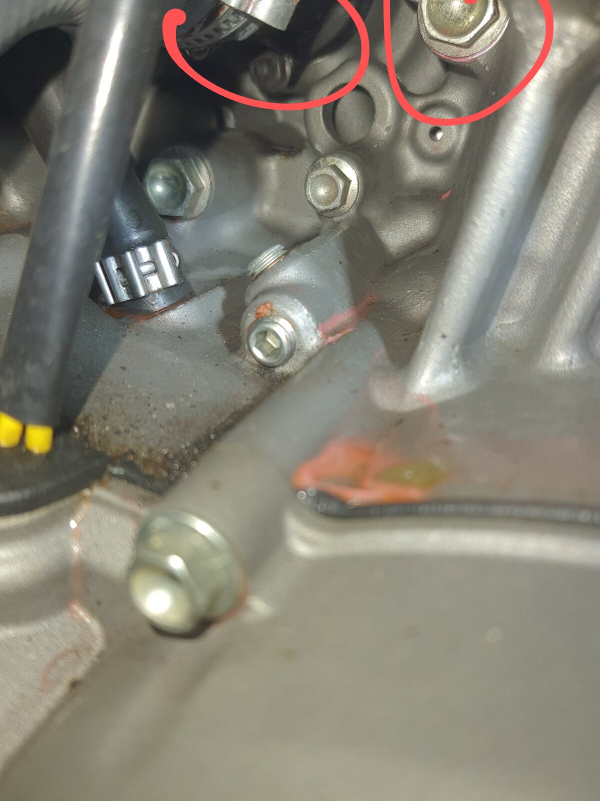

  19. I may have found the culprit. Its a mess down there but looks like coolant is pooling underneath this clamp (red circled)
    What do you guys think?
