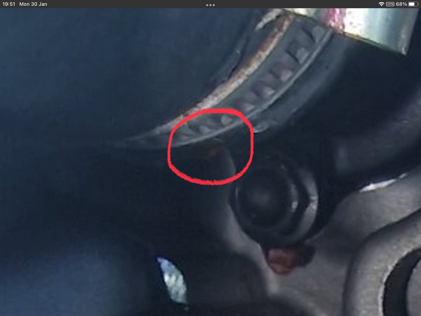

  1. I can see traces higher up (red circled) .....BUT ....it's possible air flow could push it up I guess ......could you clean it off and run the engine ...? ....if there's enough coolant in the system .....try to look higher up in the coolant system.....just my thoughts.
  2. Started the bike, and you were right, it is dripping from above. Will try tightening or replacing the clamp.
  3. Good news ....
  4. Don't forget even if you nip it up and stop the leak ...there may be some residual coolant hanging around between the hose and pipe stub ....... So run some hot water over the area to flush it away maybe ? ...then dry it off ...

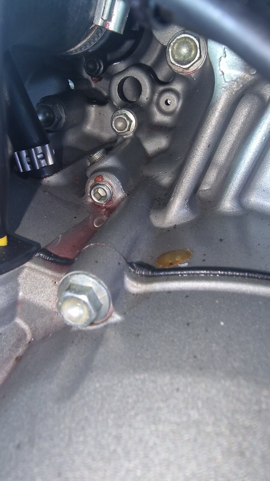

  15. Pic below
  16. Sure its not leaking out of the hose above, I see something when I blow up the pic.
    Other than that not a lot of goodwill out there!

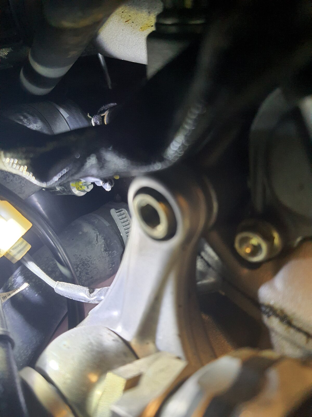

  17. Pic attached
  18. It does look it leaking from.above, but so tight hard to even get light in there. Hoping it's something like a lose connection but won't know unless obstacles are taken out
