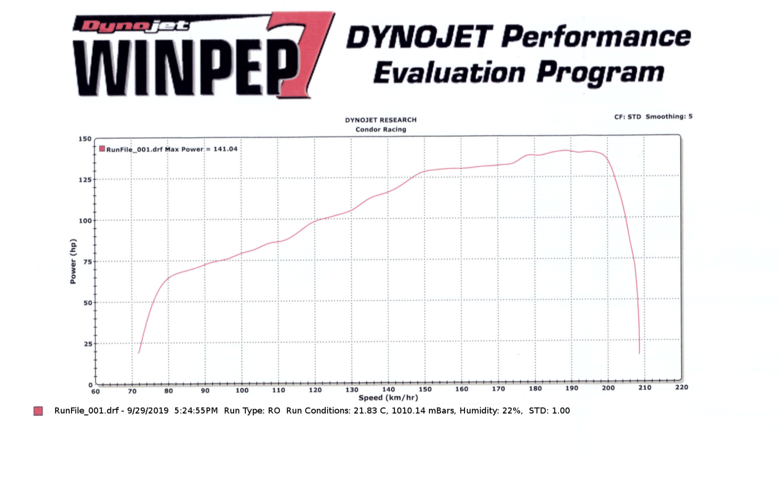

  5. The 1260 does not have the notorious dip in the powerband that the 1200 had.

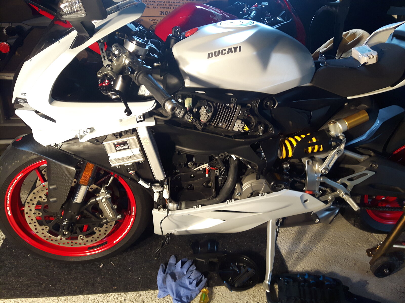

    Consequently, a Rapid Bike unit would not be the best solution. Moreover, there's an unconfirmed report that the harness may not be long enough to reach the pillion section which is the optimal placement of the control box unit. I have one left over from my Panigale and have not ordered a 1260 harness for that reason.
    A decat must be done right. Just slapping a cat bypass and using the stock exhaust end piece will make your bike obnoxiously loud and your A/F ratio will be out of whack where the bike will run crappy.
