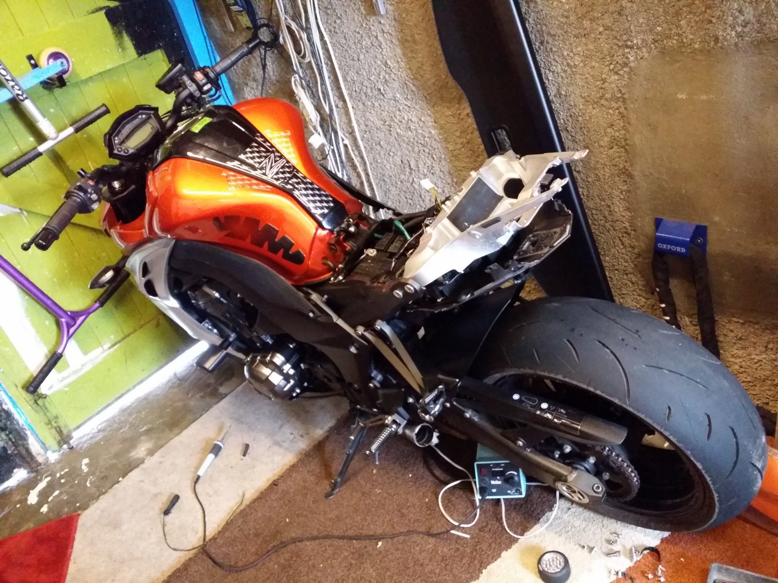

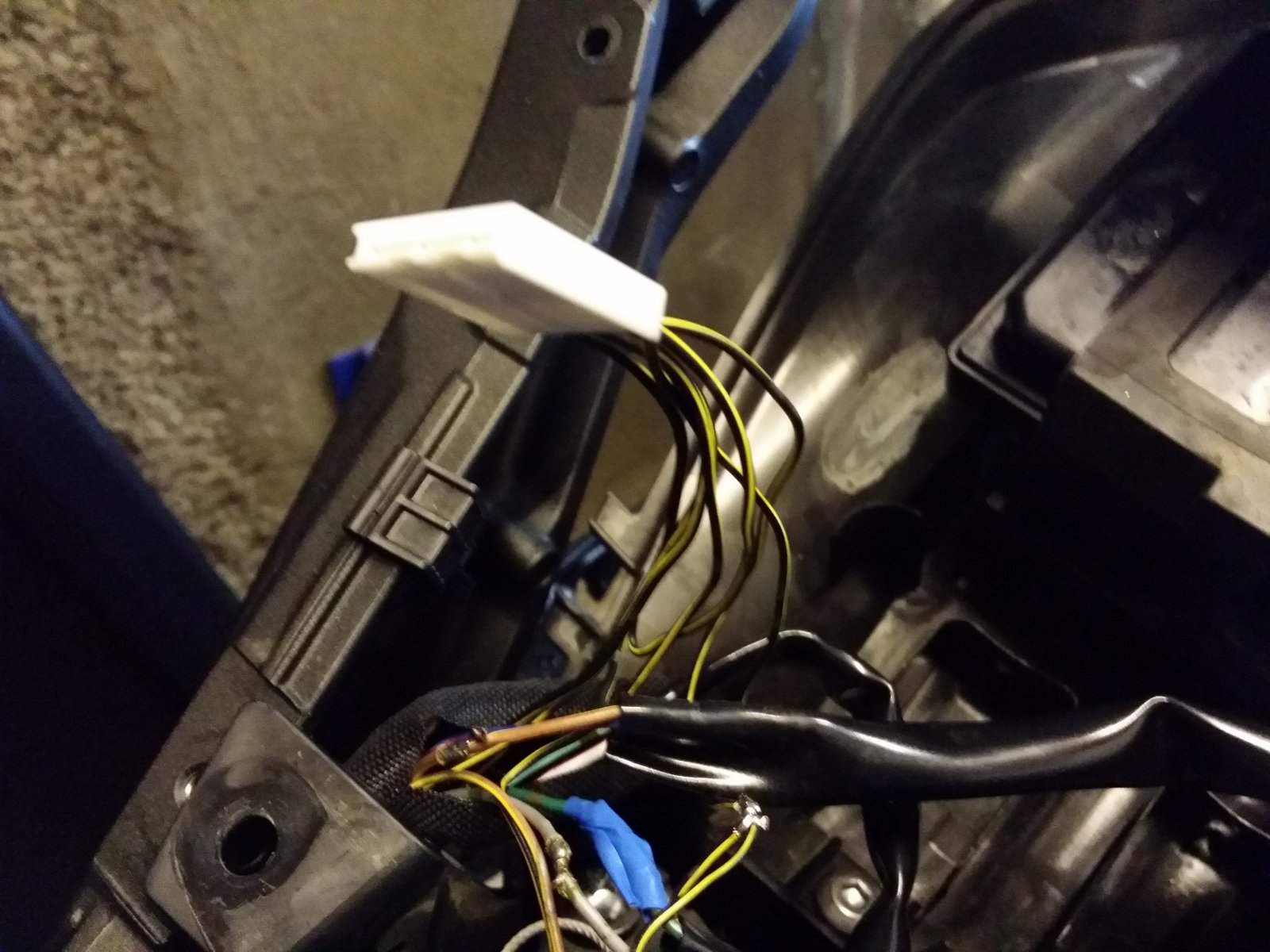

  2. Crisis over lads - its out!....not too bad in the end - the only thing that pisses me off is that something I didn't really want someone paid for to cut into the loom plus they drilled into the rear panel by the light for the LED - so, gotta order that.....never mind - its out now...
    2 wires to the indicators
    1 wire to the power
    1 wire to the rear light
    1 wire going to a plug which wasn't going into anything....is that some sort of diagnostic plug??
    My new bike - not even owned for 24 hours!!
    Gents - thank you very much for all the help and the people that had with their alarms what I could forsee what would be inevitable...Gotta buy another roadlok now as mine doesn't fit!!
  3. Looks like it was wired in just to make noise and not immobilise any circuits.
  4. Good to know - at least he didn't bite into any more wires !
