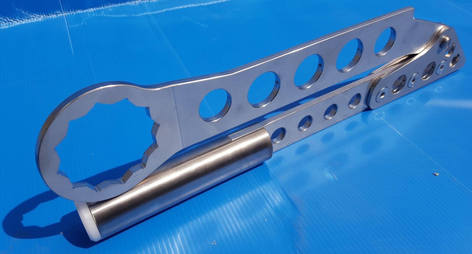

  6. If you feel the breaker bar is a little ungainly, then you can also get a custom folding wrench from Ulf at UHR-TEC.
    You will still need socket and torque wrench for refitting of course.

  7. Half the trouble is the socket rolling off the nut.
    Get a machine shop to face off the socket, so it isn't so deep.
