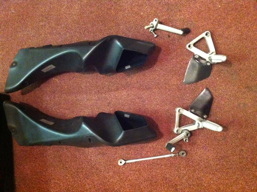

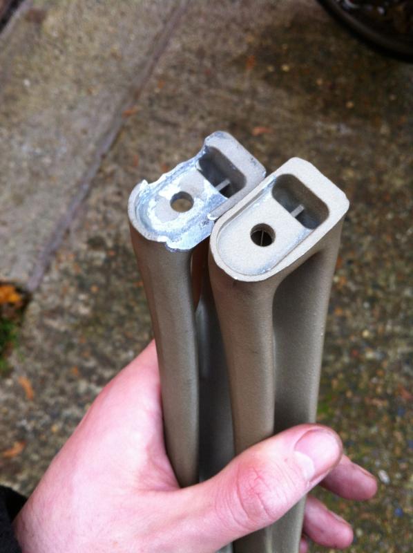

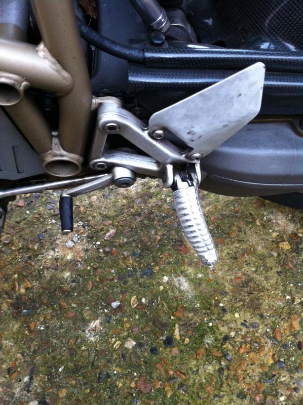

    I recently bought the below, standard air tubes and rear sets with the linkage, mint condition.
    Only need the LHS rear set but it all came as a set, I'll probably sell the rest, including the heal plates.

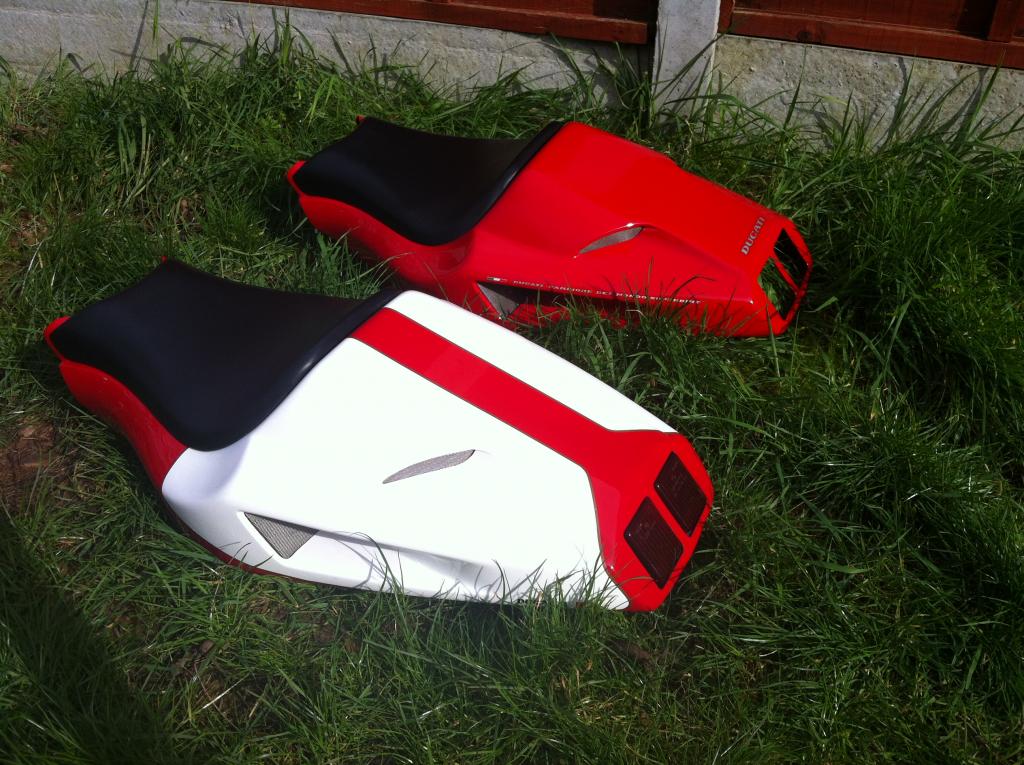

    Since the last update I have managed to buy these parts:
    Tank
    Tank pad
    New fuel filter and O ring
    New LH indicator
    Another nose fairing (better condition than the one previously bought with a bit missing)
    Mirror support
    Brand new clutch reservoir with new lever, bottle etc from Ducati
    Bar ends (74p each!!)
    Front paddock stand
    Headlight
    OEM mirror bolts (purposely snap)

    Fit rear sets

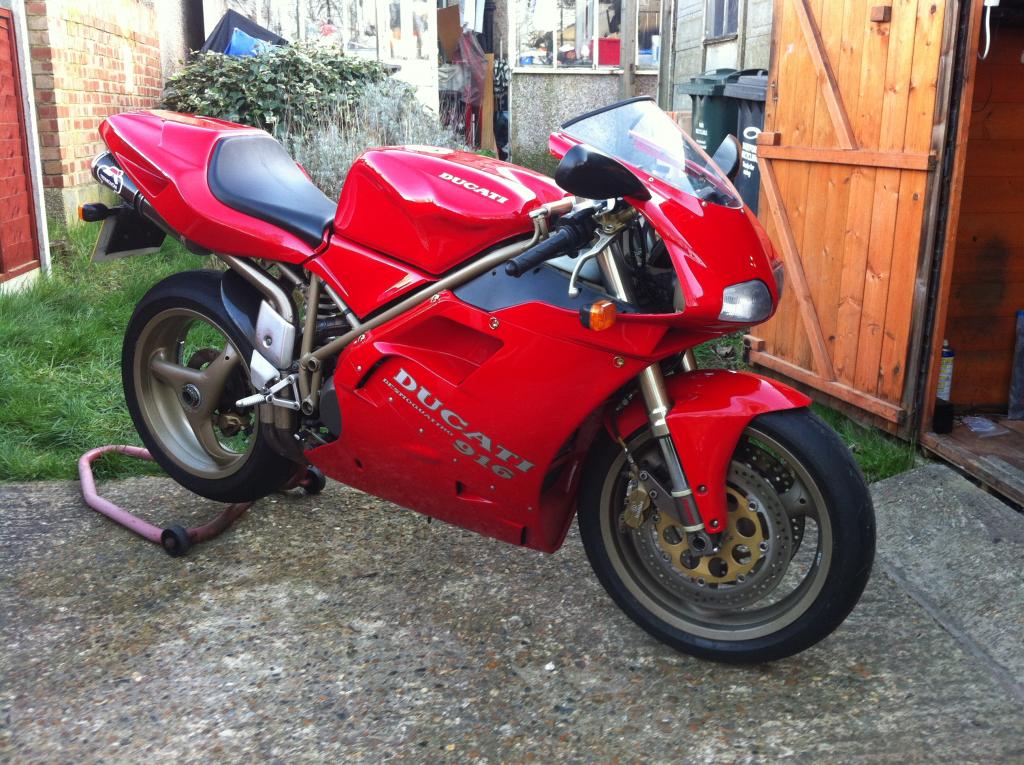

    Here are some pictures:

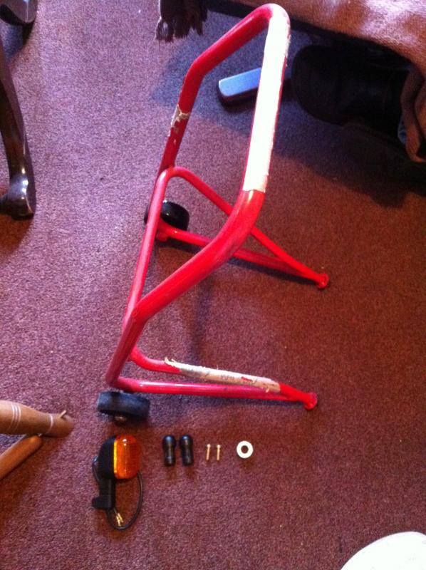

    Front paddock stand, LH indicator, bar ends, mirror bolts
    New bar ends fitted
    New mirror post, comparison with old one

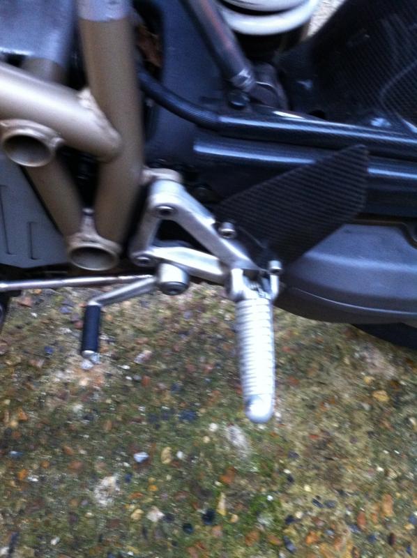

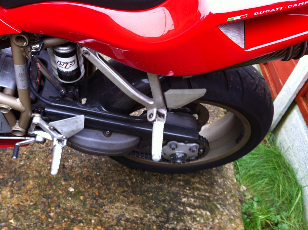

    Before and after with rear sets (will be selling carbon heal plates)

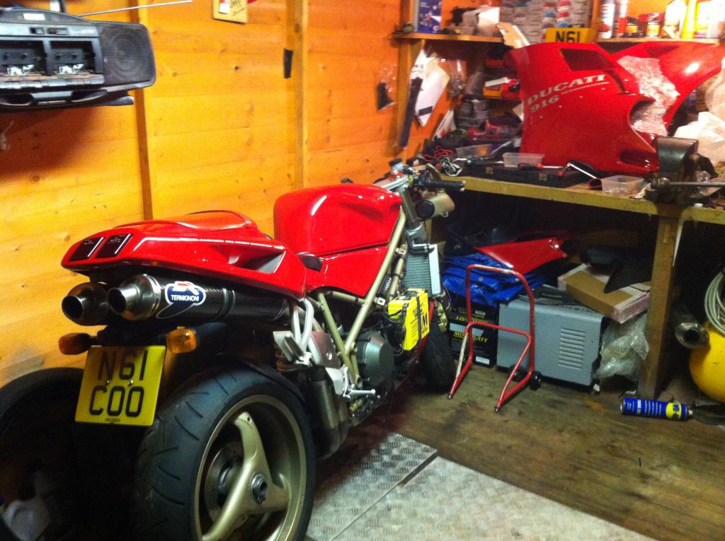

    As it stood when I worked on it a little while ago, pair of scrubs to go on.

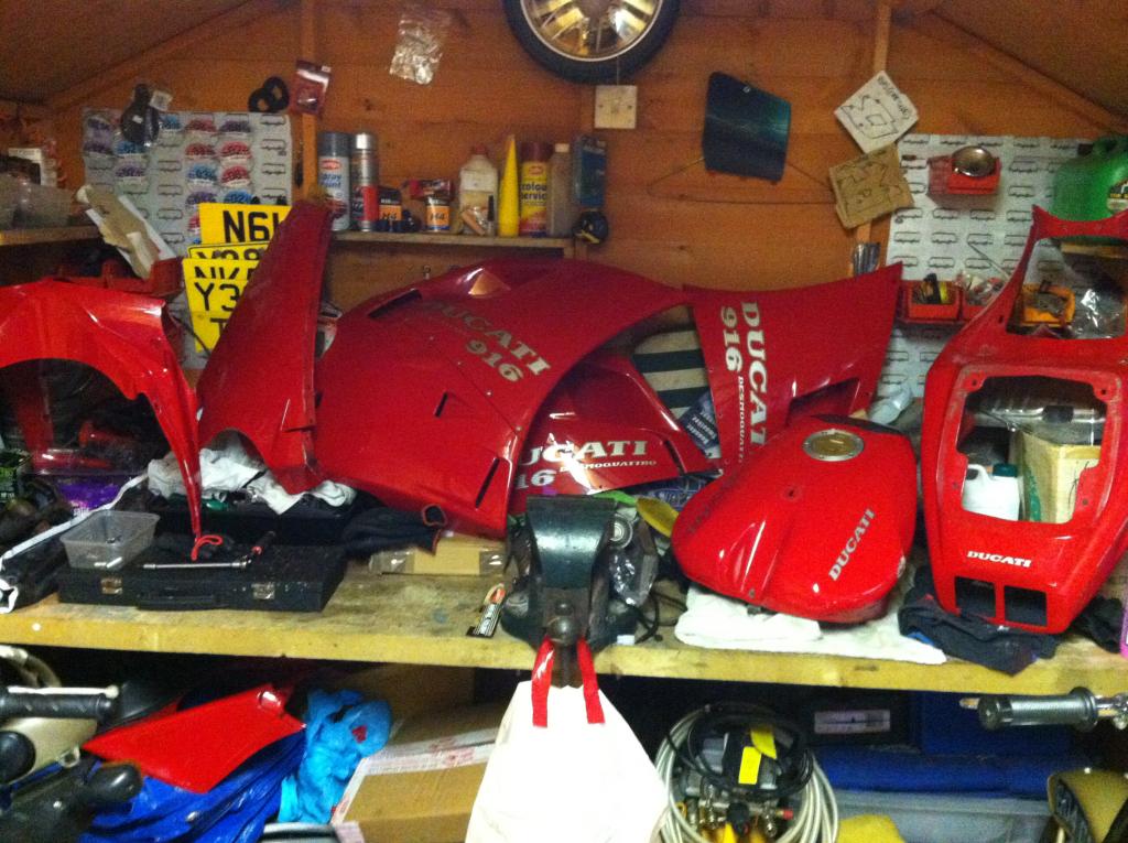

    My shed was turning into a parts shop!

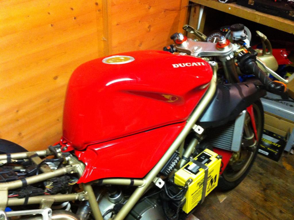

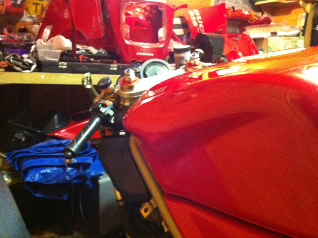

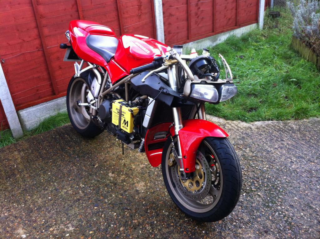

    New tank fitted, although will be coming off again to check alignment and to fit air tubes (quicker than unscrewing 18 bolts from the air boxes!)

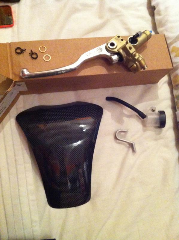

    New tank pad (to match old one), new clutch reservoir with lever, bottle etc)

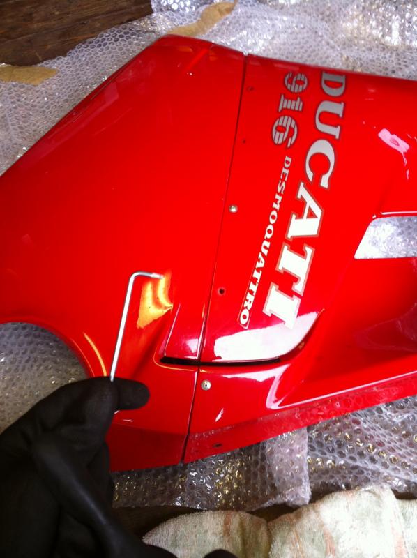

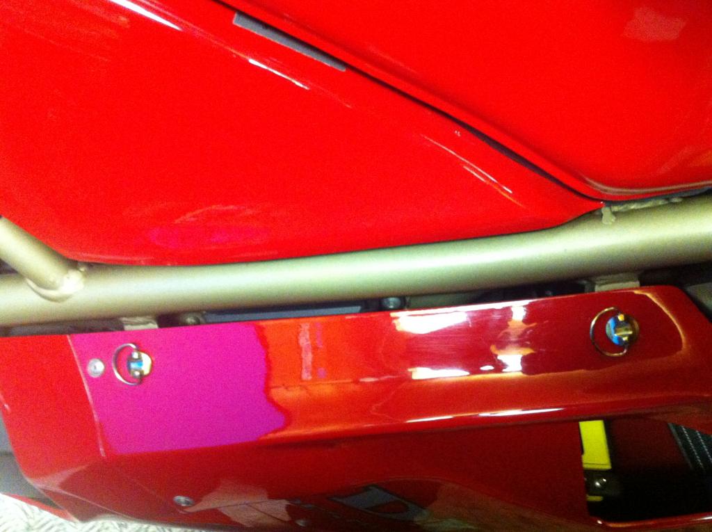

    Got to removing the screen bolts from the old panel, 8 out of 9 from the accident isn't bad considering how expensive they are!
    Fitting new bolts to the side panels which proved a little awkward getting the first couple in.

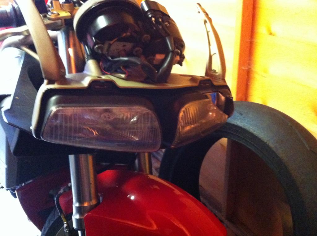

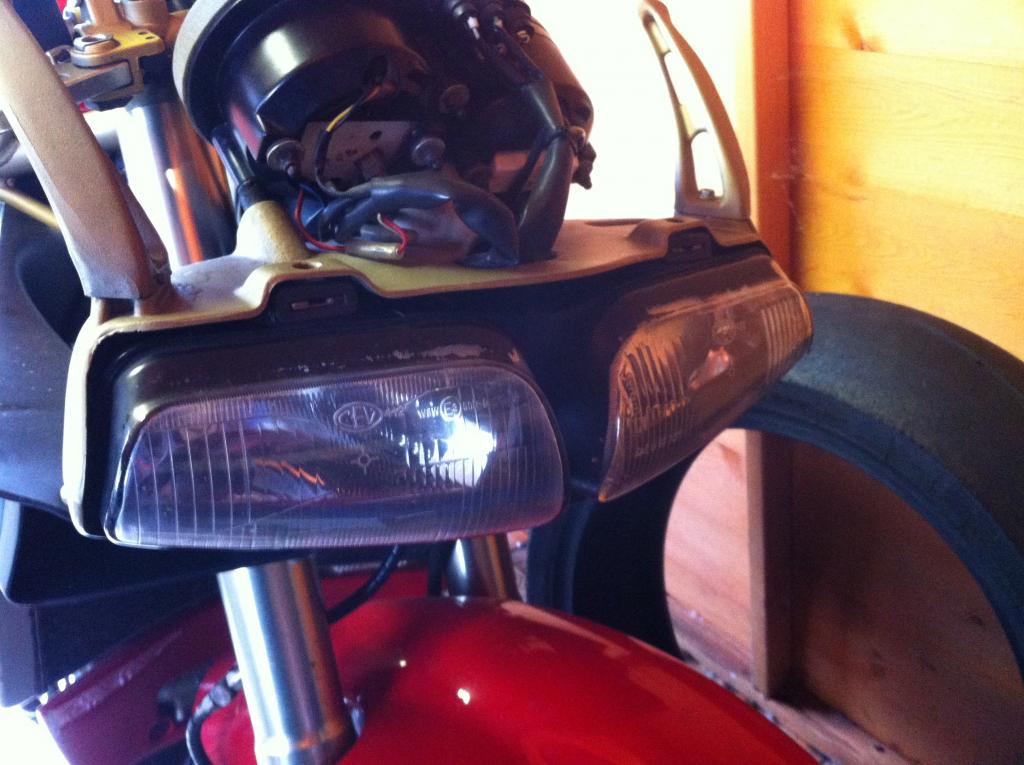

    Old headlight vs new (might clean it up a little bit - was a hard part to get hold of)
    End of today fitting the various parts and getting ready for tomorrow to do some more.
    Cheers
    Jeff

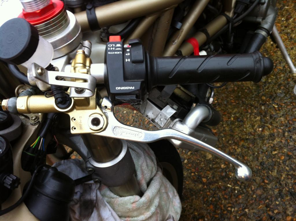

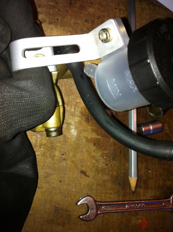

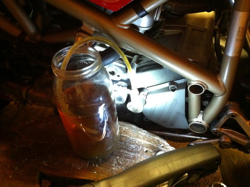

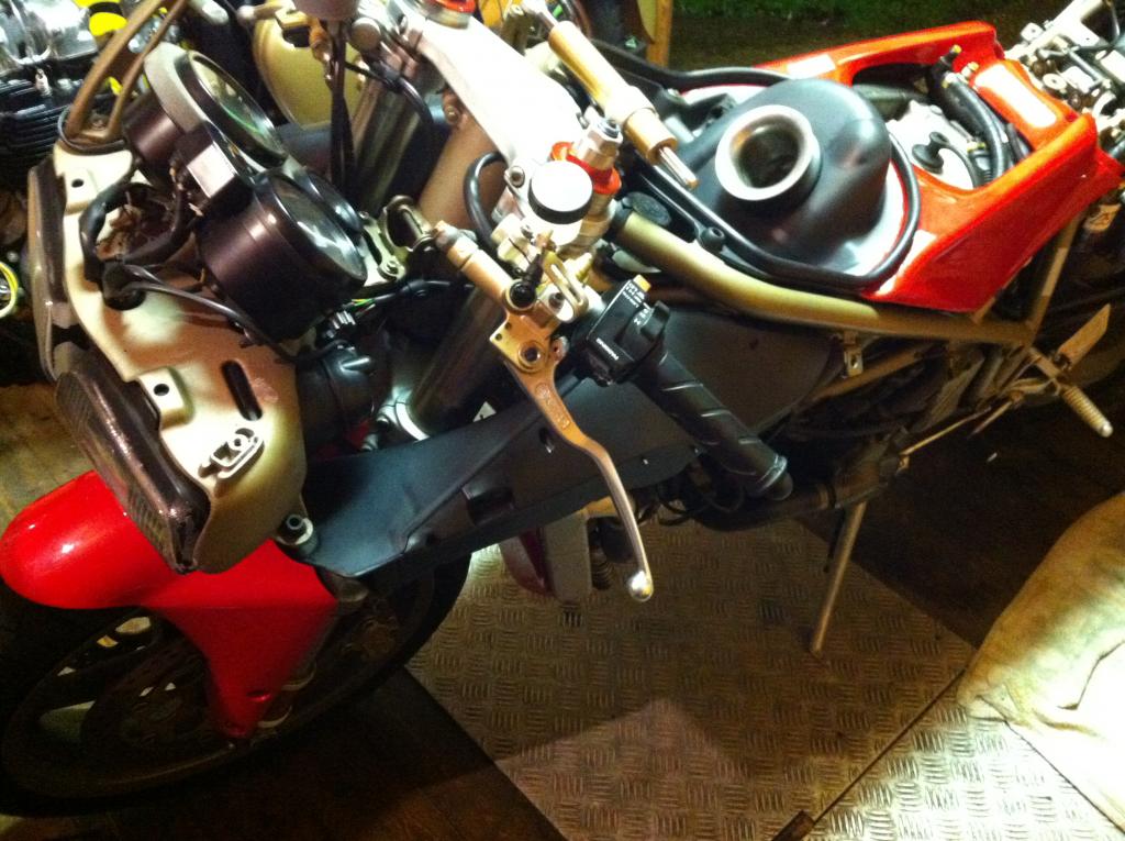

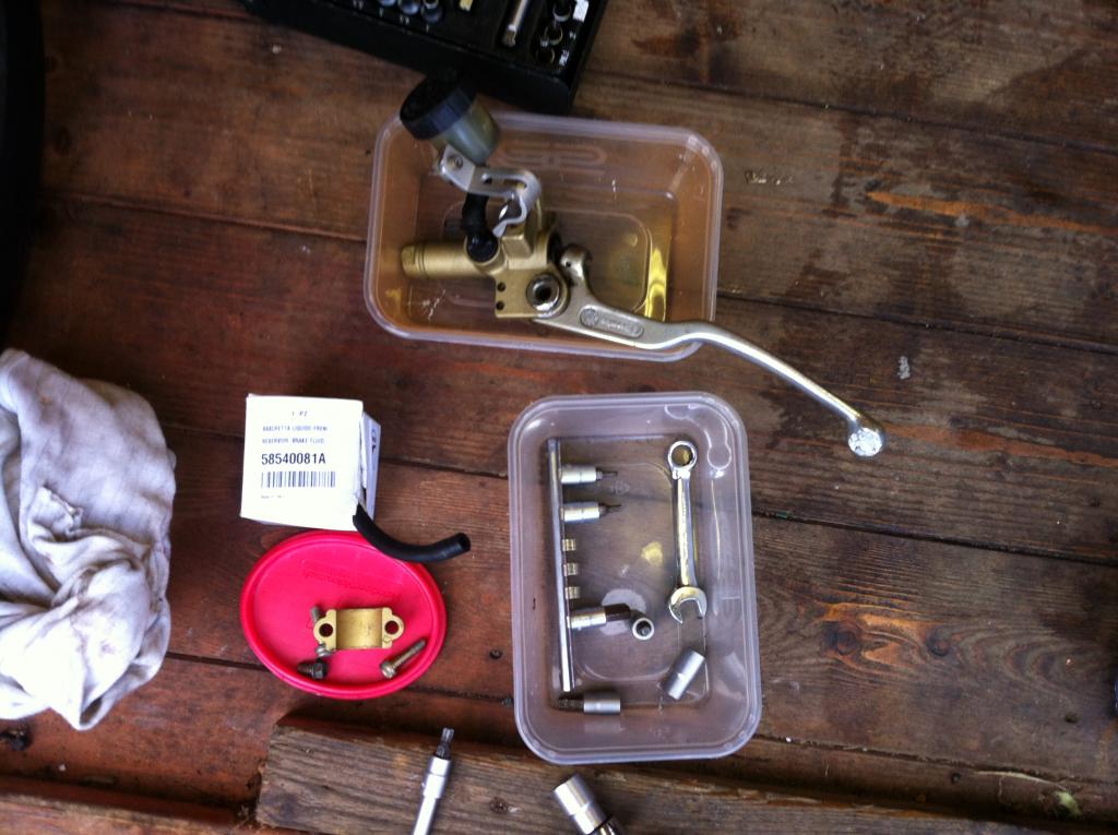

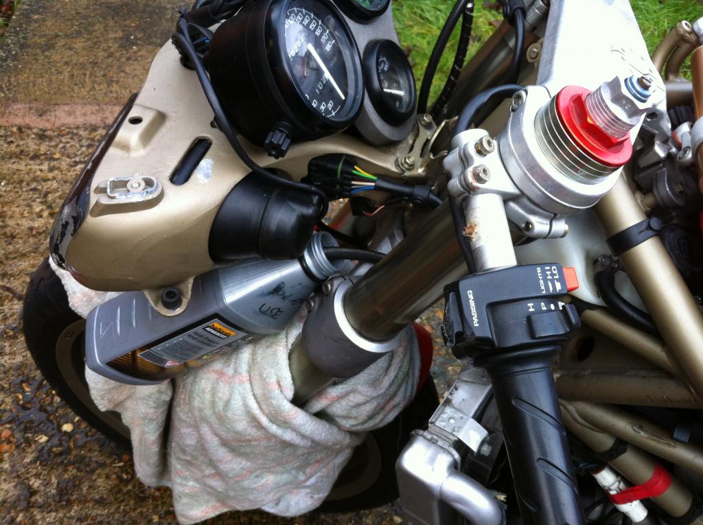

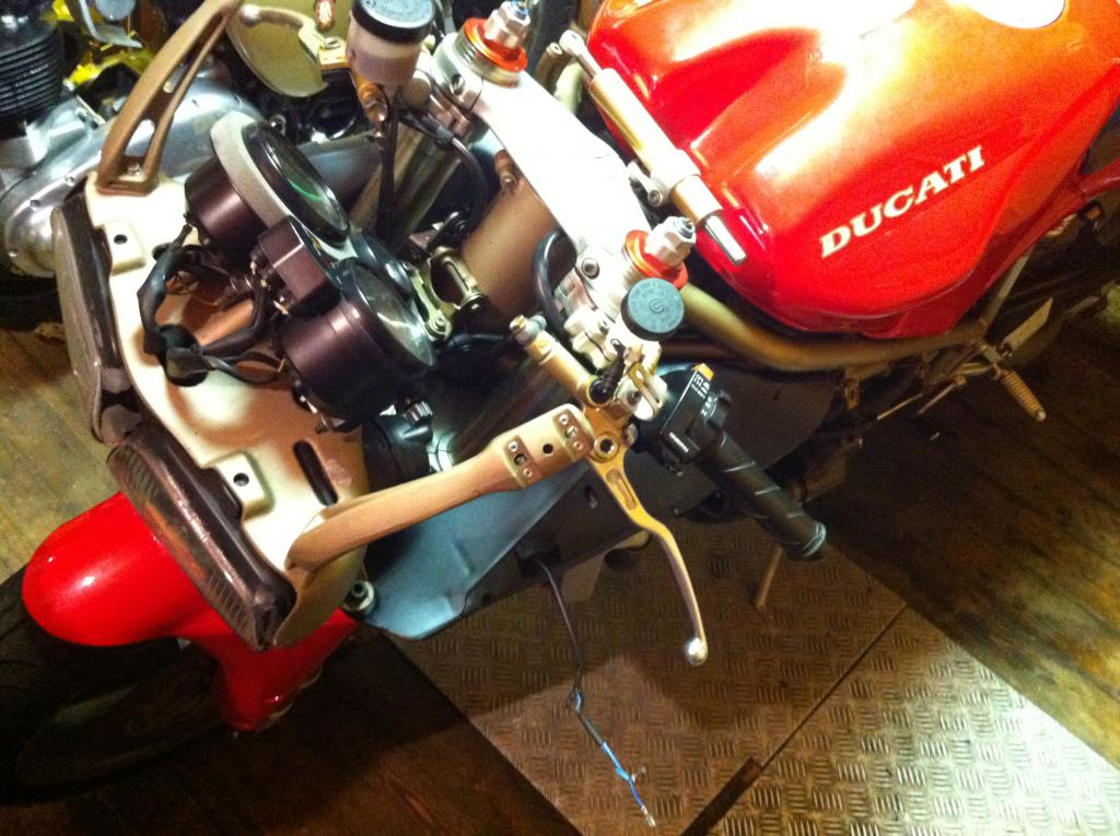

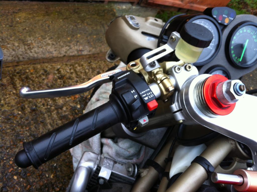

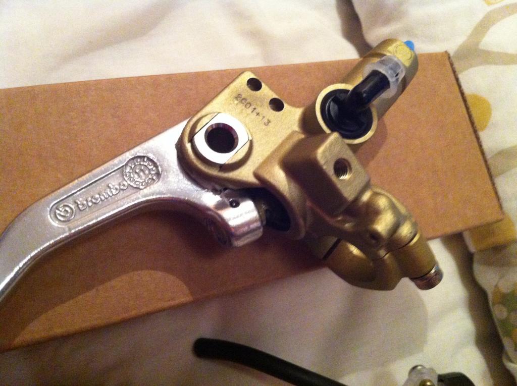

    I realised that before I could do a few things the main bit to do was the new clutch reservoir change over.
    I set up rags around the area just in case of spillage. First loosened the banjo bolt whilst it was on the handlebar then did it up finger tight. I had to loosen the bolts holding the clip on on so it could slightly twist so I could get access to the screws holding on the clutch reservoir. Once the reservoir was off the clip on I undid the banjo bolt and put it in a container.
    Then I put the old one in a container to contain any fluid.

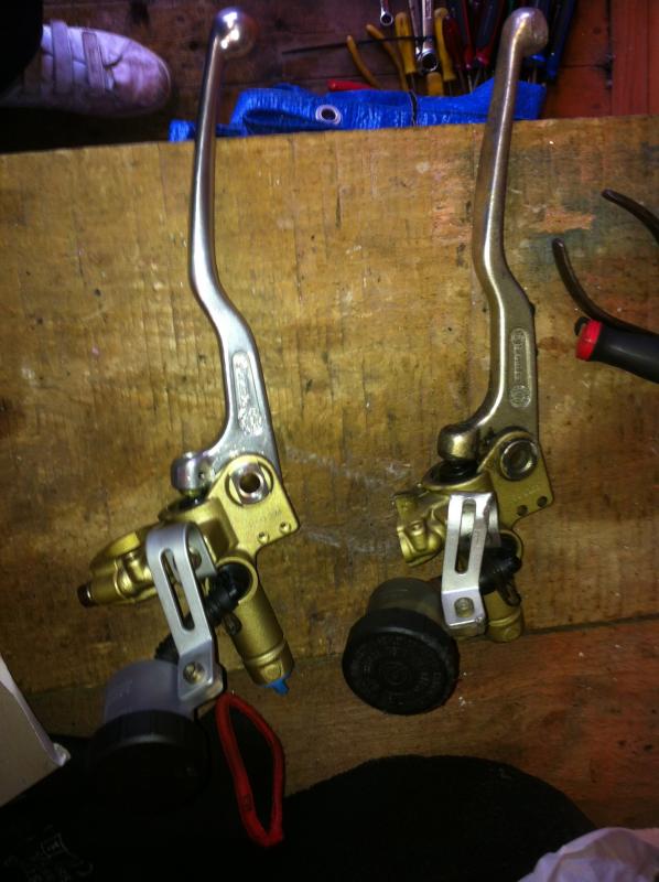

    The new reservoir came in parts and I had to attach the bracket and the hose which was about 5 times the length it needed to be. So cut the tubing down and added the clips.
    Once that was done, here is the old vs the new:
    Then was fitting it back to the bike. It first involved loosing attaching the banjo bolt. Then the bracket was loosely put on to get it all in position. (There is a locating lug on the clip on which makes it perfect fit)
    Was all well and good getting to that stage but then it came to bleeding the clutch as it had air in the system from the changeover. It involved a tube in a jar for the excess fluid to come out from the clutch. At the reservoir end the cap was loosely on. It involved a quarter turn on the nut at the clutch end then pulling in the lever. Tighten the nut quarter turn and slowly release the lever. Kept repeating till there was no visible air bubbles going up the tube.
    Was glad it all went smoothly. Next job was to get the air tubes on, easiest way (as I had already done up the screws - 18 of them) was to remove the tank, just 2 quick release fuel pipes, electronics and a breather. I wanted to re align the tank anyway as I don't think it sat perfectly. Rear seat unit was also removed as it was a 30 second job. Air tubes went on and clipped inside from the airbox.

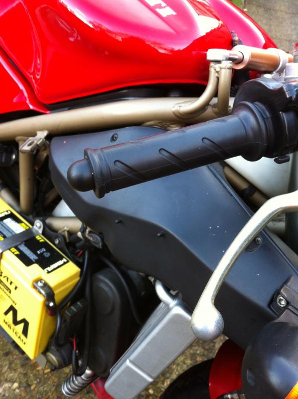

    Then the tank went back on and the seat unit. Then I added the mirror support and fed through the wires of the indicators.
    This was how it was left for today as the next job was to fit the front and side panels, mirrors, indicators etc. But what was stopping me was the nose panel's little vents on the new panel I got. One was very loose and came off with my hands just seeing the fit. So I've used some glue and they will set othernight. Then I can get the other bits done.

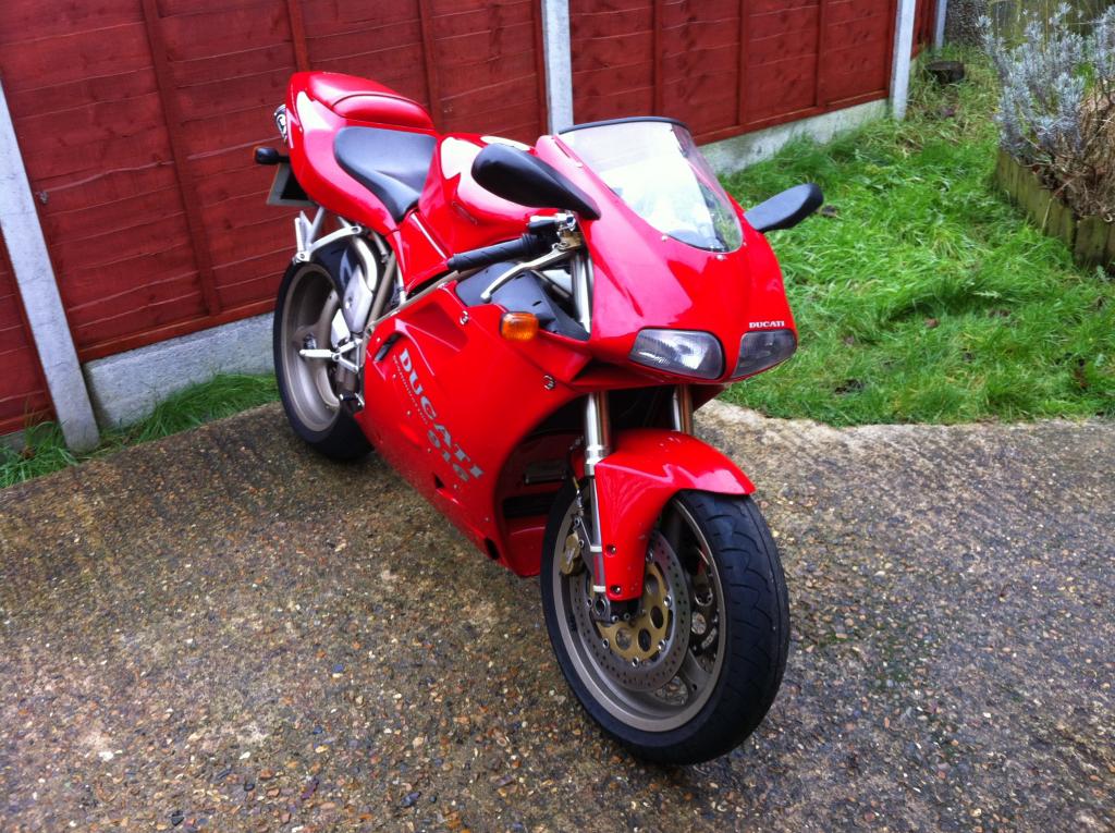

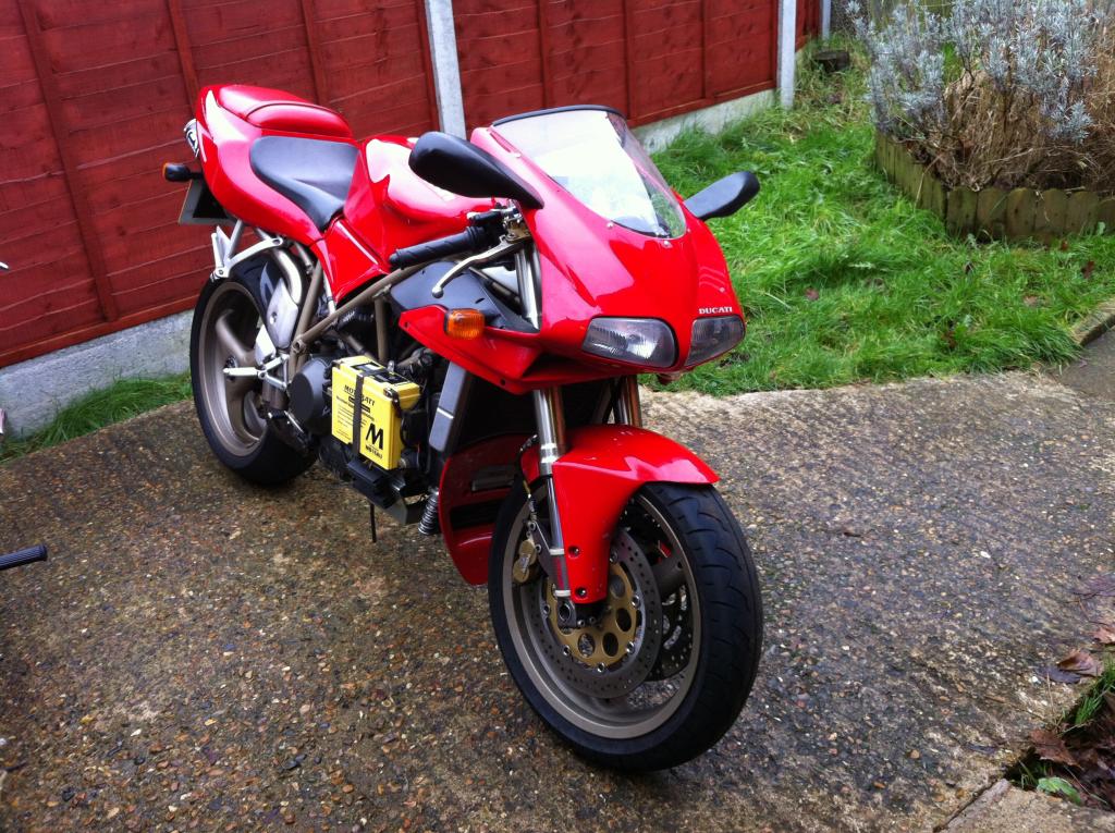

    The vents set overnight so I got round to fitting the front fairing. This is how it started (luckily didn't rain today)
    The nose cone went on ok, just had to adjust the mirror posts slightly for the best fit. Also put on the mirrors with the new bolts. Also thread through the indicator wires (new LH indicator also) and fit the indicators:
    Starting to look like a bike again! Next job was to get the fasteners attached to the nose fairing and connect the side panels:
    It's been so long since it has been together! Was very happy how it came out with the new parts.

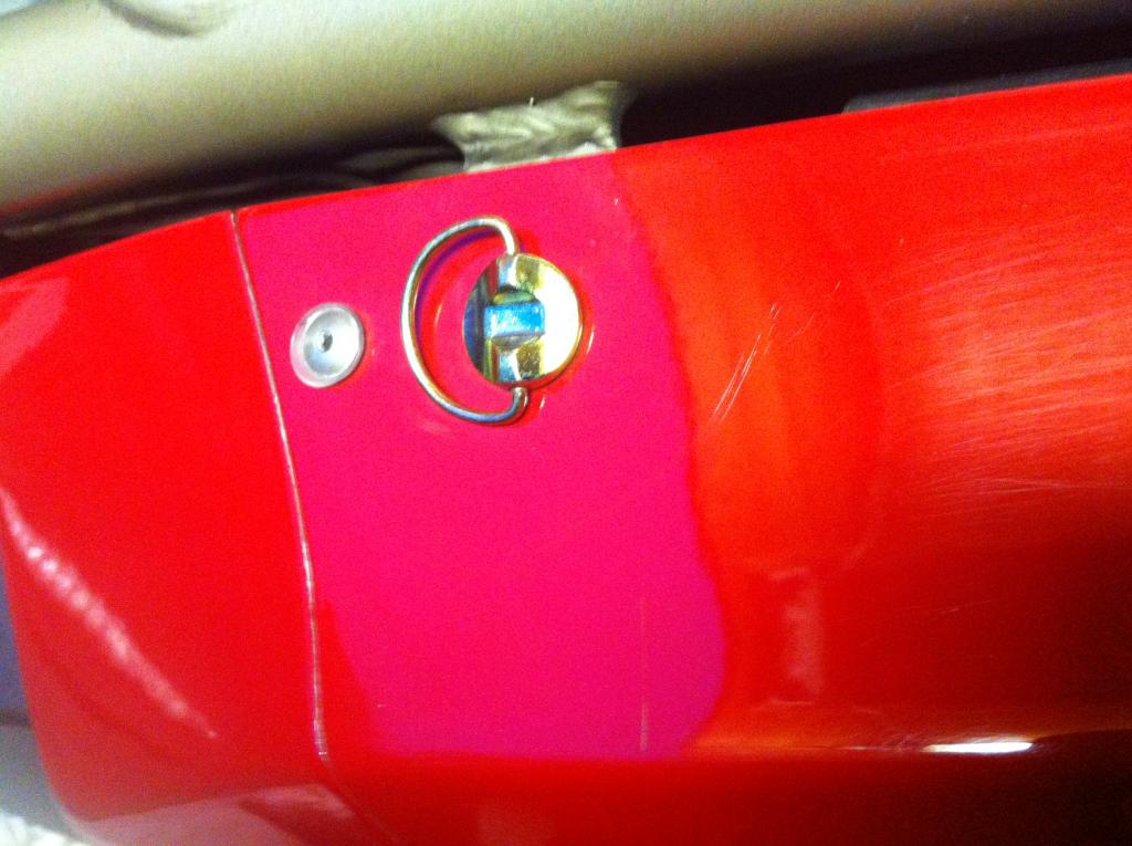

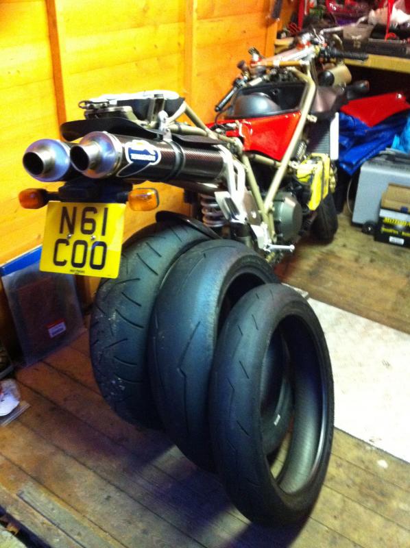

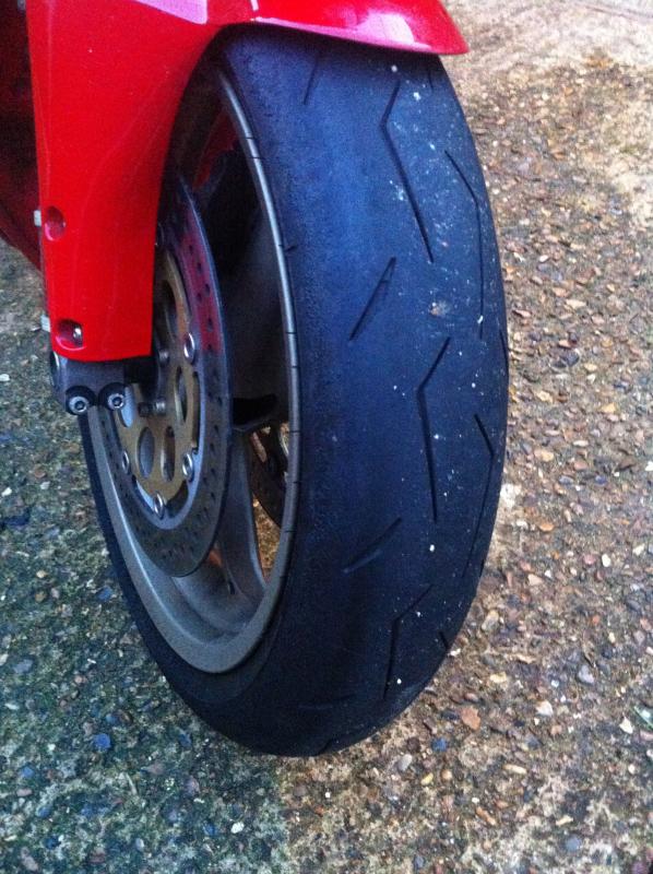

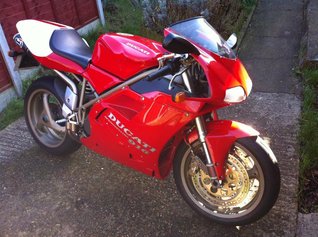

  13. So today I took a trip to my local Ducati dealers to get the tyres changed over and to have a general look around and see if they have any bits I need.
    Well I got the tyres changed over and whilst that was being done I was having a look at the bikes there. Noticed the standard fasteners on a few of the bikes there and took a liking so bought myself a brand new set :biggrin:

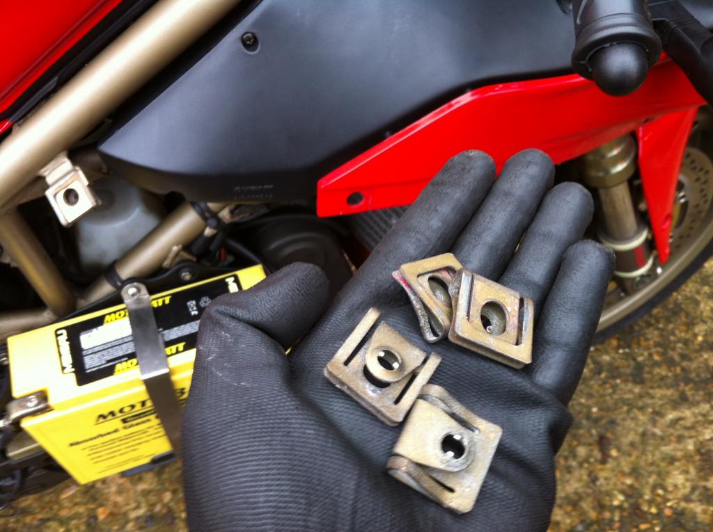

    Also got the 3 screen/fairing bolts needed and cleaned and polished the bike last weekend.

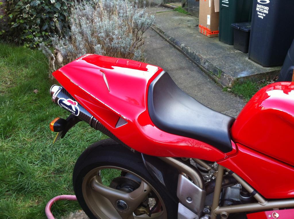

    On leaving the dealer, the rear mudguard was rubbing on the wheel as it was a higher profile tyre. They did a fix for me to get me home but my Dad will be making me a bracket to raise the mudguard slightly.
    Also going to be on the hunt now for a Strada seat unit I think :cool:

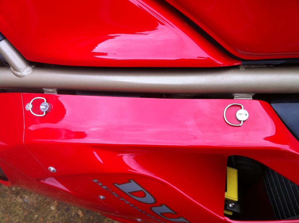

    The tank pad didn't seem to sit right when I came to doing it just resting against the tank. Seems to take a lot of pressure to keep it pressed to the tank so I'm going to leave it off for now.
    The switchgear, still can't get hold of one, can't find them anywhere!
    Here's the pics of the fasteners and a before and after of them fitted. I much prefer them and don't know why it's taken me so long to change them!
    New tyres on, much better :upyeah:

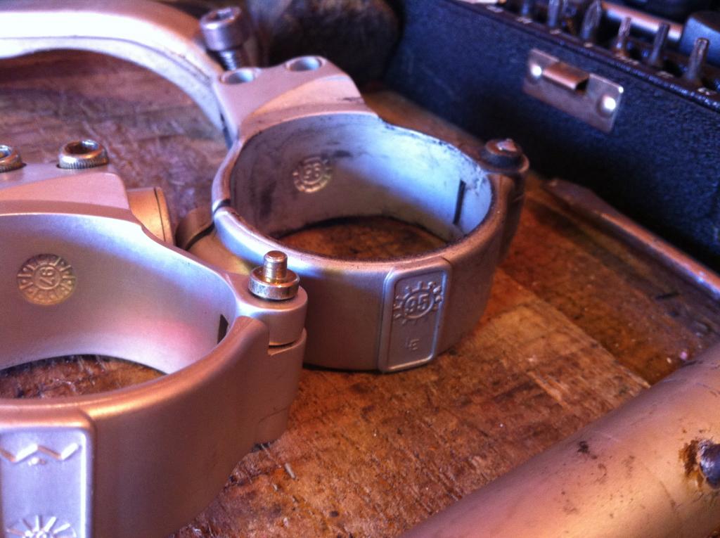

  16. Hi all
    Been a little while since update. I was on the hunt for a monoposto seat unit for some time. Well, I ended up buying two :biggrin: Both OEM and original paint. I prefer the plain red strada unit so I'm selling the red/white on eBay currently :upyeah:

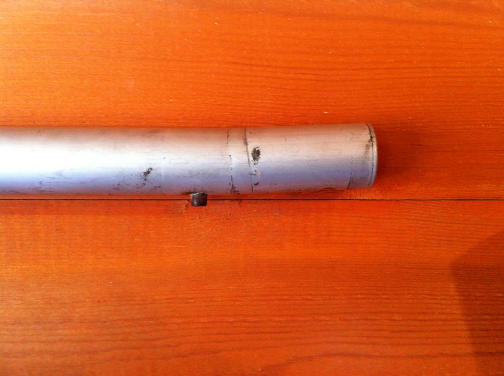

    I also got round to taking the clip on off and checking if it's bent. Well....
    Also, this is the clip that I'm replacing, it's immaculate and with the pin unlike mine that got broken off!
    I also had got hold of a cagiva switch to have a play with. Looks exactly the same except the wiring block was different and would involve stripping both callipers which I didn't fancy doing so it's back on eBay. So still after one.
    I'm still after a top yoke. I fit the new screen/fairing screws also so no holes now!
