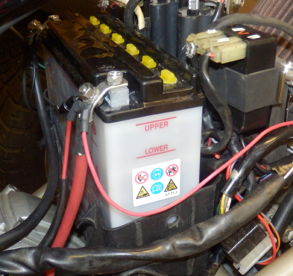

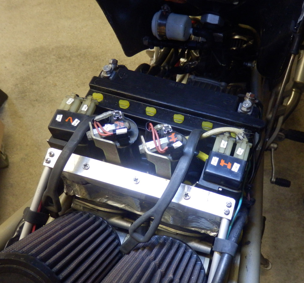

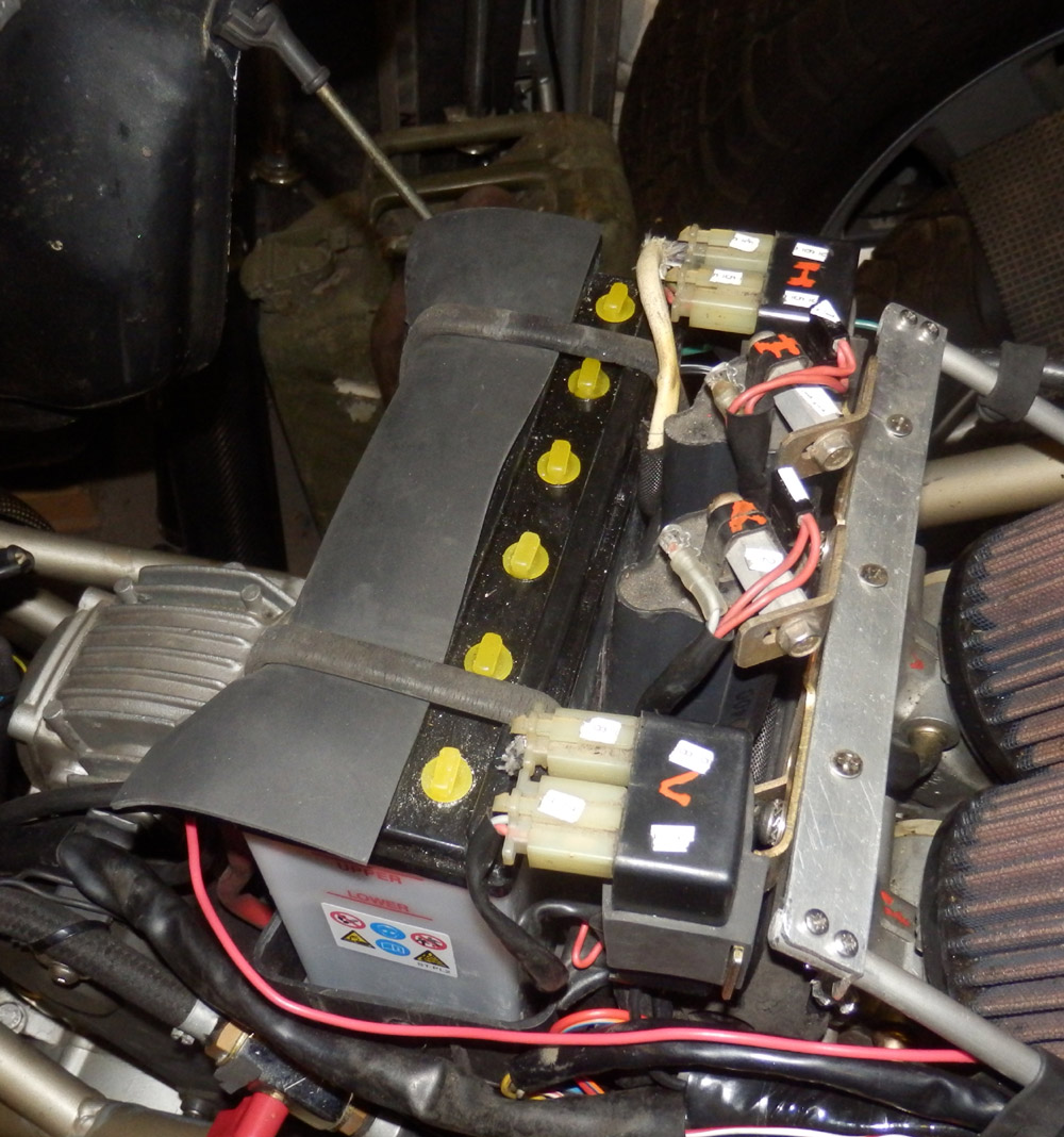

  1. Looking at the images above I'm wondering if I have non standard coils fitted, will have to check them over properly.
    One of the things I can't stand is trying to faff around getting several small ring terminals on a battery at the same time as the main terminal, it's not too bad on the older bikes of course, but anything with newer electronics can struggle with the various systems being powered up and down as you struggle.
    My M900 has been modified in the past, and I've taken it a bit further, so for example the non-standard Reg/Rec I've wired direct to the battery, and I've got a charging lead permanently connected etc.
    Because of this I used long terminals that I could bend over then attach the various other wires to the terminal before connecting to the battery. changing the battery is now a simple job.
    I couldn't find any long enough to go for a single right angle bend, but may make some and Tin them.
    I left a little bit of extra length on the cables so I could cut the ends off and crimp on new if required.
    I currently use a sheet of silicone rubber over the battery underneath the straps, but will also source some boots soon.

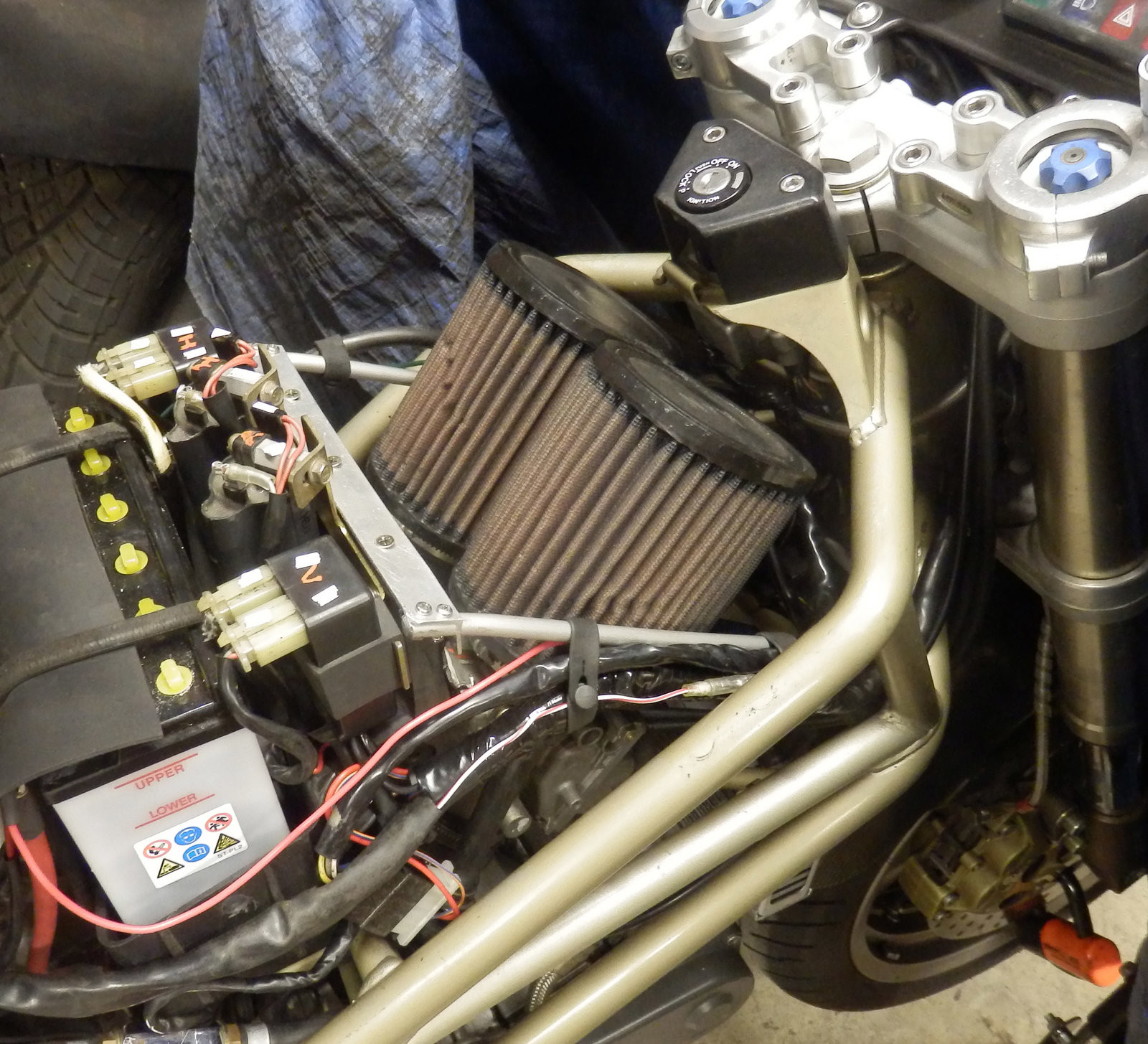

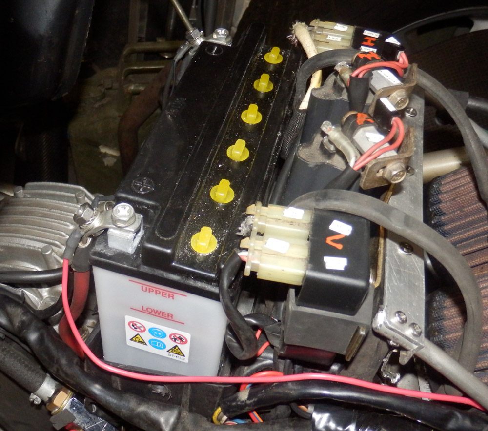

  7. I took this image this evening to show the current sheet of Silicone over the terminals:
    But also took this one to show just how big the K&Ns on it are:
    I've now got the part number off them, DO45A4, so will have a search and see if it even going to be possible to replicate the set up on the SS if I decide to go down that route.
