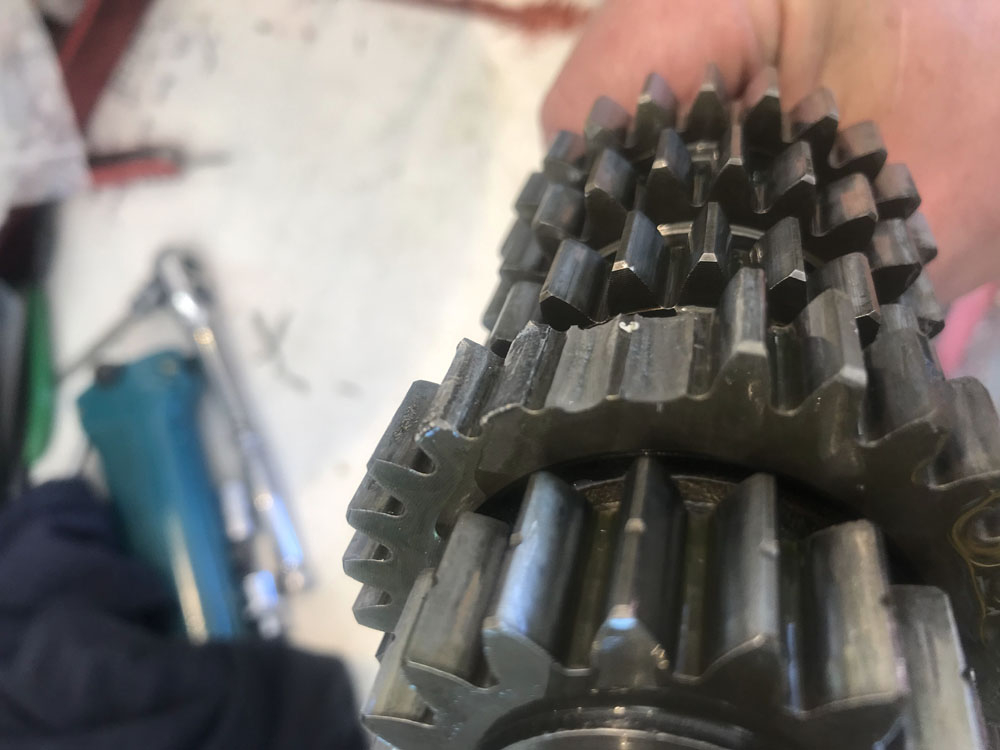

  6. Having just had to replace the gearbox in my M900 due to the 6th gear cog losing 4 teeth, I wouldn't recommend torquing through the gearbox - the torque setting is more than the engine output!
    The cost of a clutch tool is far less than the cost/bother of a knacked gearbox...

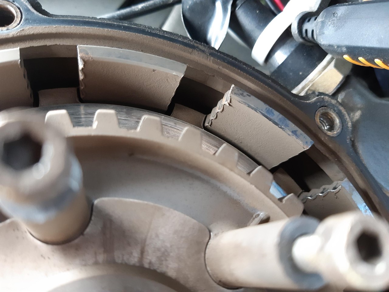

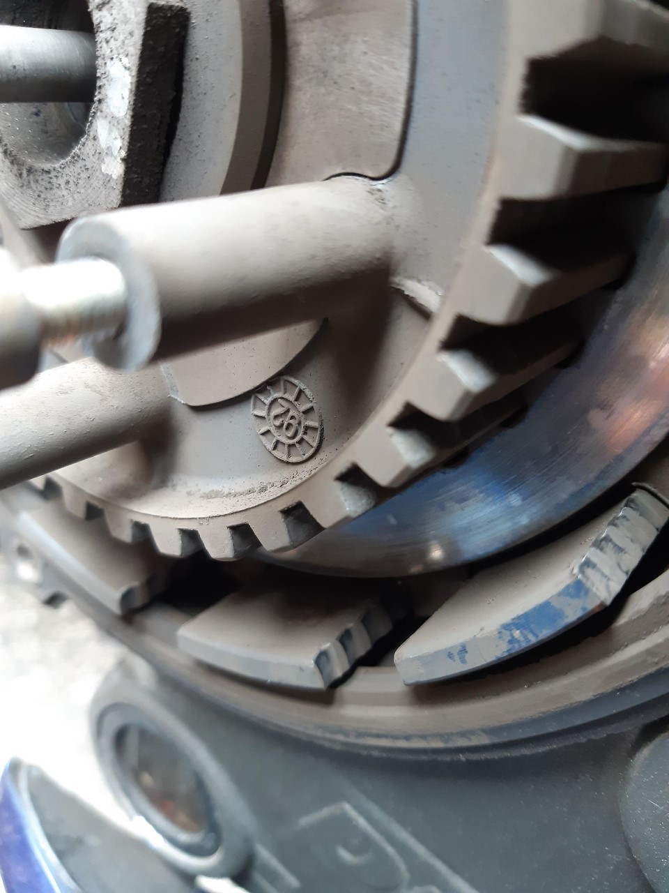

    The clutch on my 2002 748 is way more worn than what is shown in your photos, it is noisy as fuck and rattles away like a goodun BUT, it does not slip, it disengages perfectly well, and I can pull away smoothly without juggling the lever. It's done 25k miles and I expect to get a lot more out of it. Before you spend hundreds of £ on new parts, do you "really" need to replace it, my guess is probably not but I do of course accept that I have no 1st hand knowledge of the bike so there may be reasons. All I'm saying is don't jump in too quickly.
  9. Hughdg - changing gear and 'fast' accelerating whilst already moving was no problem, pulling away from standstill is the issue I have when the bike tries to shake itself to bits which I'm guessing is clutch slip
  10. Some years back my 916 (when it still had the steel basket) had almost 3mm of play between the basket and tangs, it was without a doubt the noisiest clutch I'd ever heard yet it worked perfectly, I changed it because it was too much to bear but it shows that the wear limit that Ducati give is a tad unnecessary.
    As for putting 186nm through the gearbox, it might take it (do you feel lucky?) but I wouldn't advise it - my Monster gearbox broke in normal use and it's been a real PITA to fix it, it would have cost me a fortune if I was paying someone to do it.

  11. If fast acceleration is no problem you haven't got clutch slip. I would give everything a thorough clean first, check that the steel plates are all flat and make sure the small bearing in the cover plate is in good condition.

  13. On my Monster when the 6th gear was broken (as per the above pic) it was grating/rattling in every gear and would jam/release whilst pulling away in 1st - the 6th gear cogs are constantly rotating/meshed but only transfer drive when the selector is engaged.
    Though I'd highly recommend examining/replacing the clutch before getting into the gears...
  14. Chain & sprockets appear fine but I haven't ruled out a transmission issue, for the reasons you state. Having examined clutch friction plates more closely, there really isn't much left of the pads (almost down to the steel backing in parts) and I'm hoping I've just been lucky with the clutch holding in the higher gears but unable to manage in first.
  15. Replacement clutch on order (plus 32mm socket and bigger torque wrench!)
