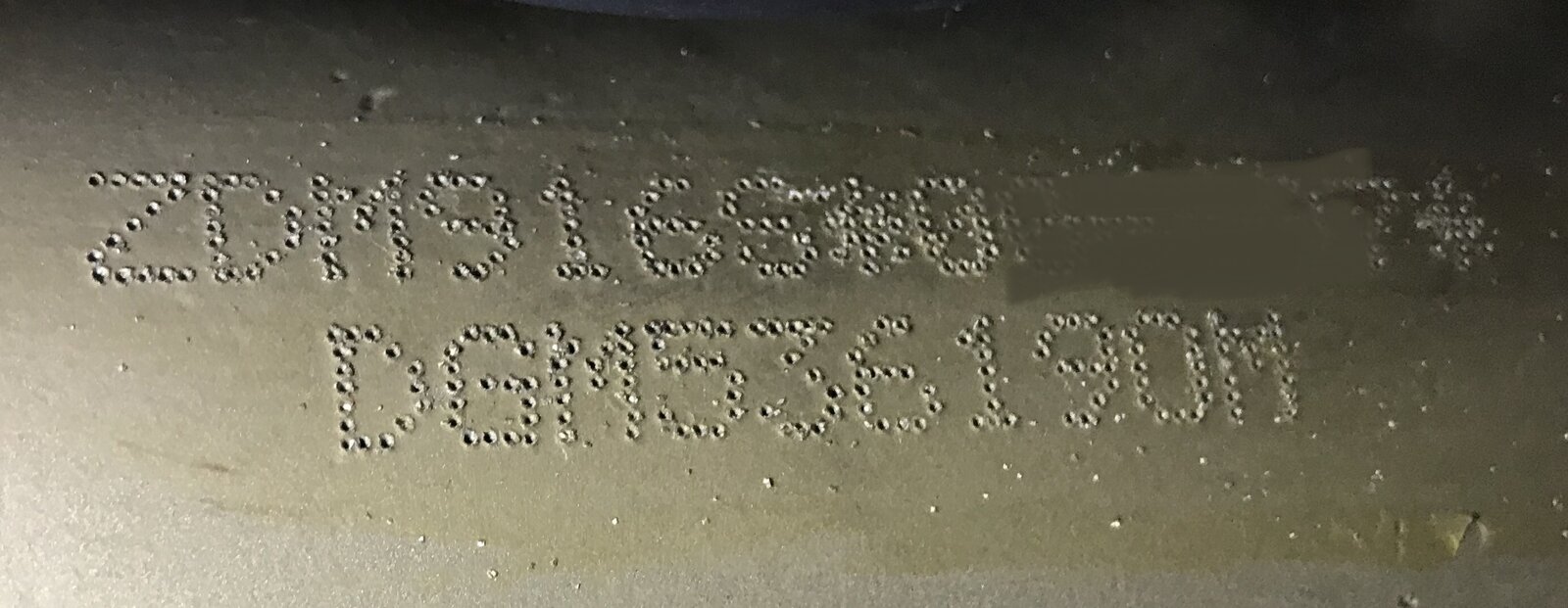

  3. Further advice sought. I’ve been offered this as a 916 frame to import. Is this a correct VIN? I can’t input it into Ducati’s recall URL, which is where I get information from.
  4. This VIN doesn’t look legit to me at all.

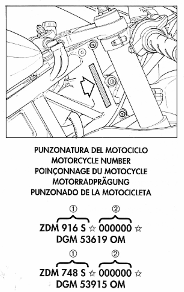

  5. It actually looks manually stamped. Spaces between digits are uneven.
    This is genuine 1996, for example : C381DBE3-4894-4F96-B185-8EA793B63A93.jpeg
  6. Yes. That’s what I was expecting.
  7. Defo manually stamped, on some numbers or letters you can see a rebound stamp where the punch has hit twice. Z and the 3 noticable.

  9. I couldn’t enter this VIN into Ducati’s online recal URL, as it isn’t in the correct format.
  10. I believe the correct format is as per @Guillaume69 ’s post above, ZDM916S with an * either side of the 6 digit serial number.
    It looks very suspect to me.
    ps, I think Ducati’s recall checker by VIN only works for the more modern 17 digit VINs
