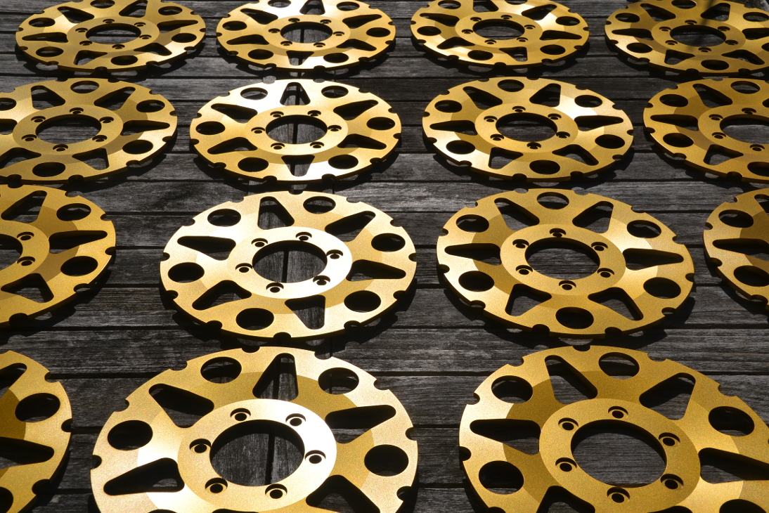

  7. Well as you can see it took me a very long time! I have just completed another batch of replic Brembo full floating brake carriers. I said I was never going to do any more but we had some 7075-T6 and received a couple of orders so we used up the last of the billet and did a few extra.
    These are hard anodised and made from 7075-T6 alloy so much tougher and longer lasting than the soft originals which are no longer available from Brembo. There are plenty of good reviews on us and these carriers in this forum if you need to check out the quality of what we do.
    The price on these is $345 New Zealand dollars each.
    They will fit most Ducatis fitted with 6 bolt Brembo cast iron discs, including:
    750SS 900SS
    Monster M750/M900, S4,
    851/888, 748/916/955/996/996SPS/R & 998 Superbikes
    They will also fit some models of Laverda, Moto Guzzi and Aprilias including:
    Laverda 668, 750S & 750 Formula,
    Aprilia RSV1000, SL1000 and most late model Bimota's.
