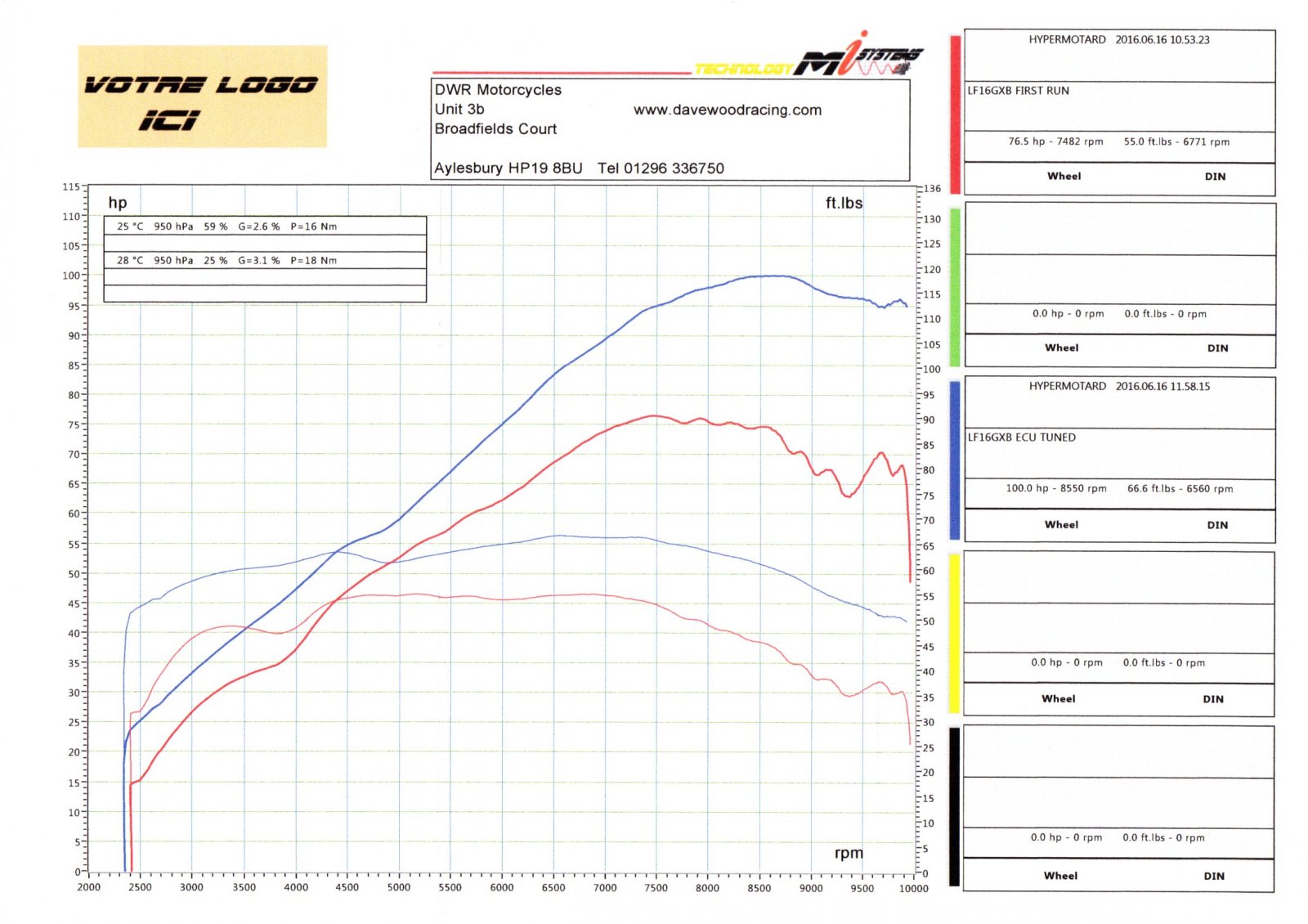

  3. UPDATE
    Bike has been there all day and will be collected tomorrow
    I now know more about the process
    The guys in Germany and Italy provides the code for allowing access into the ECU. Then Dave at DW Racing will personally write a new map that seeks to resolve all the running issues at low speed. Although i will find out more tomorrow, the process allows him to keep the exhaust flap open and the oxygen sensor disabled to allow better air flow
    More to follow tomorrow .......
  4. Welcome to low speed crawling through traffic!
    Sent from my SM-N9005 using Tapatalk
  5. Just had the remap done and so far the bike seems amazing. I don't confess to fully understand the data as attached, img20160616_17541958.jpg but depending on where you take the BHP measurement from, it seems i have either found 26 BHP or gained same !
    Either way it feels so much better, low speed lumpyness has almost disappeared and he thinks the fuel consumption should improve massively.
    They now have a map for a 939 and they are a father and son team and such lovely guys - DWP racing in Aylesbury and all for £300 plus VAT. Any questions just ask
