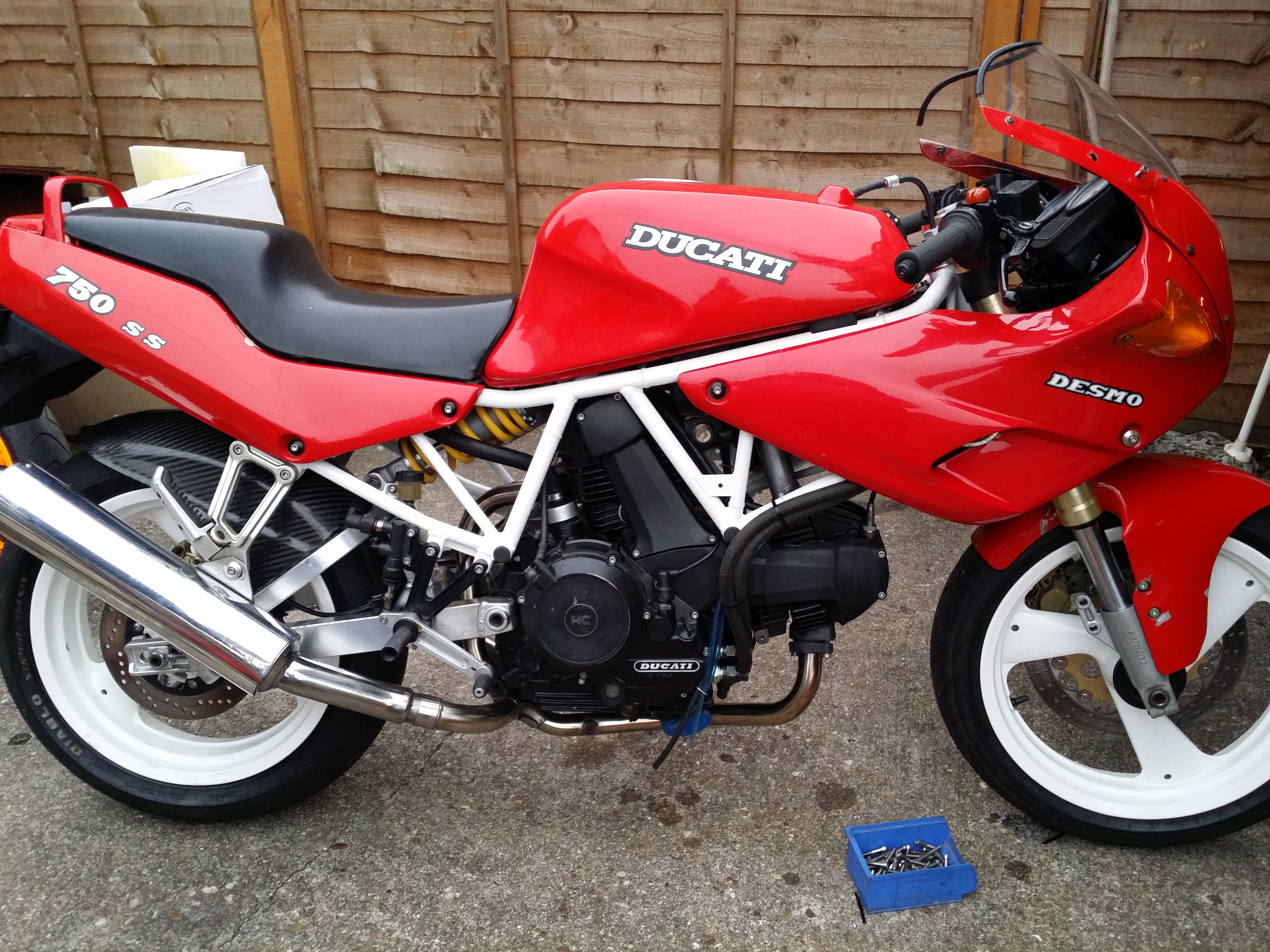

  4. Mine was in the same condition,i rescued it from a damp garage in glasgow where it stood for 12 years....a bit of powder coat and paint on the engine etc,i left the paint which is scabby round the edge but ok,just get rid of the rust,stainless bolts and a bit of zinc,it stands me to £900 ...rescue it. 20140711_211203.jpg
  5. Those wheels look really shit without the extra disc...
    Totally agree though, a good clean can totally change a bike.
  6. I quite like the 1 disc effect!
    Mine stands me in for about £1300, that includes changing the exhaust. Strange all three bikes have 50,000 miles on them(mine, rcv4 and yours)

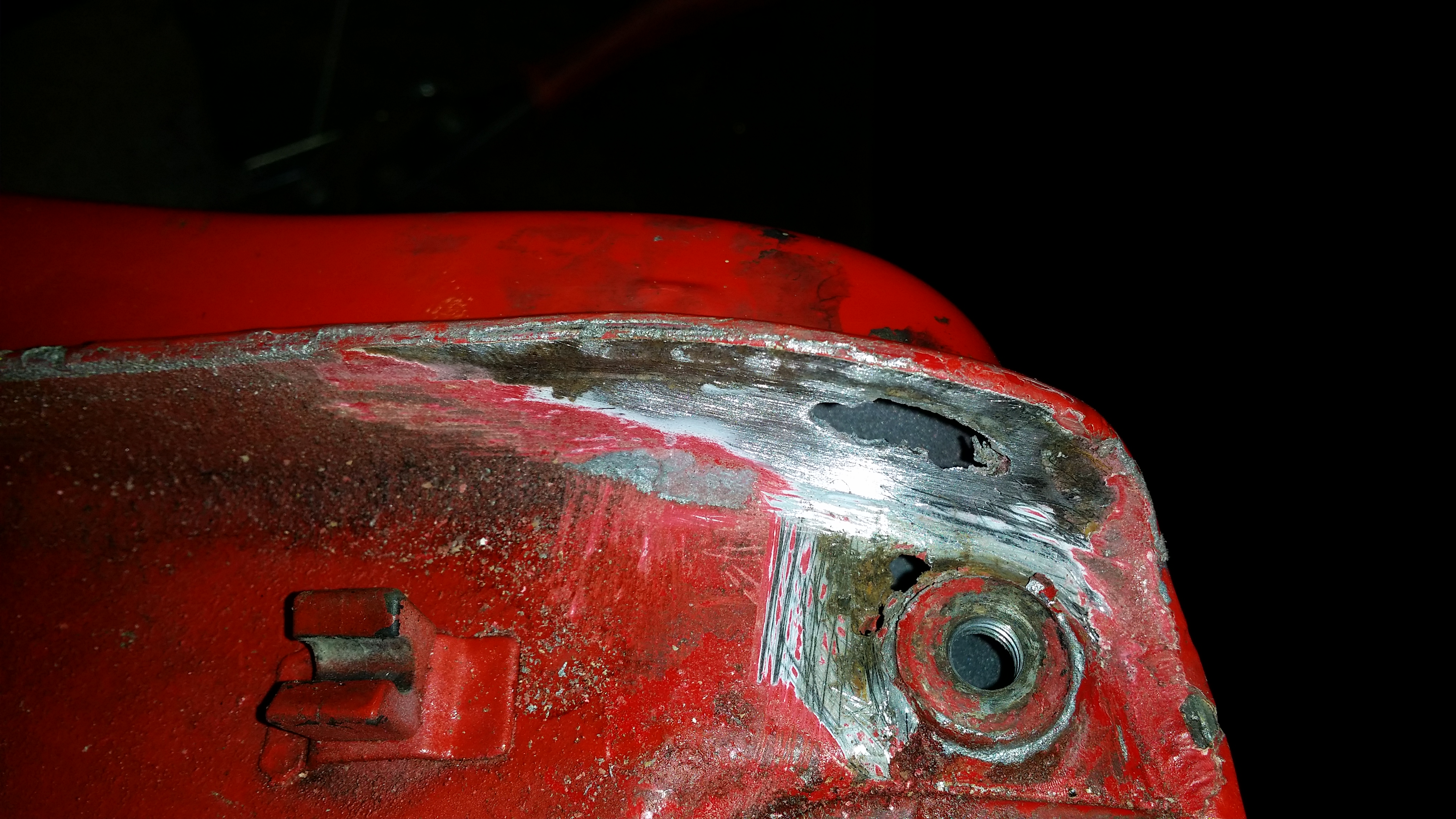

  14. Fibre glass it, that's what I've done with mine. :upyeah:
  15. Might not last as long as brazing, but at least it won't blow up.....................(as long as you don't mix up too much resin).
