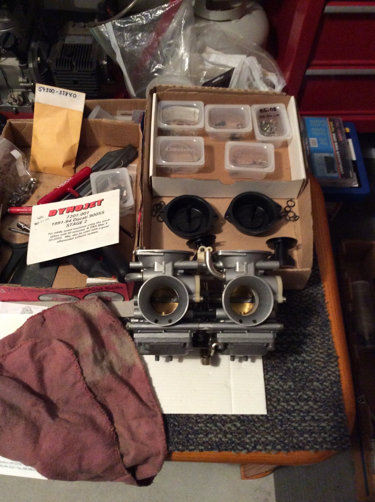

  2. Hello - I need some advice on two items related to my '91 900SS restoration project:
    1) Do the CV diaphragms "shrink" when exposed to the air outside of their internal chamber? I ask because it appears as though mine have shrunk at the large top end where they form the o-ring gasket seal up where the cap seats to the carb body. Is there some type of rubber lube that I need to "condition" them with so they are more pliable or do I need to replace them (they have no pin holes or cracks)?
    2) Can someone provide me with a PDF manual for these 38MM Mikunis so I make sure I am reassembling everything correctly? I have searched the Internet and cannot locate one but they must exist. I have found low res pages/images that are of poor quality and hard to read especially the arrangement of the washers on the needle/slide/spring and the proper position of the diaphragm white plastic retaining ring (above or below the slide?).
    I have the bottom end of the carbs completely together with all new o-rings, DynoJet Stage 2 kit and floats each adjusted to 14MM but need some PDFs to help on the upper slide/needle/diaphragm assembly.

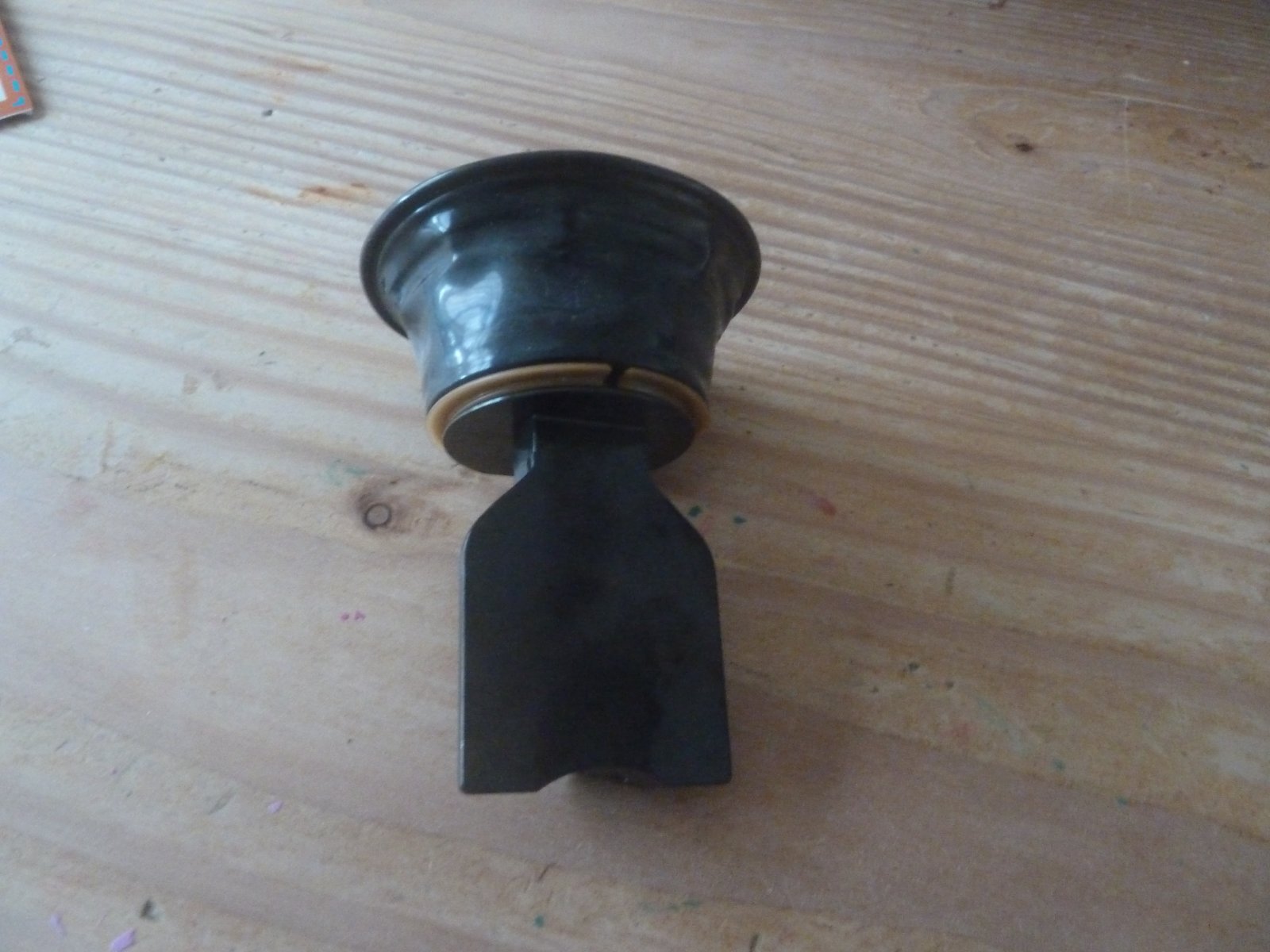

  7. MacBulldog,
    The part diagrame looks to be from another bike, presume the 400. I have a similar parts manual for your year and size of bike. "Start new a conversation" and I will try to send it to you if the file is not too big.
    The white split ring goes underneath the diaphragm on the slide side.
    PS These are the same carbs as on Yamaha TDM/TRX850 if you have a local dealer.
    Cheers Gaz

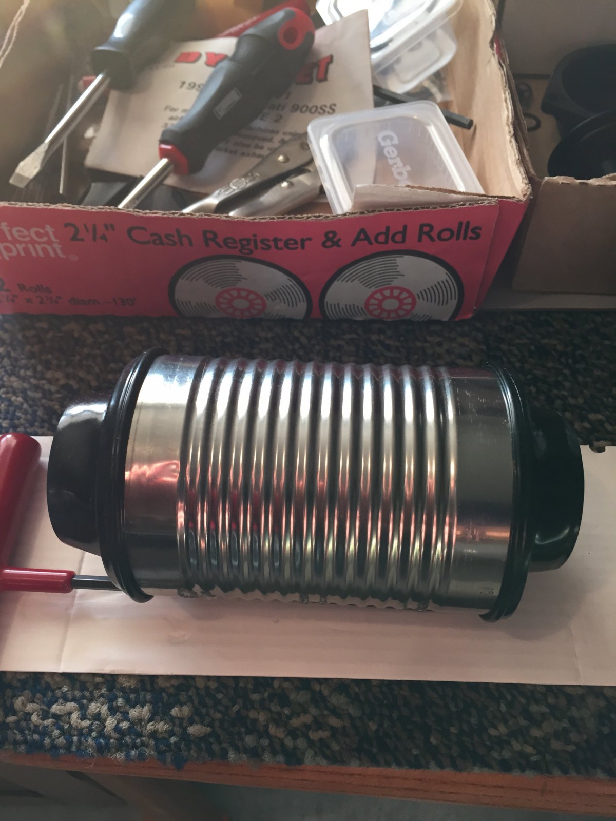

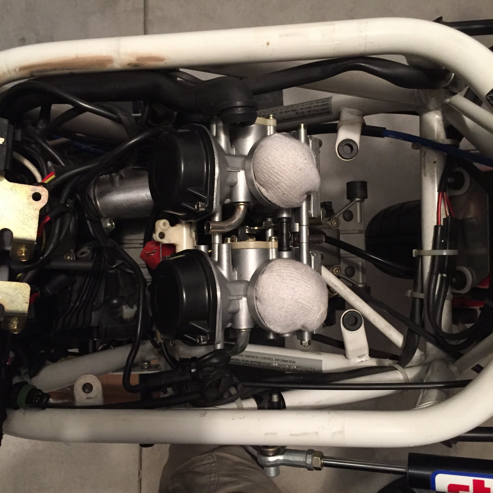

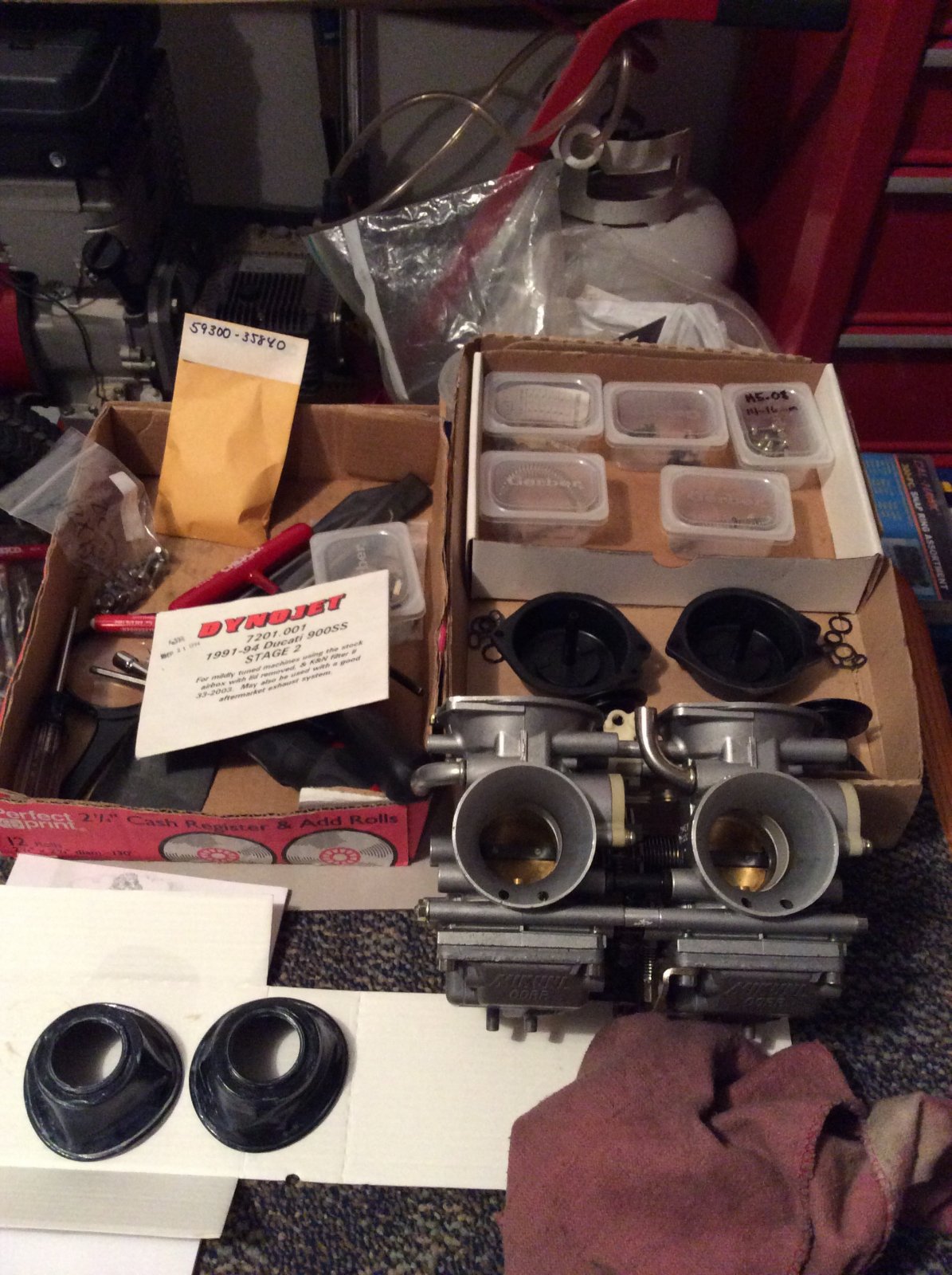

  9. Great photo of the diaphragm and slide/retainer - exactly where I initially placed it before realizing the diaphragm had shrunk. I lubed the diaphragm with some white lithium grease then let them set for an hour and whipped them down to remove the residue. Then I found an empty container with ends the same size as the groove in the carb body that the diaphragm's o-ring lip fits in and have them stretched to fit. I will upload a pic later once I get back home. Hope this work-around restores the diaphragms shape and I will report back later my results. Thanks for the photo Gaz!

  13. Understood, and unfortunately that seems to be the rule rather than the exception with these Makuni carbed Duc's. There is a bike performance shop near me with a dyno and maybe once I get it running I will take to them to do the fine tuning. I have attached two photos 1) one showing the Stage 2 needles, springs, plastic spacers and the 3 washers. 2) my work-around for keeping the diaphragms stretched to their big ends until I get them reinstalled (can ends are exact match of the diaphragms big end o-rings.

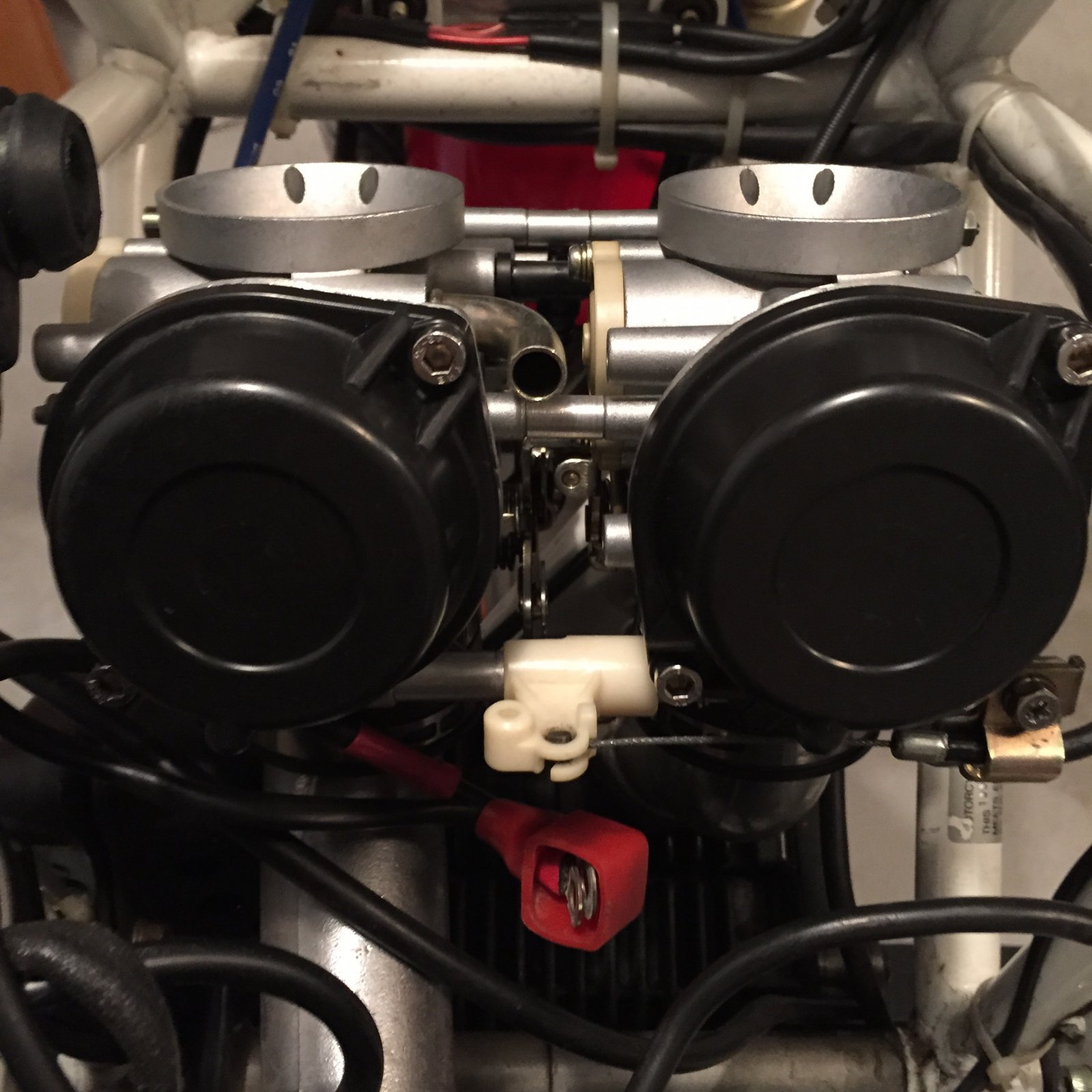

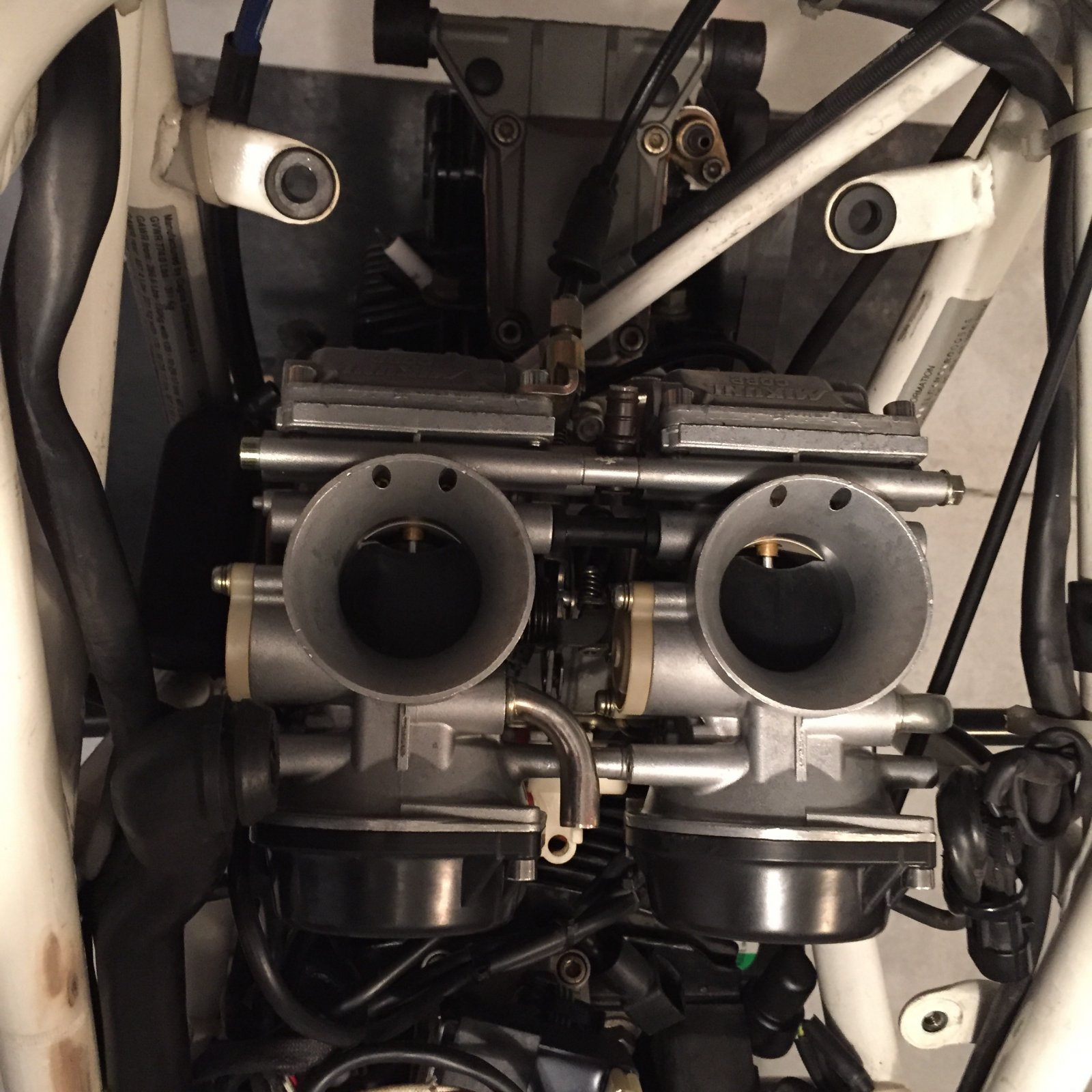

  16. Current Udate on my Progress...

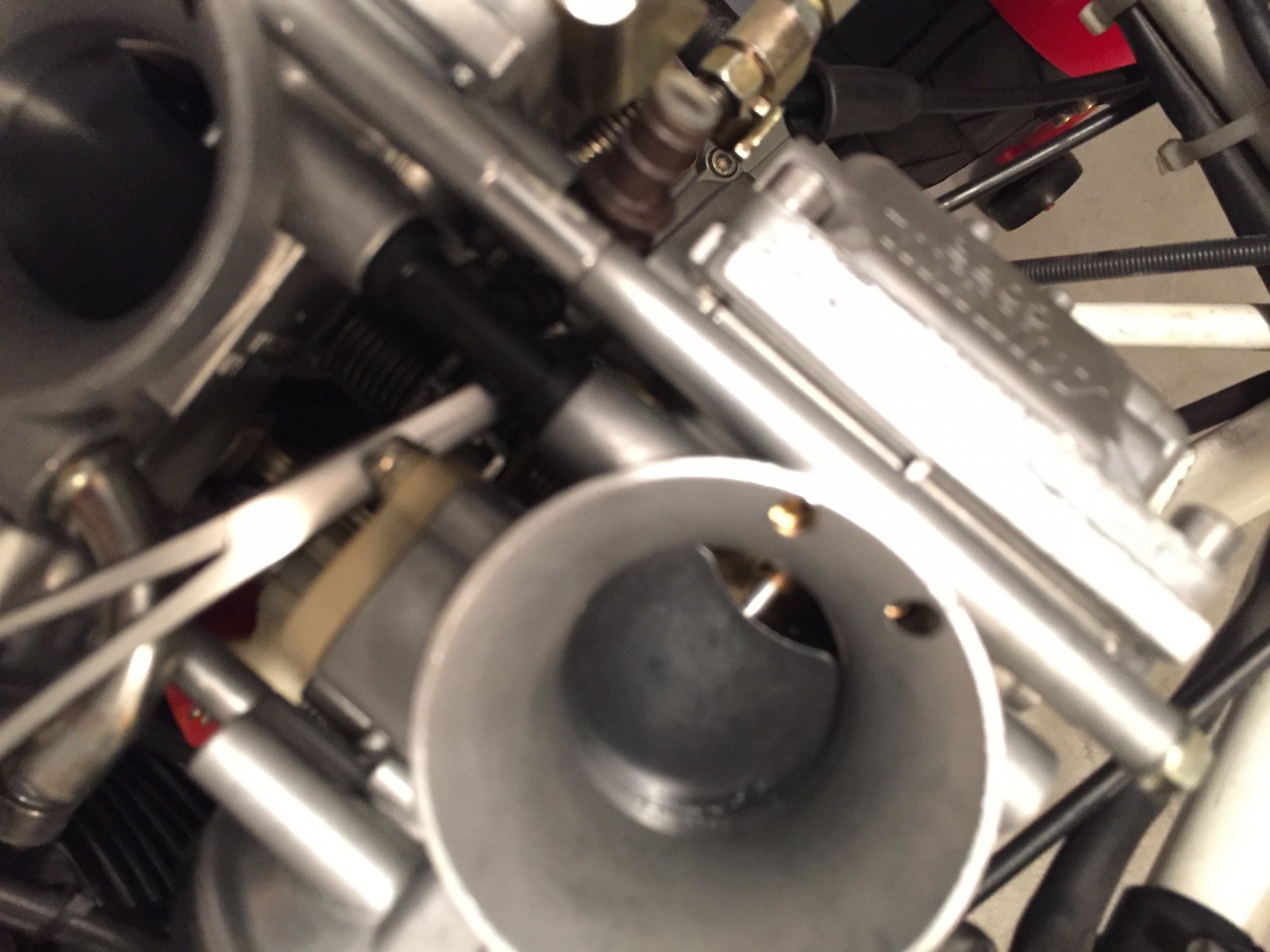

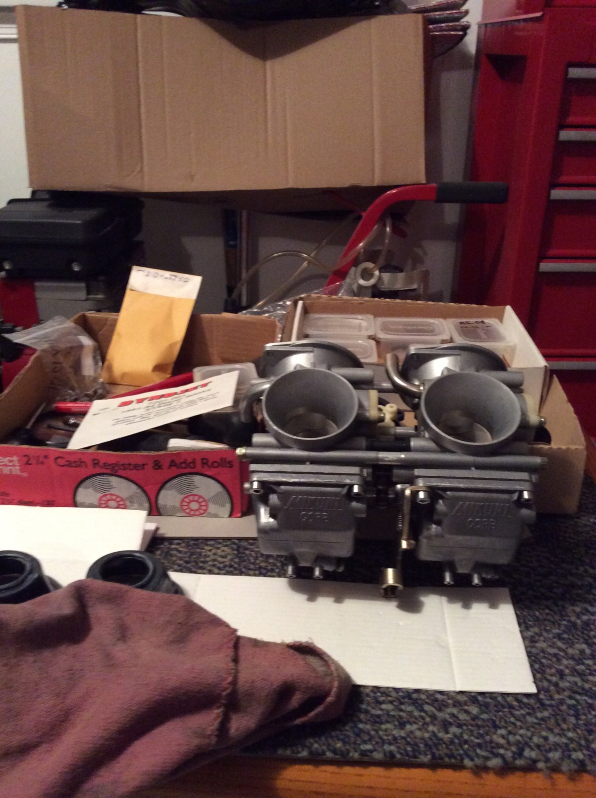

    I have completed the carb rebuild and have them temporarily installed in the Duc project bike (sure hope these old carbs function properly - keeping my fingers crossed :)! I decided to remove the DJ-150 jets and drop down to the DJ-144 to hopefully tone down the over richness of the larger jets that plagued this Duc's performance back in its earlier life. The use of a a pair of hemostat set of fish-hook removal pliers sourced at the local Dick's Sporting Goods ($9.98 U.S.) aided my efforts greatly on the installation of the twist-grip cables (I did not have to remove the the twist-grip or the upper end of the cables).
    This week (time permitting) I will begin the flushing of the brake and clutch limes and master cylinders and hopefully start the installation of the timing/cam belts; then install the new fuel filter and all new fuel lines and other aged and brittle rubber hoses. I have uploaded some pics of the carbs sitting on the manifolds to update my main newbie original project post.
    Oh, almost forgot the lube and stretching of the rubber diaphragms on the ends of the food can did the trick and they went right into place with the o-ring matching its groove/seat and my inspection found no apparent pinholes or cracks (manual test of vacuum function seems normal)!

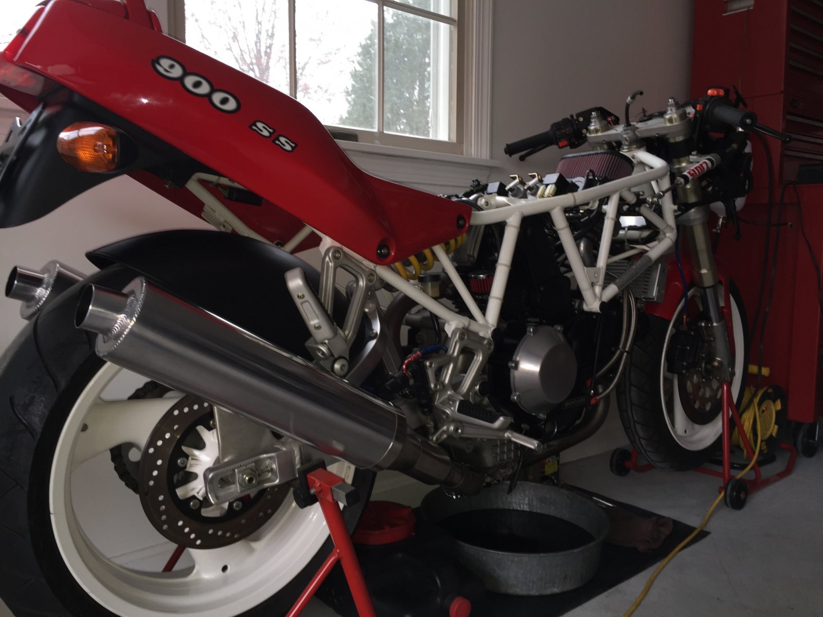

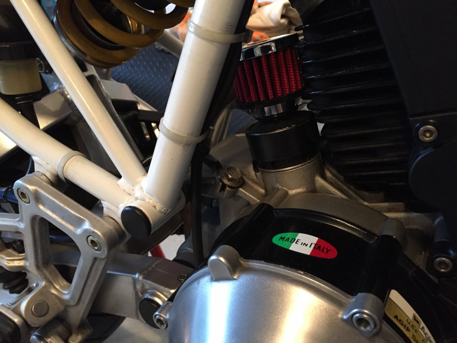

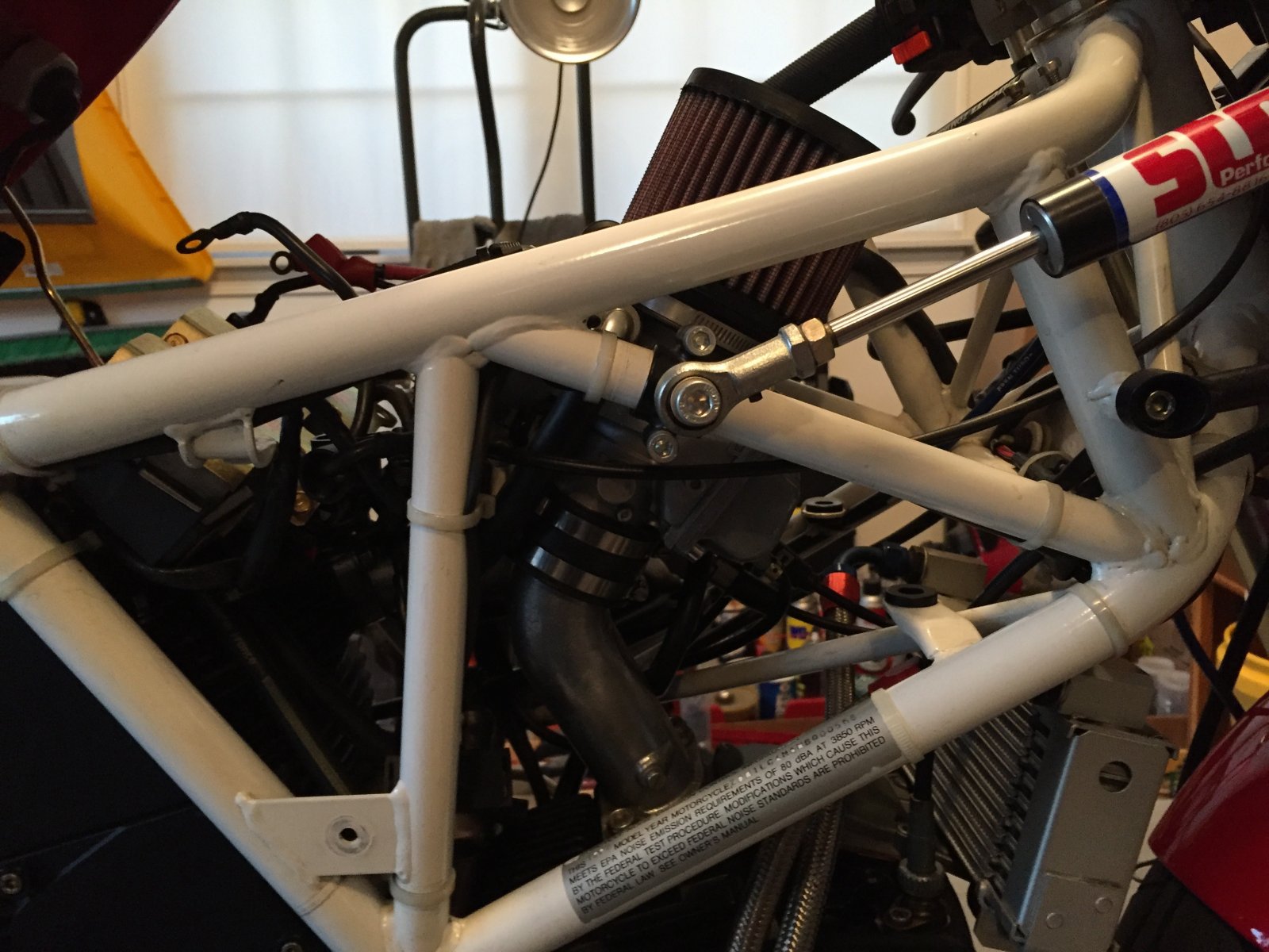

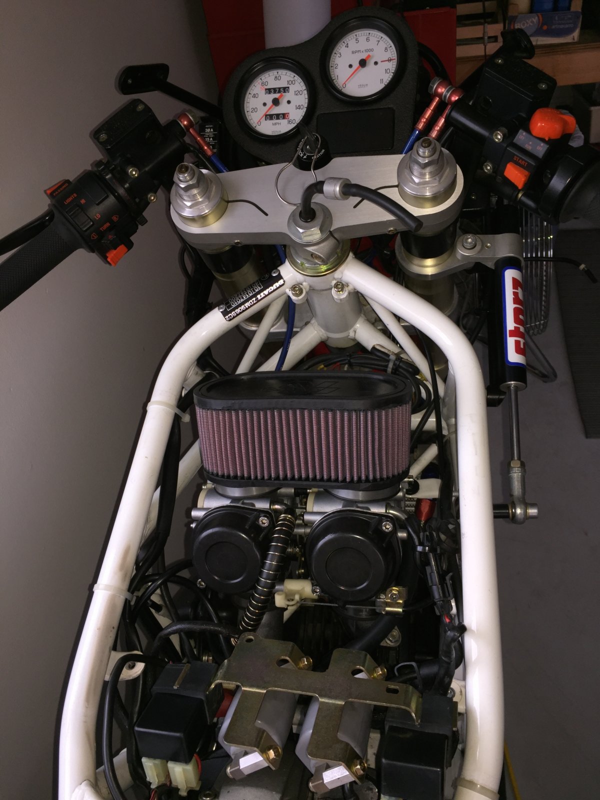

  18. I have finally gotten the old '91 Ducati 900SS running. I have completely rebuilt the OEM Mikuni carbs; replaced the timing belts; flushed the brake and clutch lines (DOT 5); started and run to full operating temp and then flushed and replaced the oil (20W50) and added a K&N 153 oil filter; removed the OEM open airbox/K&N and replaced the OEM box with K&N RU-2970 twin-pod filter unit; eliminated the redundant fresh air/charcoal canisters/tubes and replaced this set-up with a 3/4" K&N-62-1360 mini filter directlyon the crankcase PVC valve; set-up an external fuel cell to test the engine before installing the gas tank, new filter and fuel lines (great for engine/carb tuning/testing).
    So far so good on the engine and carbs but now I have noticed that I have a fork tube seeping fork oil and will need to make plans of what to do to rebuild the forks - suggestions welcomed.
    I need to also look into replacing both tires. Even though the rubber has not touched the ground (always up on wheel stands) they are now over 15 yrs old - so, tire suggestions also welcomed (current: Michelin 120 Front 180 Rear).
    I am also working with a friend to fabricate a new battery box/coil mounting unit and like what FourRings has done with his 900SS Carby - suggestions also welcomed.
    My goal is to hopefully have this old beast fully roadworthy by this Spring (funds permitted).
