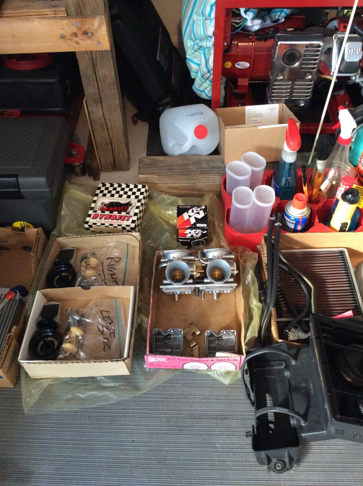

  1. Okay, is this template is off by 1MM? Of so do I need to reconfigure the gauge to be 12MM or 14MM or do I need to construct and have both on hand just in case I need to raise or lower the fuel level to smooth out the fuel delivery at all engine speeds?
  2. Bloody hell! You have gotta be the tidiest person and most organised ever? Can you pop round and sort out my sock draw ASAP please
  3. Great great looking Ducati chap - put up some pics when it's all done mate
  4. Never could count...

  6. Hey 749ducaticonvert - thanks and lol on my "tidy" side! I am a decent wrench but I really have to be a bit finicky (tidy) about taking things apart and putting them back together again besides my memory is just not as good as it once was.
    I learned early on from my uncle (a military aircraft mechanic/engineer) to label everything. Now I shoot project pics each step along the way and read everything I can get my hands on plus join forums like this great group for the hands on or real world experience of true rider-wrenches.
    Oh, I will upload my progress and any questions that come up and then finished project - hopefully Spring 2016 if all goes well!
