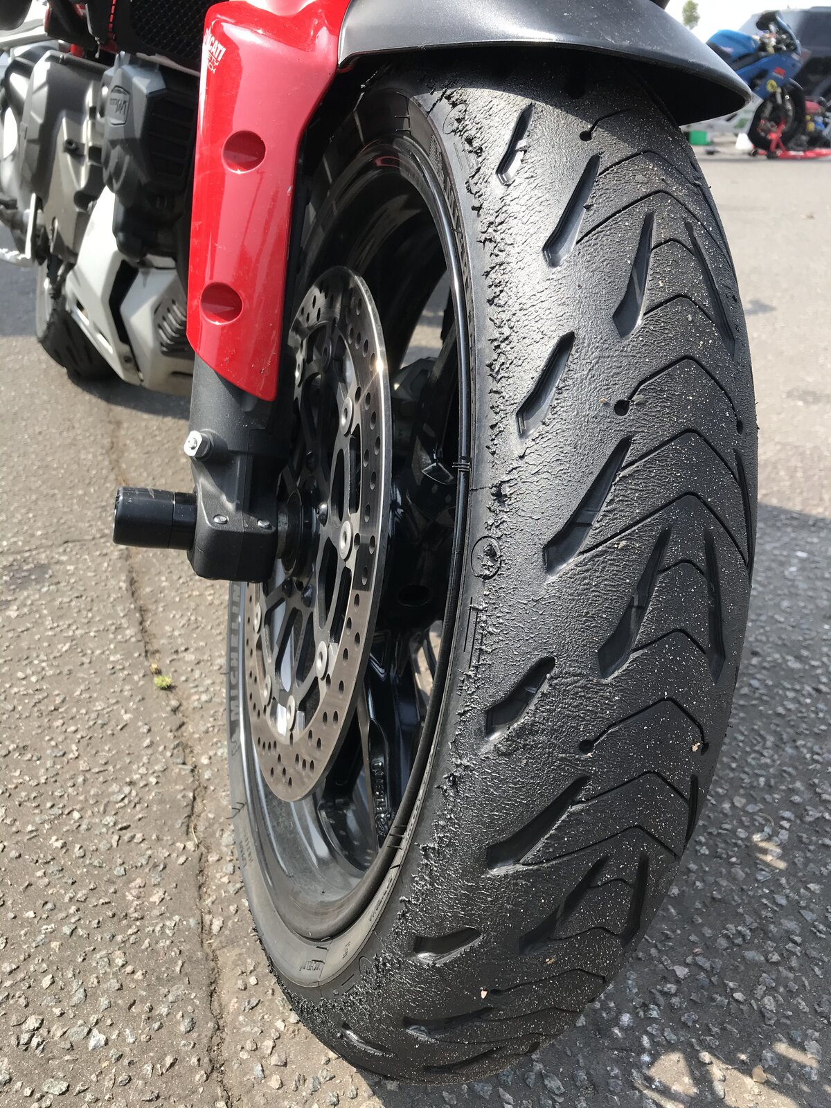

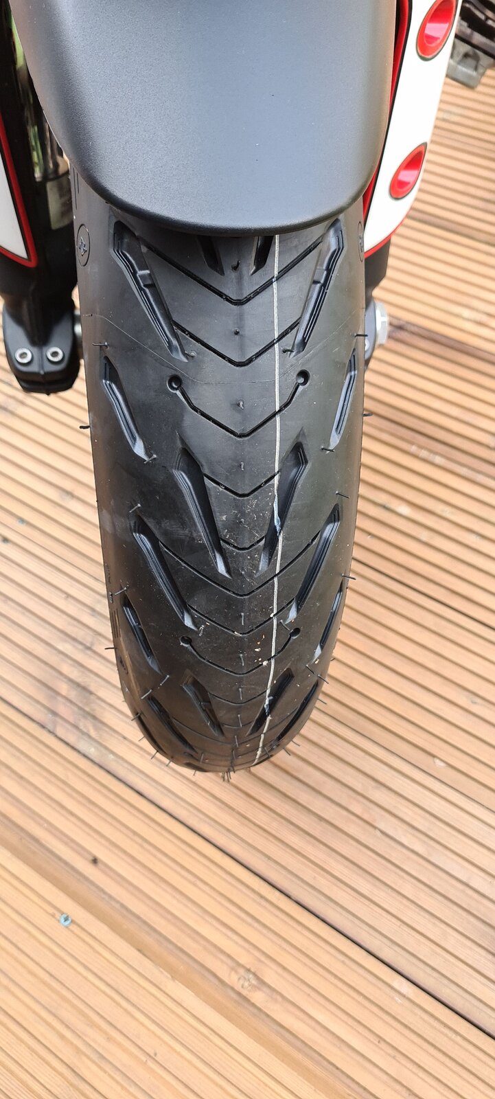

  2. At work so just looked at a pic of my bike on my phone and my front tyre has the arrows pointing upwards.

  5. Rich, do you mean the rotation arrow or the tyre 'arrows'? If the former, then your tyre is fitted the wrong way around.......
  6. Installing a tire backwards is absolutely unacceptable regardless of how it was previously installed. In fact, it may be dangerous.
    I can't see why they wouldn’t correct the error as it's not an expensive fix.
    If they don't however, threaten them with posting the name of the dealer and the employee that said that one every forum you can think of. Just make sure you can prove your allegation as they may sue for slander.

  8. It's all good guys, the garage corrected their mistake the next day, im not makeing any excuse for them but the predominantly do car tyres and and only charge 5£ a wheel (Loose) but in future I will always double check before I leave
  9. Great result, your point about taking front wheel in/"loose" is a good one, because if wheel spokes not distinctive then i'm sure a few fitters would fall back on trusting previous fitment if customer not around.
