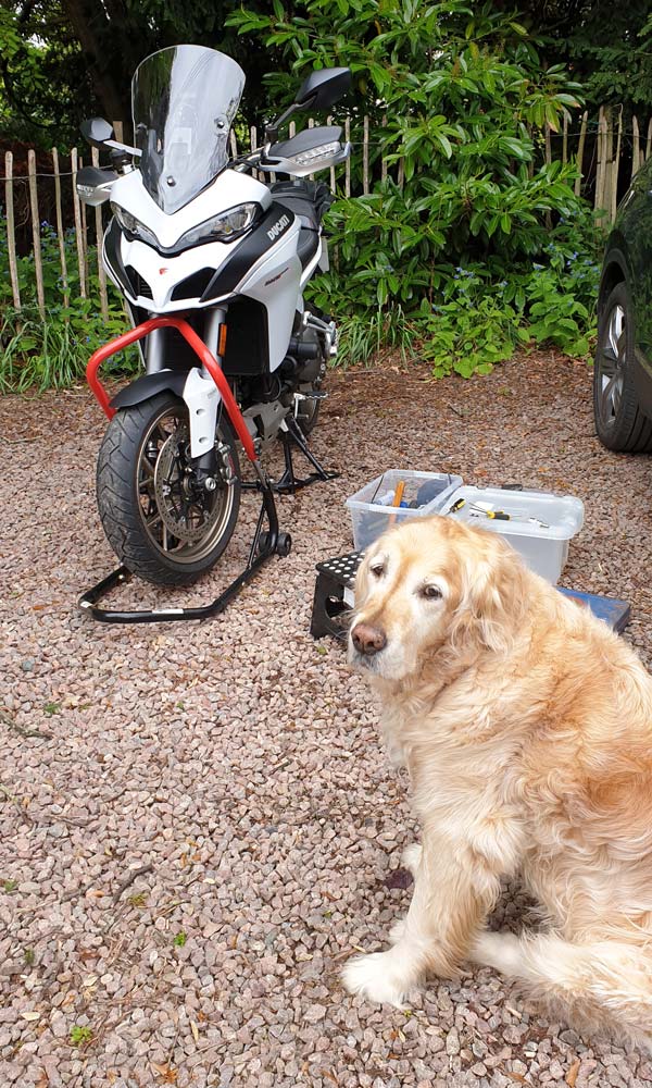

  1. Not had any need to remove front wheel yet, any problems when removing it ?

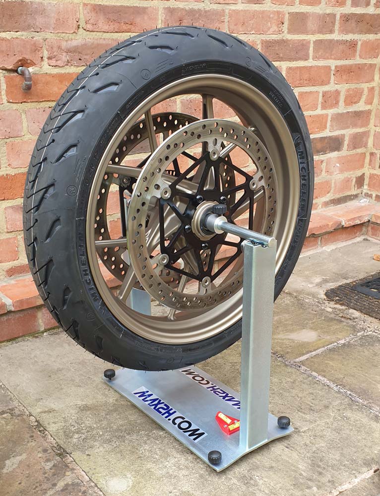

  2. The callipers need to come off so, ergo, does the Roadlok. Other than that there were no real issues other than supporting the front wheel off the ground. For that I have a stand that engages with the hole though the headstock, works great requiring the removal of the plastic panel secured by three screws.
    Changing my own tyres means I get to balance the wheels and choose which side the weights go on :grinning:
