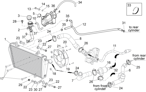

    Most of the Aprilia thermostats open at 75ºC, the same as the Ducati ones but the one for the 2008 to 2010 Dorsoduro 750 opens at 85ºC. It looks like it could be a replacement for that on the MTS. I will need to find out the dimensions.
    Item 16 in this pic., it costs £46.
  2. So a complete unit, housing plus thermostat, by the look of it.
    £46.00 isn't a huge price to pay for improved economy and power...
    Looks like I might be luckier with the 999 item. As you say, it seems to be a conventional thermostat inside a simple housing, so could be relatively cheap to replace if I'm lucky
