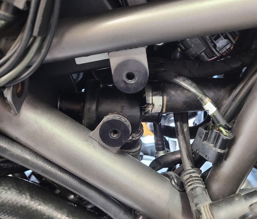

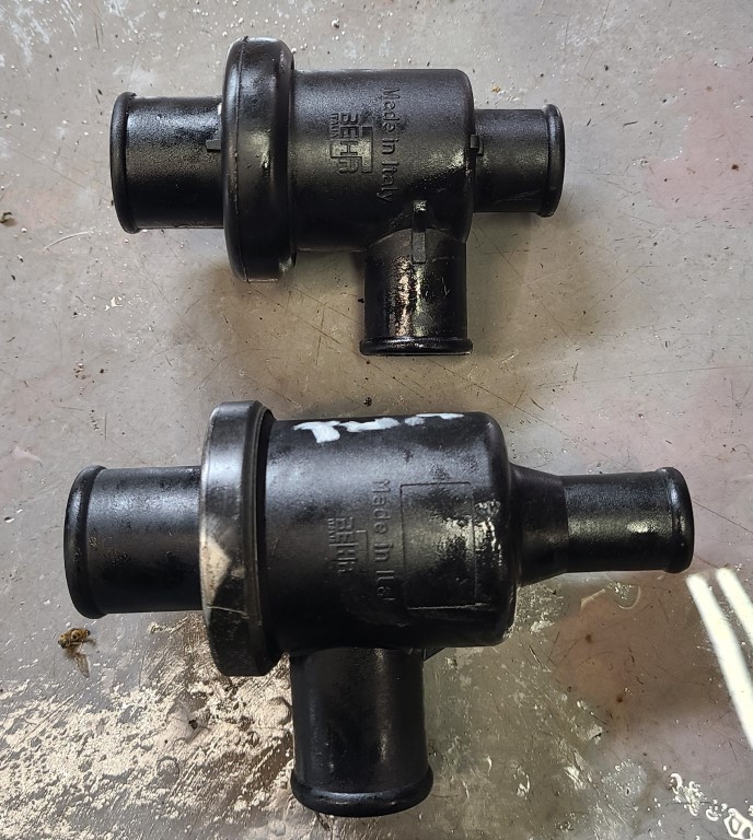

  17. Decided to follow in Fricorico's footsteps and with a coolant change due, decided to fit the Aprilia 834232 thermostat.
    As described very tricky to fit with the change in pipe diameters, but can confirm it's achievable, just needing the new pipe for the rear cylinder (19mm ID, cut slightly shorter than original to 140mm long to accommodate the longer stat).
    Parts used ...
    Ebay for the Aprilia Dorsoduro thermostat Part number 834232 and for the 19mm ID tubing
    Prior to installation, my 2013 Multi would run at 60oC, unless stuck in traffic.
    Ticking over in the garage, the new stat appears to be opening at 80oC, holding at around that temp until the radiator heats up, then gradually rises to just over 100oC when the fans kick in and temp drops.
    Took for a test run today at 8oC outdoor temp ... in town, appears the stat is working and maintaining 80-82oC. This dropped on the road to between 70 and 80 - I guess due to the oil cooler working and the cold air.
    No black on the exhaust tip on return, so looks to be running leaner.
    Will update with any change in mpg once the weather improves.
    Overall - a worthy mod IMO
    Pic of Original (smaller stat above the replacement)
    And the coil removed to gain access to the stat behind
