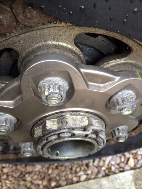

    Not the best pic but you can see how bad the chain is already
  10. Fek that is bad! Must be salty as hell where you are!
  11. I'm I heysham on th coast in north west but still don't think it should be that bad at 6 months old and 900 miles and after being treated with acf50. Very disappointed
  12. That is bad, how old is the bike?
    Never seen one as rough as that, looks like you've just pulled it out of the sea!
  13. never ever ride with salt on roads. never. ever.
    unless you have too. Then you must hose it down immediately. Even then it'll still be bad.
    I learnt my lesson on my Katana and thus used a shitter to commute on afterwards ever since. Never ride a ducati in salt. Anything with any hint of magnesium will dissolve before your own eyeballs. I will not ride until March. But then I walk to work.
  14. As above 6 months old and 900 miles. Feel like taking it back to the dealer
  15. Jesus christ mate! Have you bothered with ANY wax/lube at all this year? I've never seen anything that bad. As for the nuts and stuff, ACF 50 would have stopped that. Give em a good wire brush clean and coat in ACF 50.
  16. It is poor for 900 miles, but it looks encrusted in a a rusty, salty mess!
    Not sure if the dealer would do much, I'd get the nuts cleaned up, perhaps even replated.
  17. Guys as said earlier in thread the bike was treated to acf50 in first week and less than 100 miles. I've lubed the chain several times and was / should have been done during the 600 mile service which was in October I think. I really shouldn't have to re plate nuts on a bik this new and expensive. My old zx6r which doesn't get washed and hasn't had chain lubed at all is pretty much fine
  18. Very odd then, have you washed it since? What stuff do you use when you wash?
    Without being brutal mate, but I can't see it being an issue with the bike, I'm running the standard chain on my 2011 which is now over 8k in miles and it's still pretty spanking new.
    I noticed your sprocket is pretty much spotless, which is incredible considering the current weather. Are you washing the chain within your normal wash? If so, what are you using?
    Stuff like SDOC 100 is VERY aggressive. Which is a spray on, leave 20 mins, spray off jobby... Might be that?
  19. I agree with you, and I wouldn't be happy with it either, but I can just imagine what the dealer is gonna say....
  20. Yea, sadly the dealer will not accept any responsibility for this, it's a problem caused by weather and user maintenance.
