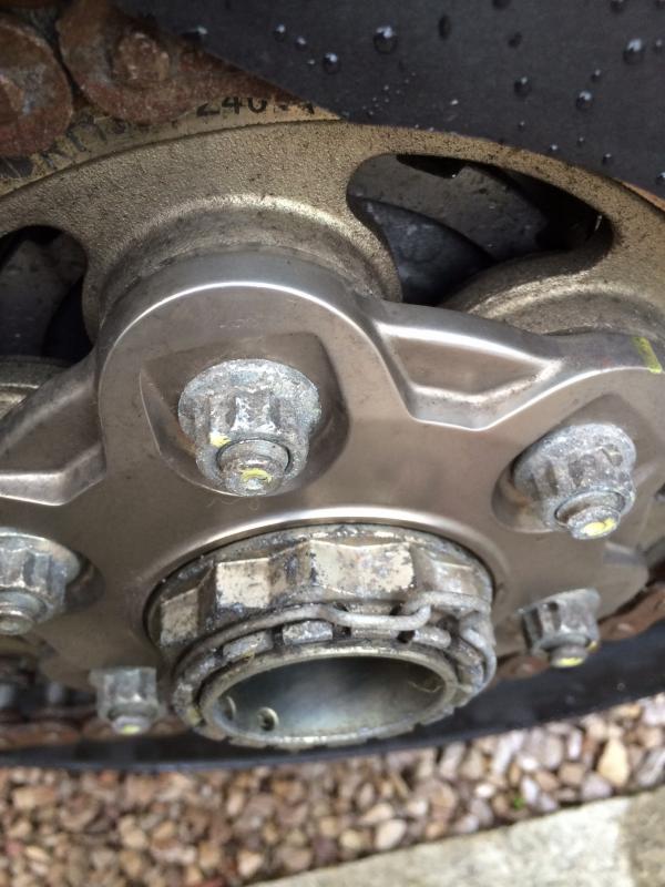

  1. yes bike has been washed at power washer every couple of weeks just using cold water to blast off muck and then spayed with mud off bike spray and residue wiped off. and has been cleaned using soap at power washer maybe once a mont as i was advised not to use the soap too often by al year biker. i think i use muc off cleaner once a twice when hand washed it but diluted it down with water and didn't leave too long maybe 5 minutes before agitating and rinsing. and used chain cleaner (muc off / silk one) every over time and re lubed.
    is it worth contacting dealer do you think?
  2. Maybe I'm just not sure what further maintenance or preventative measures I could take. No other bike I've had has done this
  3. I'm not a fan of Muc Off and similar products. I know some people swear by them but I think they're too harsh on finely (read 'poorly') plated assembly parts.
    Why not contact the dealer? I'd certainly try, you've got nothing to lose but don't hold out too much hope. It would be nice if they'd clean it up as a good will gesture, but you never know....
  4. Hi mate, that muc off (if it's the one I'm thinking of) is very aggressive. It's designed to eat through grease, grime and general crap that has built up without hardly any agitation on your part. There fore it's very aggressive. Even if diluted. Sadly, I think this has washed away the ACF 50 protection.
    I don't know much about bikes, if anything, but from personal experience and using ACF 50 on a few bikes now. Over the winter, it's best to drench the bike (obviously not the disks) in ACF 50 (I've not found anything similar that offers anywhere near the same protection). Leave the bike standing over night, with some paper/cardboard under to catch the drips. Wipe down in the morning and go for a ride. The residue left will burn off so don't worry about the smell/smoke at the start. It will go.
    Then, simply don't clean the bike until the salt goes. Mine is LAYERED in crap at the moment, I'm almost inclined to go grab a snap to show you just how much, but also to show how protected it is under by wiping away with my finger.
    I think your best bet at this moment in time is a new chain, don't worry about much fling from wax, just make sure it's coated every couple hundred of miles, as the water will wash away even the best of waxes/lubes in no time. As for the rest that's rusting. If you can spare not having your bike for a week. Take off the nuts and bolts that have gone bad and send it off to a powder coaters and get them re plated. The fee won't be much as all they will do is sink them into a chemical bin getting rid of the fur.
    It's probably not the best solution, but it's how I would tackle it. And as I said, sorry to be blunt and a bit of a cunt. But I just think anything you say to the dealer will be pointless as they can instantly turn around and say what I have said about maintenance.

  5. I'm guessing that power washing is the issue here. ACF50 is just a barrier and any sort of washing is just going to remove the coating. I would not be surprised if after two power washes all the ACF50 has gone. I could be talking bollocks here but if ACF50 is applied and the intention is not to reapply then the bike should be rinsed with water only. No washing.

  8. Unfortunately a lot of the modern parts on bikes are (a) made to a price. And (b) because of people's obsession with every part being ultra light weight, the result in a lot of cases is the durability is at the very least questionable.
    So the result is in our rather damp climate, unless like me, you treat it with kid gloves, it basically rusts or falls to bits before your eyes.

  12. No worries mate. Wasn't having a dig back it's just a bloody expensive bike and should be all to go out in a bit of rain and not need cleaning till it's immaculate and the dried chain cleaned and re lubed after every ride. I asked the question when I bought it about how it would stand up to all year use and was advised just use it and clean it occasionally and will be fine. It clearly isn't. If dealer won't sort may look at different bolt and wheel locking nut options for rear sprocket. Seen some of those cnc parts and don't seem. mega money to keep it looking nice.

  16. Stainless steel.
  17. yep stainless would be best. can anyone advise of any good quality replacements for the crappy bits on mine (rear procket bolts and the locking nut if thats what its called") and it may be something I'm going to have to look into. still think i will speak to the dealer. chain excluded.
  18. Speak to Pro Bolt. They do them in kit form so you can do a section of the bike at a time.
  19. Just had a look but don't seem to have them for rear sprocket area
