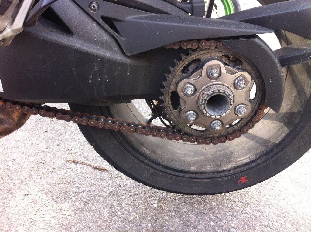

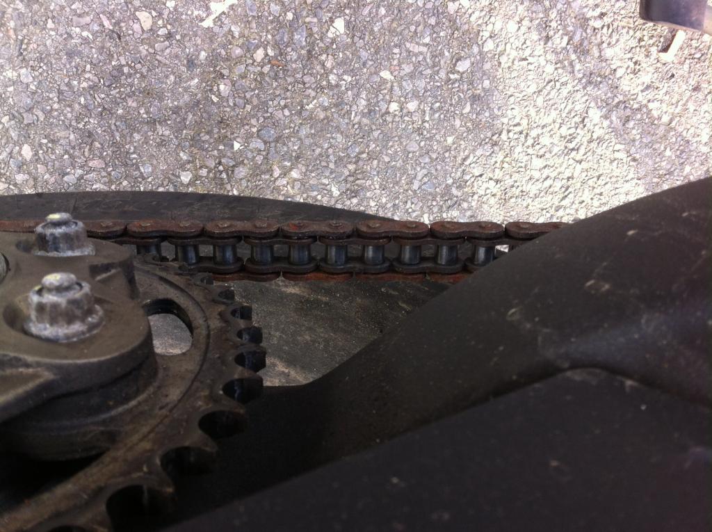

  3. Ok so here is mine today. Hopefully you van see the rollers are well lubed, as I have maintained it regardless of comments ;-) with regular squirts after every other ride at very least. Also had a full bottle of FS thrown at it, and the chain has had several really strong cleans with brush and varying products, incl a anti rust one.
    Its worth noting it has had one adjustment, which was a fair amount, and no signs of any tight spots
  4. Should have cleaned the rest of the bike while you were at it lol
  5. Sorry to say, but looks like its been parked in a bucket of sea water.
    Would not be impressed if my chain and sprocket looked like that!
  6. It's almost like you live near the sea :wink:
    However the new oem chain MR put on mine and I've done 40 miles since has signs of rust - the oem one when I bought her didn't - so deffo substandard batch or new manufacturer
  7. I use scottoil only in the summer but in winter top up with some sae 80/90 gear oil brushed on to the side plates every couple of hundred miles, especially if expecting very wet or salted roads. So far no rust on the oem chain in three winters.
  8. I think its a recent thing as it seems OEM Ducati chains installed in the last 6 months have the winter blues..or so it seems. And noticeable those with lovely shiny units have none OEM bits fitted
