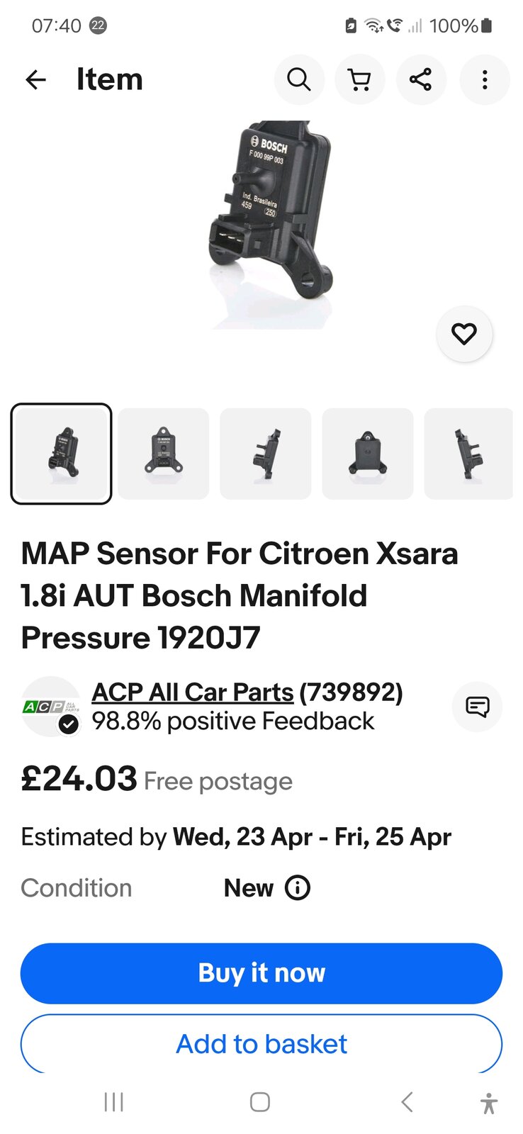

    I located the air pressure sensor under the headlight area, I'm going to get that off tomorrow and test it. I've decided not to touch the TPS. The more I think about it, the more I think that it's the injectors that are the problem. The sparkplugs etc should be arriving tomorrow or Tuesday. Cheers for your help :cool:
  4. If you need a new air pressure sensor
