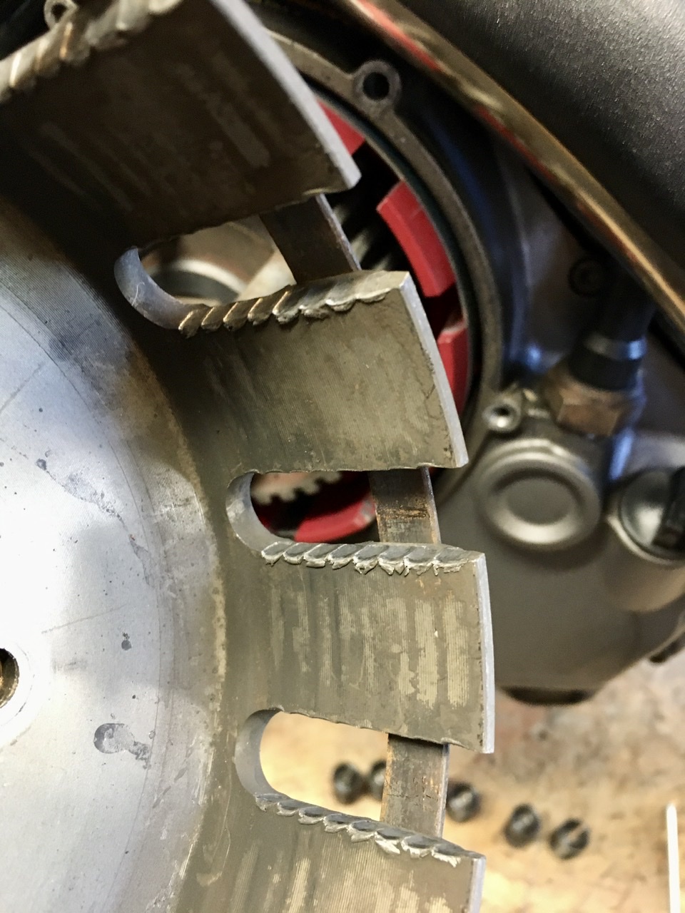

  1. Just pull the plates and check them Paul. As @Android853sp says, 3mm thickness for friction plates, below 2.6mm is worn out, bin & replace. The Steel plates wear a lot slower, may just have to replace the friction plates.
    If you e more than 0.6mm gap between the basket slots and teeth then the basket ideally needs replacing. However, if it’s not too badly notched you may get away with it, it’ll just be extra rattly. If the basket looks like this it’s shagged!
  2. Check that you have the correct clutch springs as well and that they are exerting sufficient pressure. Old springs can compress over time and loose their pressure, also I've heard that spring lengths and rates can vary slightly between models. :thinkingface:
    Many years ago I changed two fibre plates for sintered plates on my TZ350 ( it was a common mod to stop plates breaking) and it then suffered similar symptoms to those you describe. The cure was to swap 3 of the six springs for TZ750 springs which were slightly longer and stronger, problem solved.

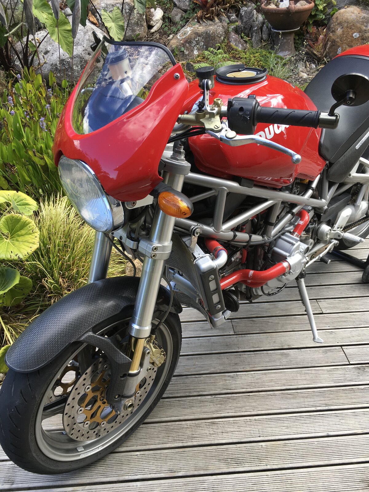

  7. Started making it mine.
    Fitted my cheapo Chinese bar end mirrors, and if I can use them I’ll buy some decent ones
    C&S turned up today, one to fit next weekend probably as busy this weekend. Gone 14t
    Didn’t buy the slipper I was asking about for it seems ages :rolleyes: so now on the look out and probably buy a clutch holding tool ready
    Still can’t decide on short can or not. Think I’ll buy the short can and take advantage of @Zhed46 ’s kind offer on his cored cat and see how that goes
    Changed plate, ok it’s an S4 not an S2 but who cares ;)
    Fitted the tank clip to use my givi tank bag
    I have several sets of clip ons that fit, so may whip the headlight bracket off next week and try them...
    Still on the list: clutch, obvs, and pads. Look lots of life but suspect they may be a bit glazed, as they are almost as wooden as the GS! So I’ll take out and clean.
    Set the sag the best I can given weight/springs.
    if the weather is ok may follow Cookster to Silverstein in bike instead of car. Good time to do my sag ;)
