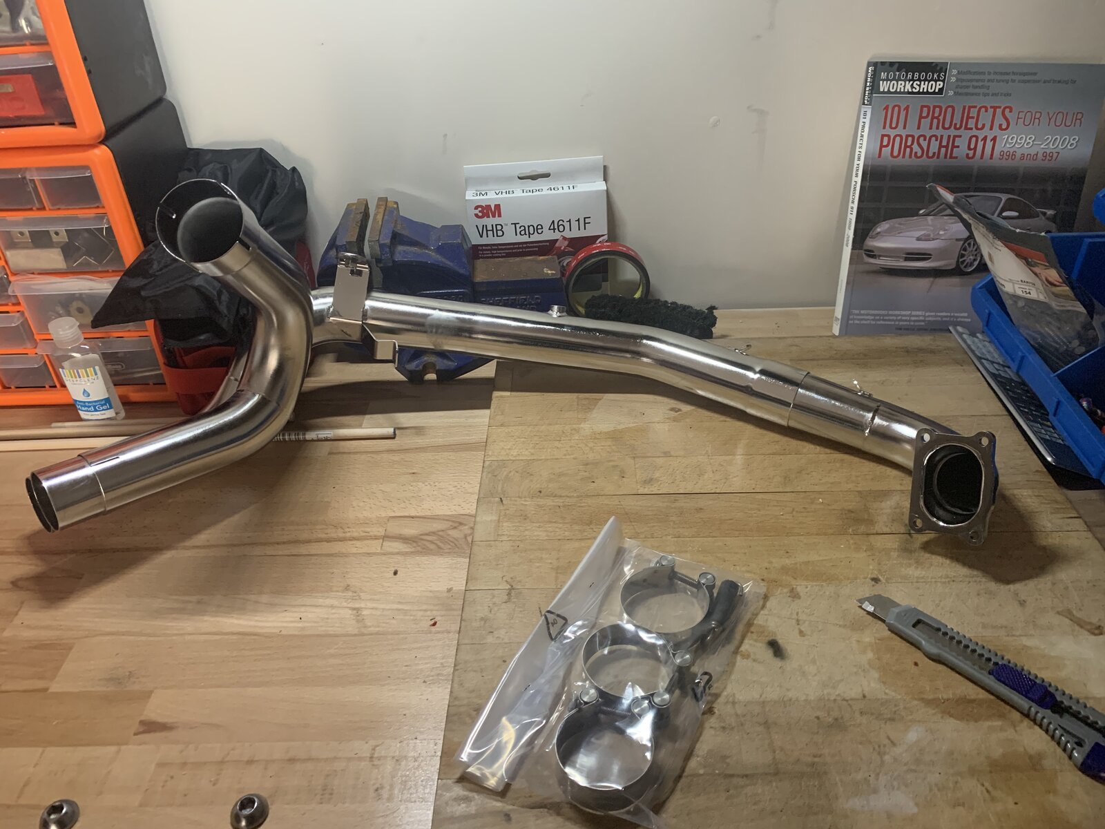

  7. Headers arrived....
  8. On the left with the tape
  9. Mk 1 escort exhaust clamps...:upyeah::)

    Anyone know a good sours]ce for the blanking plugs? The spark does come with lamba holes for custom tuning :upyeah: but I don’t want to put the sensors back in just plug them off.
  14. Yep, except for mufflers. S4R tho, not RS. And not the later testastretta.
  15. Maybe its a testretta thing?
  16. Are they the big proper lambda holes or small ones?
  17. Look one of each. The shorter fatter rear header pipe is bigger than the longer slimmer front header pipe
    Haven’t measured yet, just opened and noticed them
  18. You get a small size and the 18mm ones they use on a dyno
    Personally I’d get tge small ones replaced with the bigger ones...
    it’ll help your dyno operator when the bike rubs like a bag of spanner’s:joy::joy:
  19. It wont be rubbing any spanners, in a bag or not ;)
    Any good sources? Pretty sure they have a habit of working loose and lock wiring is a good idea
