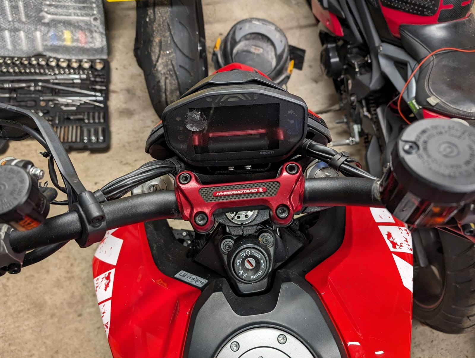

    the handlebar clamps seem bent. the yoke/bolts seem fine but theres something not quite lining up.
    managed to get the clamp/mounts/some evotech plate for like £56quid so absolute steal imo. hopefully that sorts it and its not the handlebar thats bent.
    after that it'll be ready for an MOT, i haven't fitted clutch cover yet since it won't actually need it, no leaks ma.
  11. Are you sure it’s not just knocked the wheel and yokes out of alignment? I’ve just had similar on my latest salvage repair and I had to loosen the front wheel and yoke clamps off and give it a jiggle to get it back to straight.
  12. tbf literally just installed the fresh mounts/clamp
    it's a bit better but still out, so i'll give what you say a shot and then disassemble the handlebar if no luck.
    picture wise its:
    to me it seems either the clamp/handlebar are out in relation to the yoke rather than the wheel

  16. Shes readyish, I ended up just going with stock indicators. Too much faff with the rest.
    Needs another mirror and few bits of fairing but they'll be more of as and when.
    Only question is it right that the hand guards are so low? I tried adjusting the handlebar but they are currently in the position that feels "natural" to me.
  17. If you look at the pictures of the bike on the Ducati website, the brake and clutch reservoirs are vertical, yours are not. What feels natural to you has the bars rotated too far forward. Andy
  18. It defo seems so because the handguards/indicators dont seem like they'd be in a useful place.
    Shame there wasn't any adjustment to it at all.
