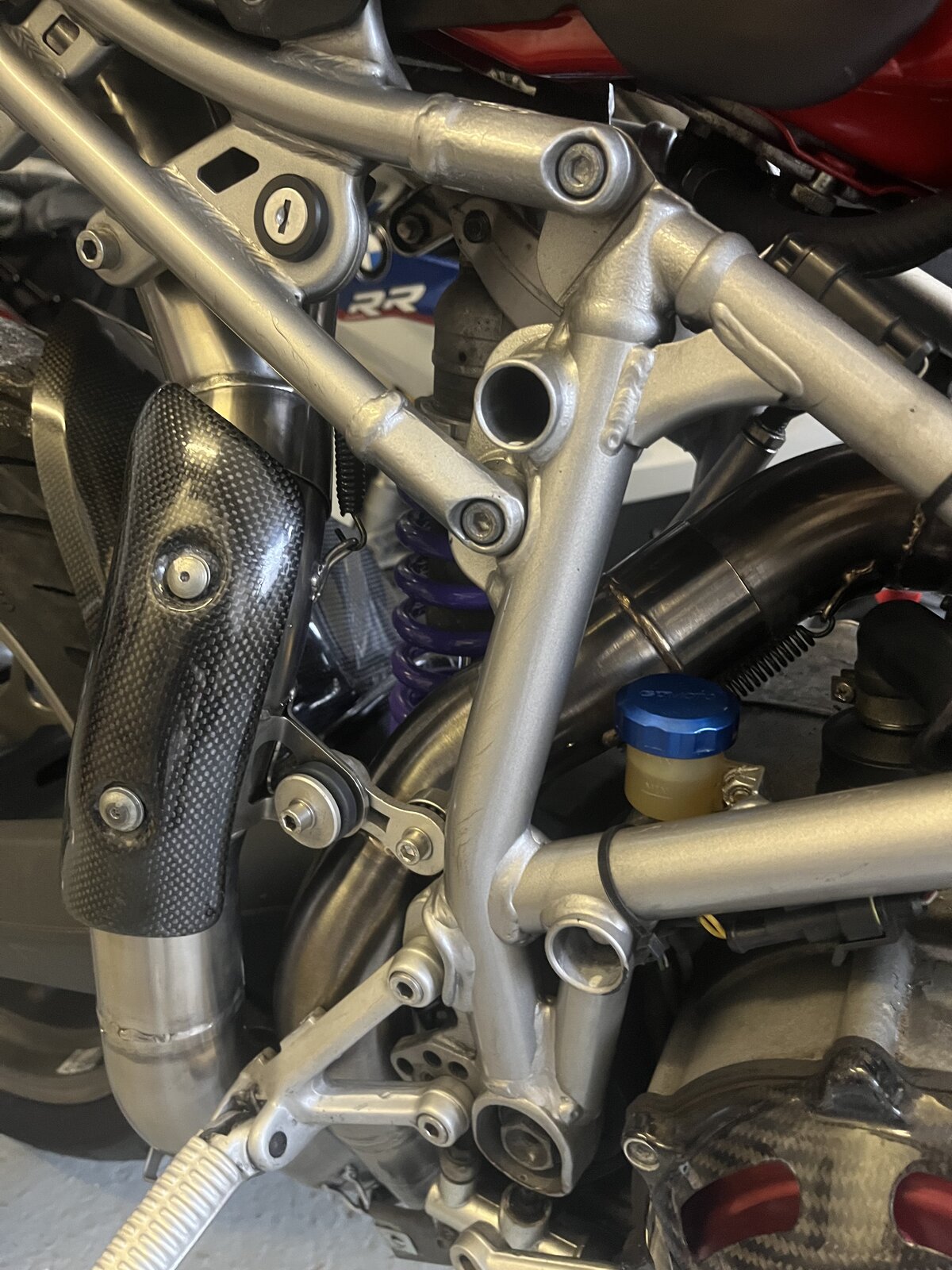

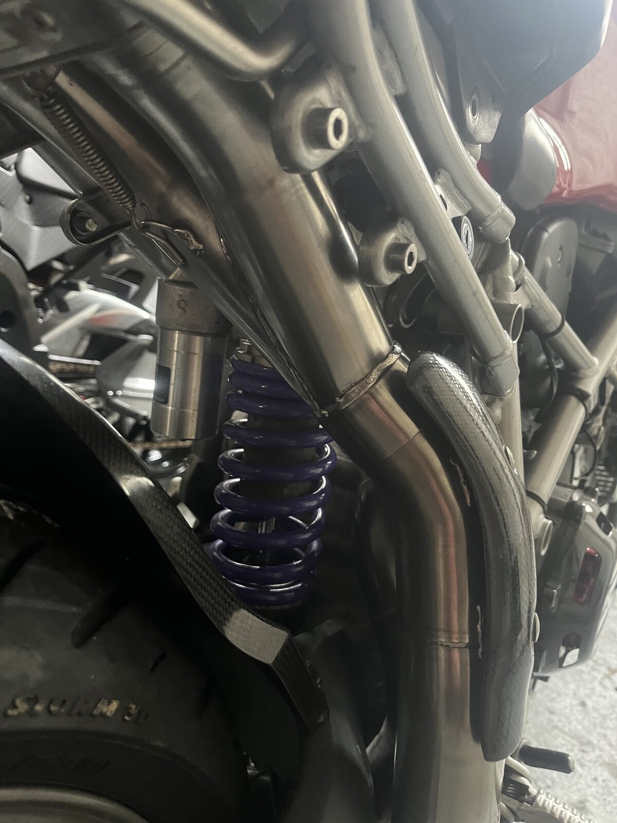

    The new 57mm symmetrical termi system arrived super quick from Japan, unfortunately I got stung for the import duties but I’d calculated those and factored them in and still think it was great price for a system that looks almost new. However what wasn’t so quick was getting it fitted what an absolute pain in the ar$e. I’d read it was a tight fit but in reality it was just ridiculous. I lost count of how many times I had to take bits on and off or loosening and retightening sections. At one point I almost quit think it must have been the wrong system for my bike. Finally got it on and happy enough with the sound to make the pain of installing it worthwhile.

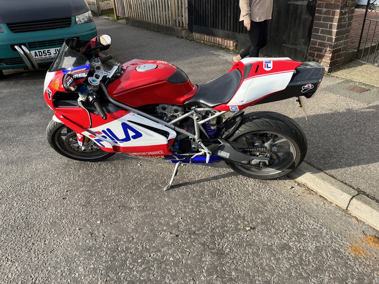

  5. She’s all back together and managed to take her for a little 45 minute test run. What a joy to ride and very different to what I expected. Everything was so silky smooth like throttle response, gear changes up and down, suspension was pretty plush and when I got back nothing had fallen off, nothing had melted and nothing was leaking. It felt like a much newer bike the way everything was so smooth and effortless in comparison to the 848 evo I had, the gen 1 Diavel I have now and my Daytona track bike, it makes them all feel agricultural. It has nowhere near the power of the Diavel but the speed it picks up is effortless and deceiving and the limiter makes its self know pretty quickly. Even with the full system it is much much quieter than the Diavel or my old 848 with termi end cans but it’s still got a nice sound especially on throttle. I’m looking forward to some better weather now to really get to know the bike but in the meantime just need to sort getting some extra keys cut and programmed and get a map done to suit the new full system.

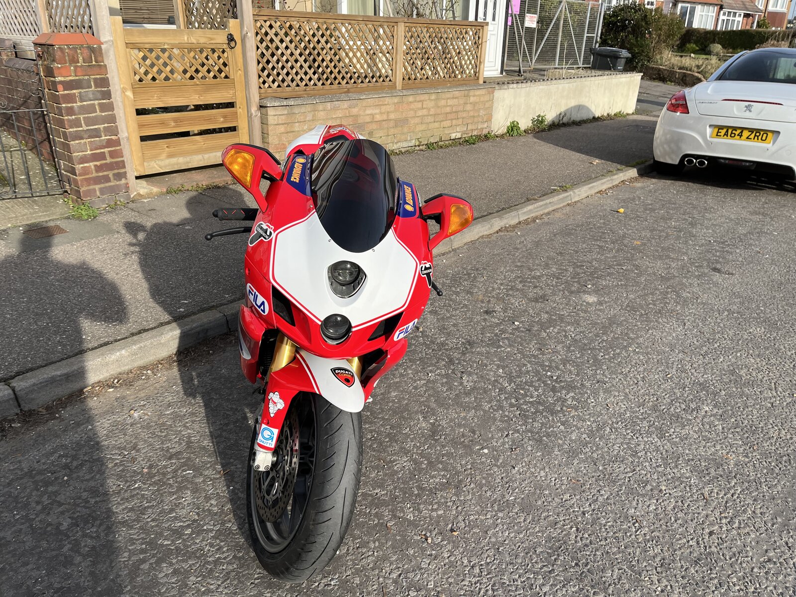

    Not the best pics but just grabbed a couple outside my birds house.
    • Like Like x 12

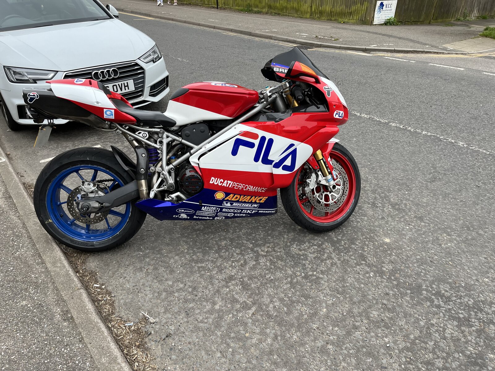

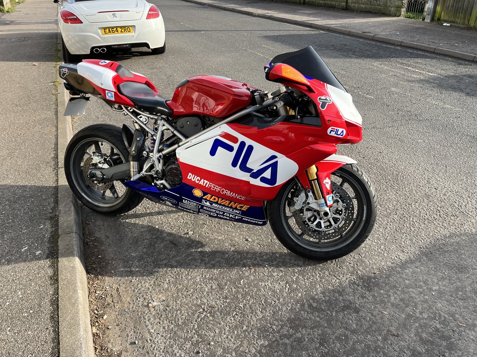

  7. May as well keep everything in the same thread. Have made a couple of changes with a tank and pair of wheels from a proper Fila 999r along with a nice new pair of Bridgestone S23’s. Could’ve kept the hardly used tyres off the original wheels but the dates on them were 2015 and 2016 so got new for piece of mind.
  8. I hate to say but those wheels appear to be standard cast type rather than forged R type wheels.
  9. Those wheels look a lot like just repainted standard cast wheels, you sure they are off an R?
  10. Ahhh yes I think you’re right. I got them from Desmo market in Italy which didn’t translate to English well but I’m not at all bothered though I only wanted them for the colour and they were only £400. Them being forged or from an actual r weren’t anything to do with why I wanted them otherwise I would’ve researched better.
