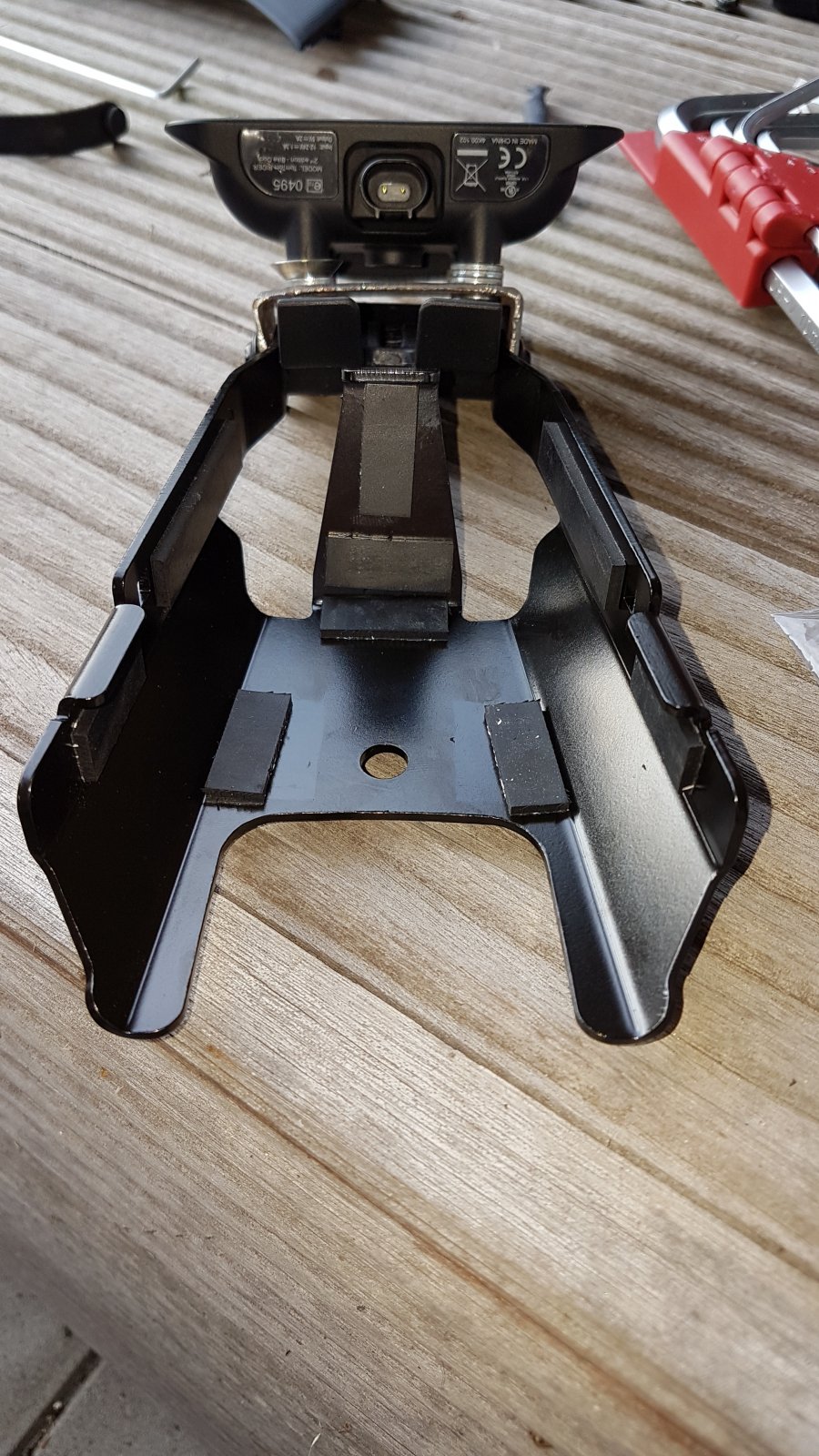

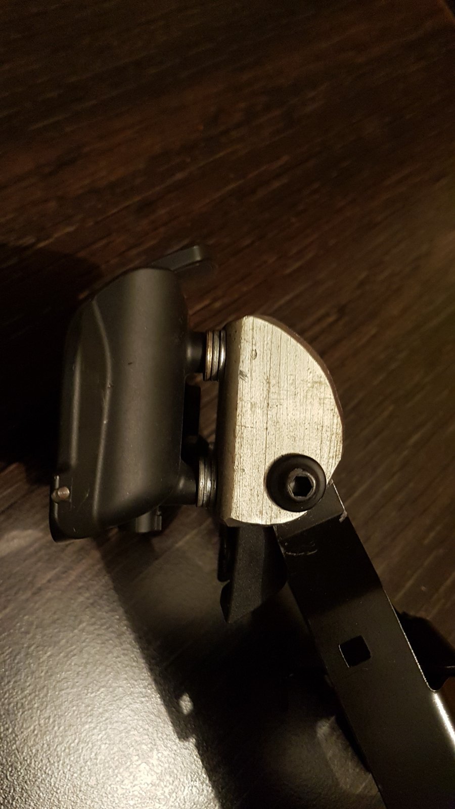

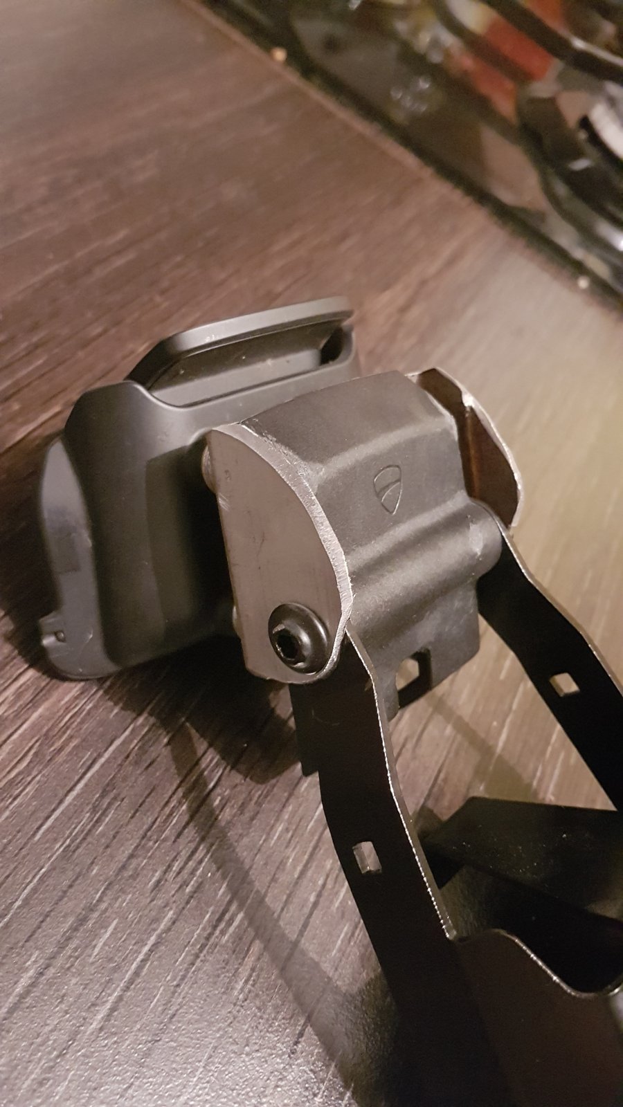

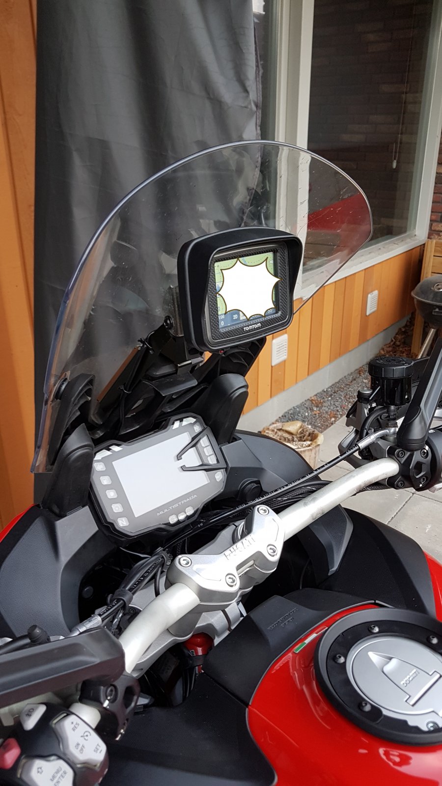

  4. I made a simple mount for now. It's a bit crude, but I think it works.

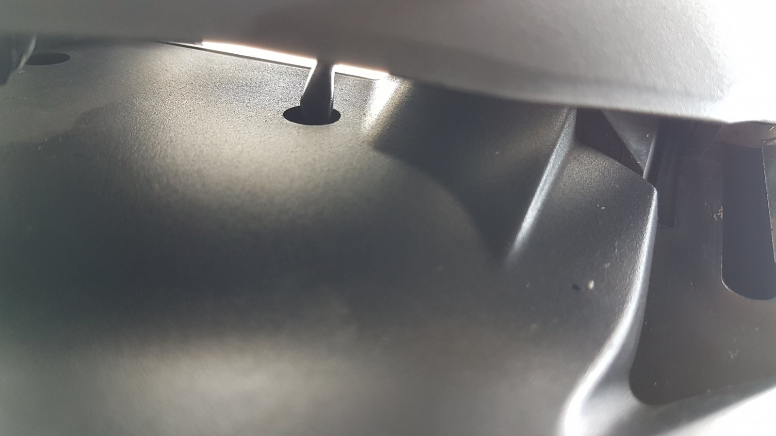

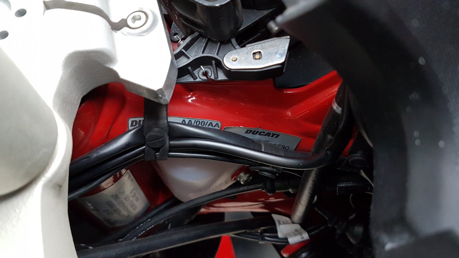

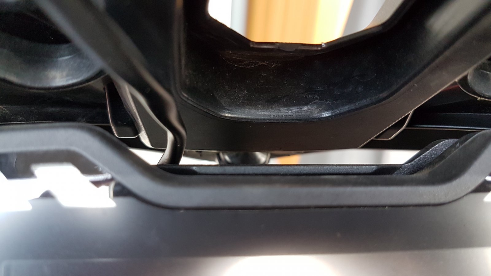

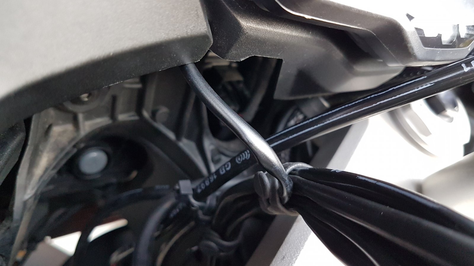

  5. This is how I did it.
    #45 Martijn, May 29, 2017

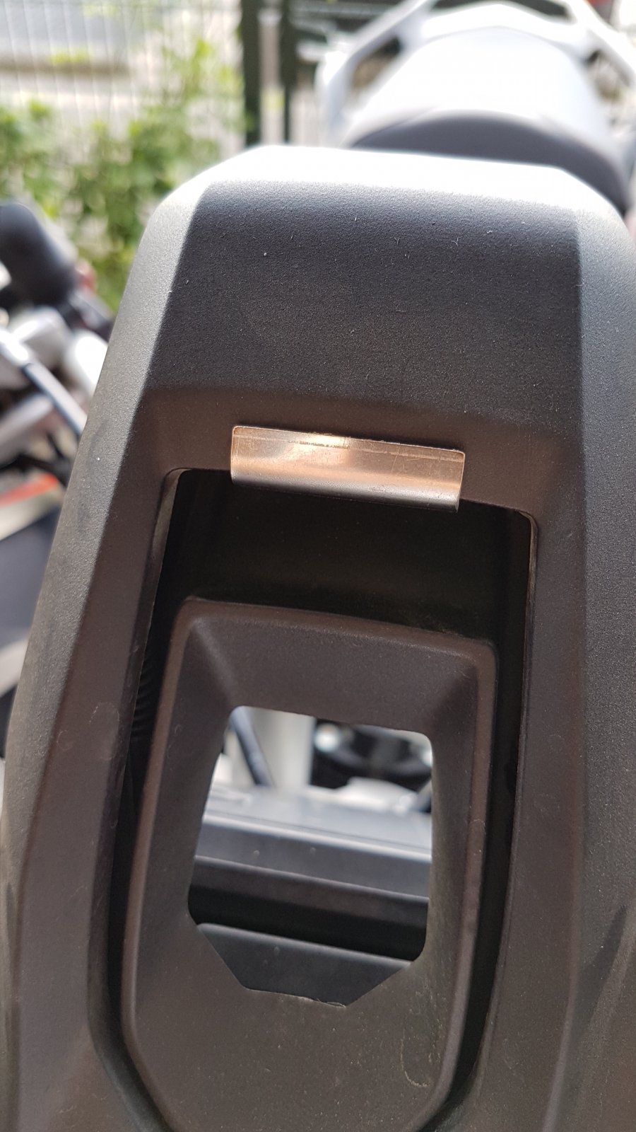

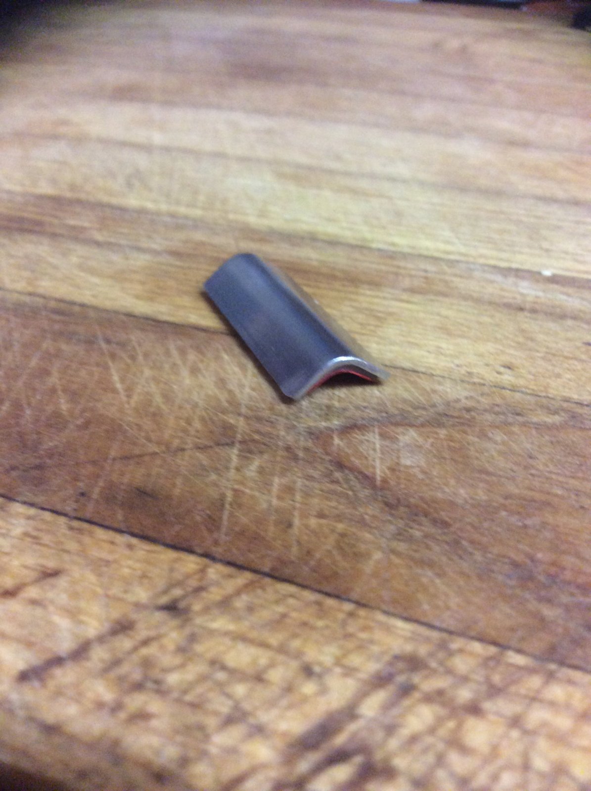

  6. Just been looking to fit my bracket, where does this piece fit?
  7. See my first foto. After reading some post here my guess was that it belonged there.
  8. Thanks For the photos. I couldn't for the life of me get that silver part to stick where you have shown. I just stuck it at the top front. It's all a pretty tight fit when you get those rubber inserts added.

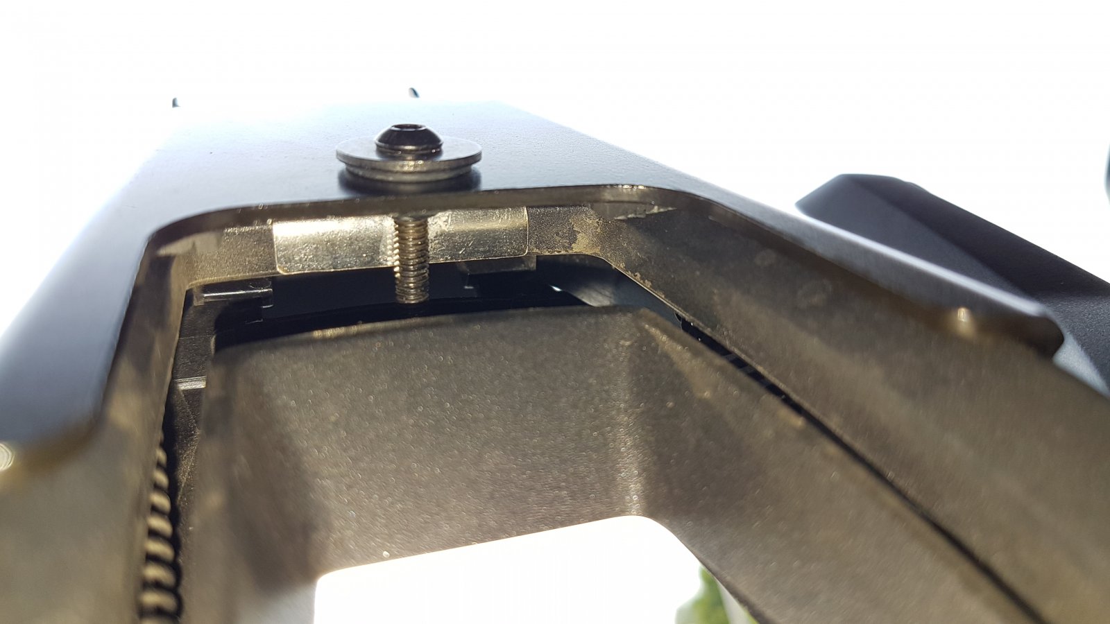

  12. Use Dropbox Good on ya. I'm currently working out how the centre screw, the silver piece and the expanding rubber nut thing all keep it together!

    Here's what is probably the most useful page (8) from the instructions, shows where all the sticky pads go and the metal plate. It's actually very easy and only took a few minutes to fit
    Regards Roy
  14. That is indeed the most useful page! I'd already mounted it by the time I read this post though. Didn't put the pads in the same places but similar. All fitted now
