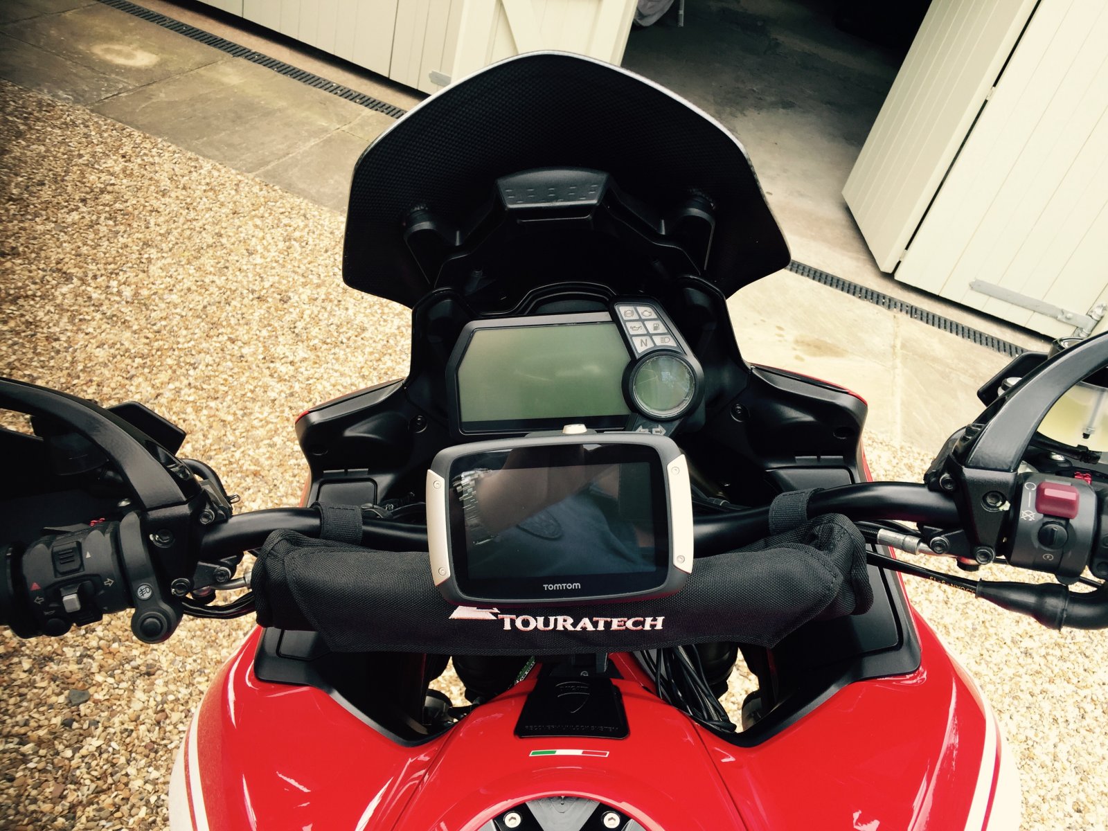

  1. Cheers everyone for all your help and suggestions. I think I'm going to go Tomtom 40 with yoke mount.....
  2. Personal preference I suppose but I have mine bar mounted. Having used it for a while, I'm moving it to above the clocks. Approaching a roundabout with cars braking in front of you, the last place I want to be looking is down at my phone for which he exit I need.
    Also it will look better with all 'instruments displays' being one above the other. Otherwise it's a bit like having your car rev counter in the usual position but your speedo on the bottom of the steering wheel. Your constantly moving your head.

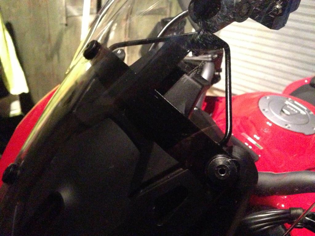

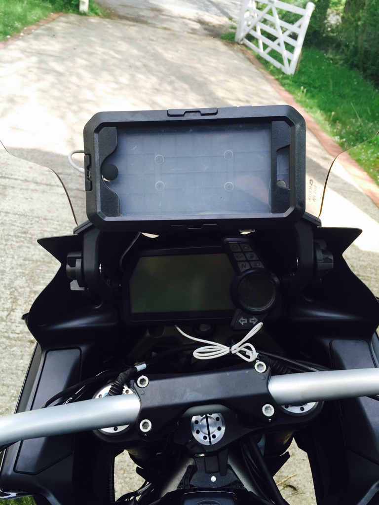

  4. Moved mine this morning. No navihalter but attached an iPhone mount to the screen bit. Aztec spacers give plenty of clearance for an iPhone 6 plus. Could probably get an iPad behind the screen but that would be silly... Wouldn't it? [​IMG]

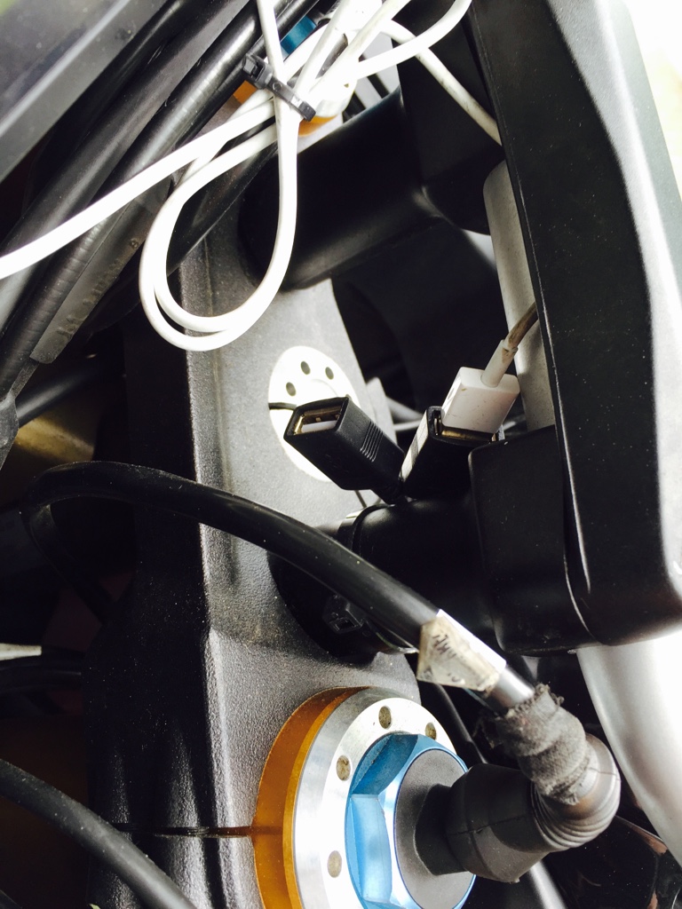

  5. Two more pics showing mount and USB leads. Must change that to a black lead though.
  6. I use Amazon basics lightning cables as they never break. You are spot on with the inability to use a charger but I just drilled a hole in the bottom
  7. first pic, is that wrapped around the arm all the way? Looks like the same holder I have but not found a way of fitting so high. Any more detail useful, esp as my satnav gave up the ghost yesterday!!

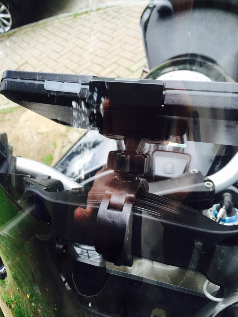

  8. No, not wrapped all the way but enough to get a cable tie through the two holes (having taken out the bolt) and pull it damn tight. When I get more time I'll drill the bit I've clamped it onto, then bolt it. Was out on it today though and it held up great. Even in all that rain/monster hail.
    I have just ordered a better 12v to USB converter though as this current one chargers fine, unless I really tax the iPhone with satnav, music and Bluetooth... At which point it will just about hold whatever charge it has or very slowly dissipate. Just satnav and it still charges fine.

  13. Mine sits perfect and took a few minutes just using my temp bodge cable tie. Maybe you have a different mount/case. I got mine from eBay, some guy paid full ££ for it but had an iPhone 6, not a 6 plus so I helped him out by taking it cheap.

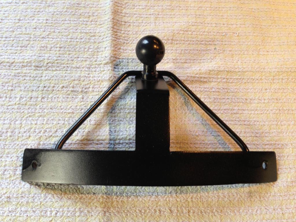

  15. So really you need a navihalter or make your own from a metal plate you can screw where the screen screws to the mount. Will take some more pics tomorrow
  16. That's where I mounted my Garmin, I did have a navihalter and couldn't fault it or the position apart from it was to close to my tired old eyes to properly focus on it so moved it to the yoke. Worth mentioning if you eyes are like mine.

    Also found an alternative to a navihalter which may be of interest
    Engi motorcycle accessories | Support gsp / Navigator Smartphone specific DUCATI Multistrada 1200 my 2010/2012
