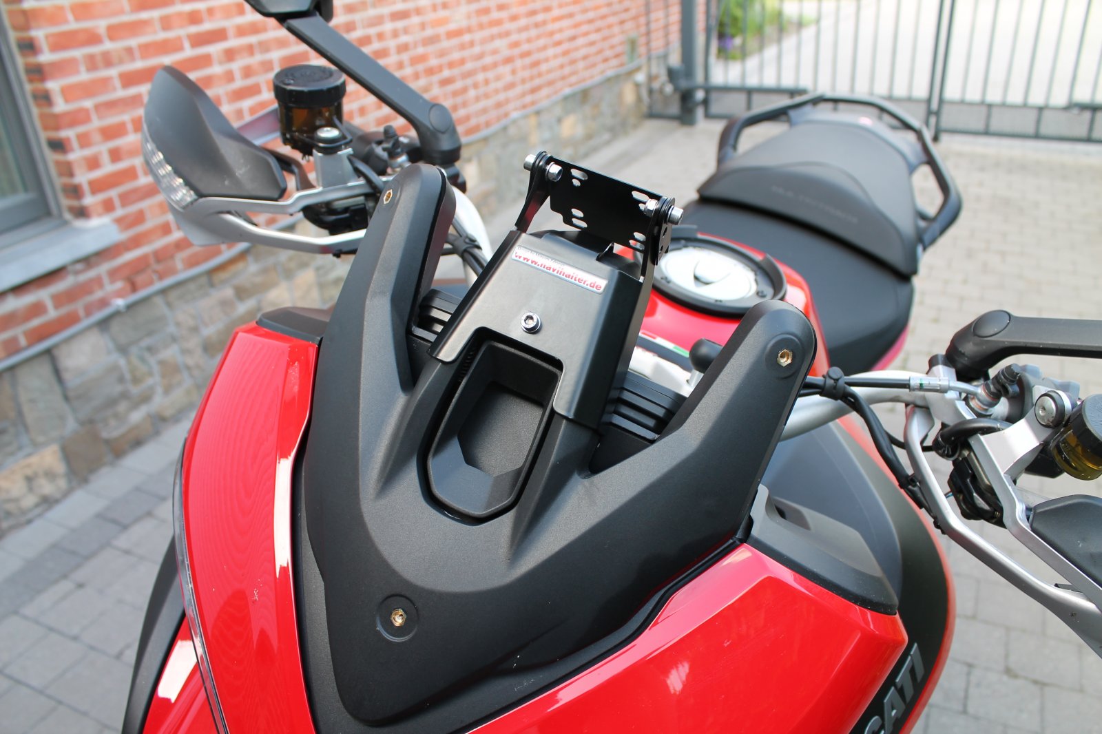

  15. I picked up my new mutley yesterday and got on with fitting the navihalter and tomtom 400.
    How short are the wires on that white plug?!! That was a start!!
    Does anyone know if you can pair the Bluetooth to the bike?
    Fitted a screen protector to the dash. For the sake of £4 for 6 why don't the dealers do it?
    Also had to up the seat height. Was told it was already high at its standard setting.
    Why don't dealers ask before collection what height to set the seat and do you want the front mudguard extender fitting?
    Enjoying the bike and looking forward to a higher seat!!!
  16. Spoke to the dealer today and said on the old model, 1200 my model, that the plug (under left hand panel) is a dummy plug and to direct solder sat nav to it as it is already fused too. This sound correct to everyone? I just question it as I'm sure ppl have bought plugs for some reason.
  17. It's a dummy plug you pull out, cut the wires and solder to your satnav wire and plug it back it. Jobs a good un!
  18. Fitted mine the other day. Height adjuster is still usable but make no mistake it's not an easy operation with the navihalter on. Don't let it put you off. Still awesome bit of kit.
