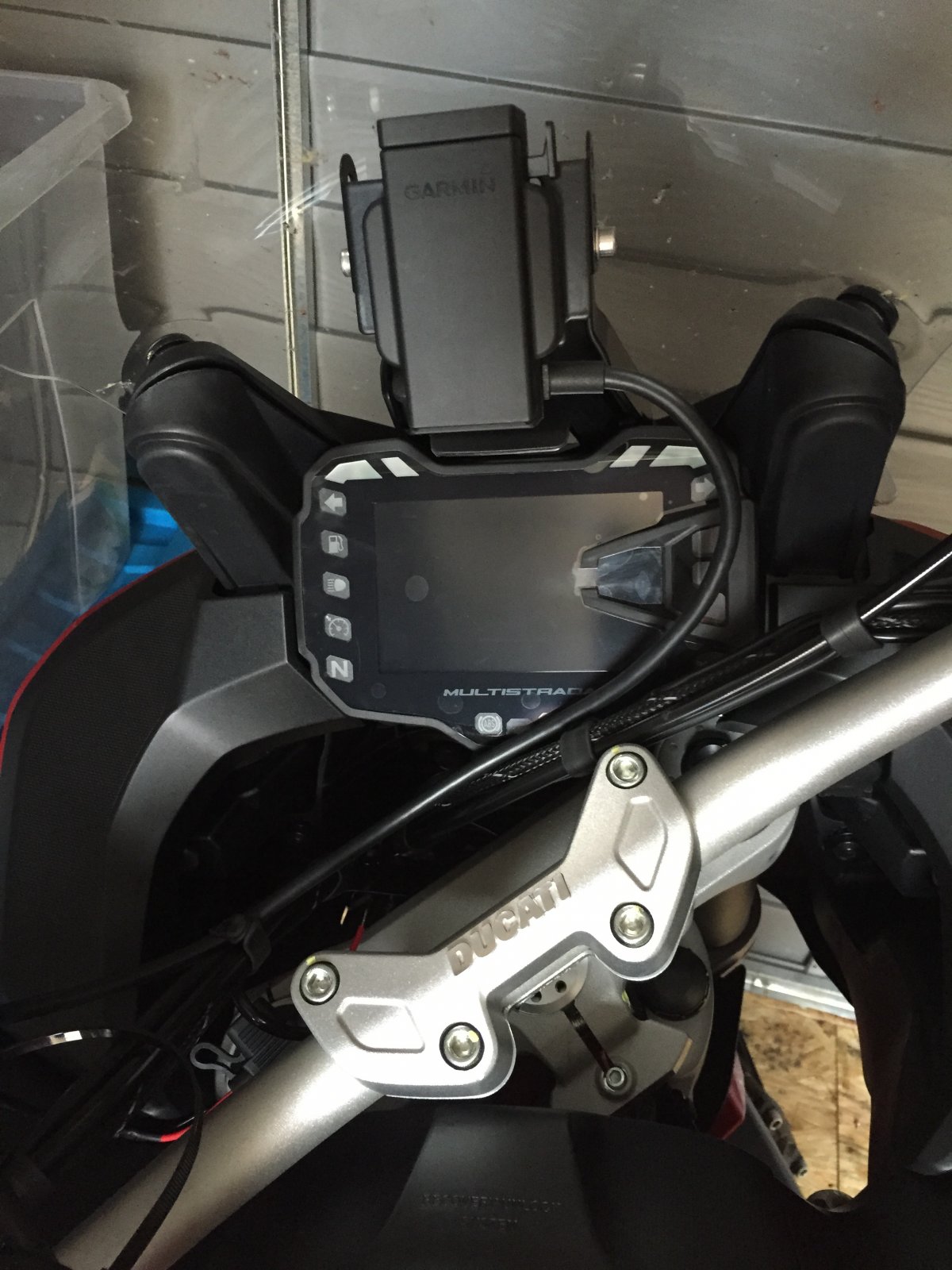

  2. sat nav and navihalter fitted. In my opinion its definitely the best way to mount the sat nav.
  3. Tallboy, you have got to re-route that power cable behind the dash!!! Jon.
  4. it's been done, was just for a photo for my mate which i thought i would share on here for those interested.

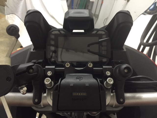

  9. IMG_0730.jpg I went a different way and mounted the TomTom on the handlebar yoke below the gauges. Uncluttered and easy to use/see, however, if one wishes to mount a tank bag forget about it.
  10. I reckon that wouod work ok and be viewable with the little ducati tank bag. It sits quite far back and isnt very tall, plus you cant get a big bag on there as it fouls the bars
  11. I disagree. I have the little Ducati tank bag but there is not enough visual space between the top of the bag and the bottom of the dash to fit in a satnav - that was my plan A, but it doesn't work even for me. For a shorter rider this would be even worse.

  13. @Pete1950 I checked, and with the tank bag in place and sat in regular position I can see the Ducati writing on the handlebar clamp, so no reason you cant put the satnav there as suggested above. With a bigger tank bag yes it probably would be more of an issue
  14. OK, @bradders . If you set up your Satan-nav on the handlebar clamp as you suggest, I would like to see how it comes out. Perhaps the next time we meet up somewhere.
  15. I'll tape it there just for you ;)
