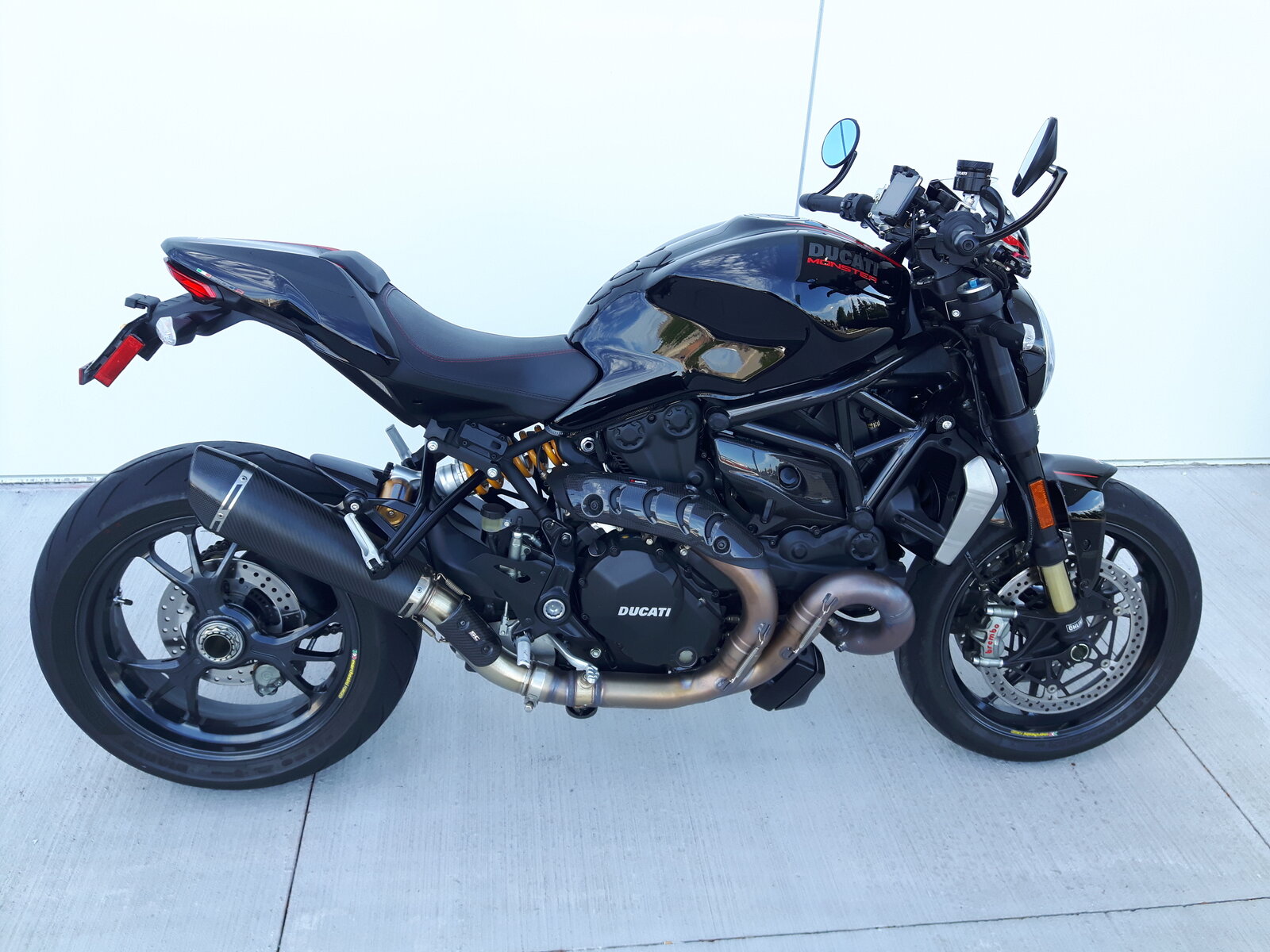

  15. Monster 2018 mods-1.jpg Sc-Project Carbon Conic with Rexxer flash.
