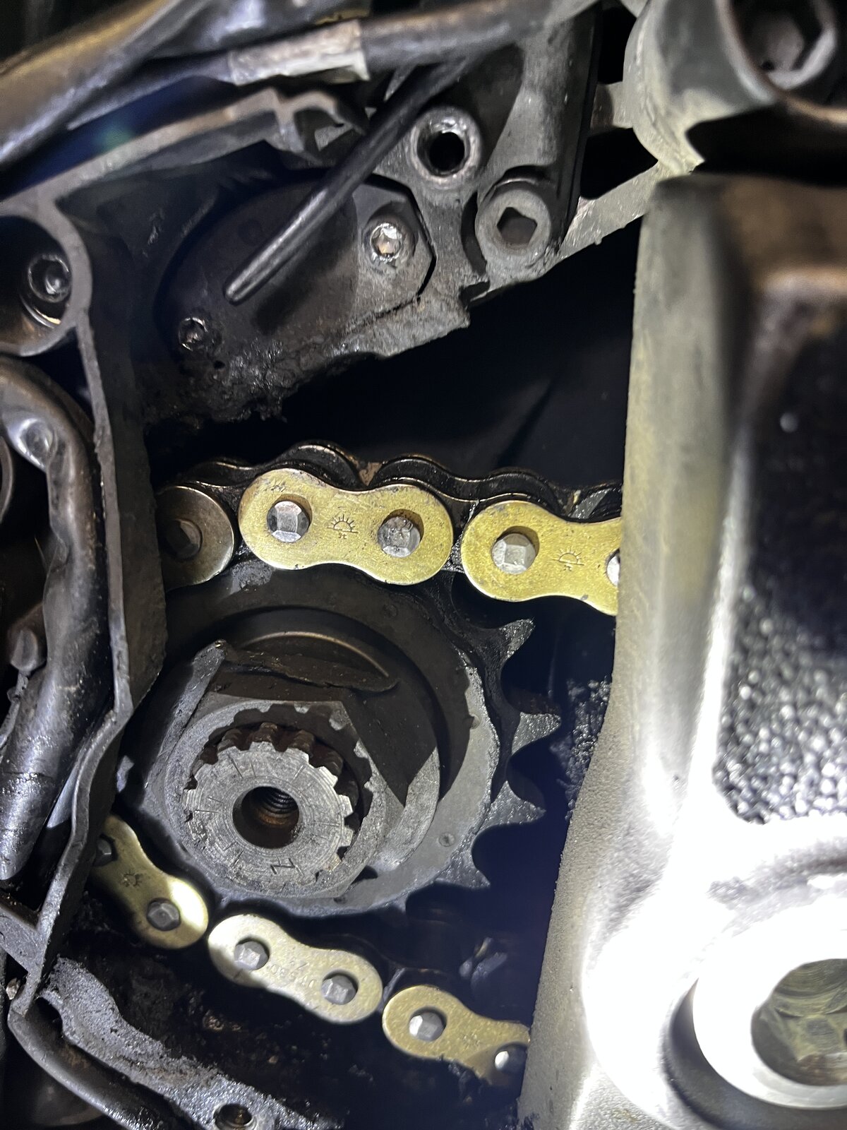

  9. Bet it wasn't rusty under all that oil :D
  10. Nope. Looks like even the front sprocket might be rust free:)

    Is the one you have bought in good nick? Pic’s?
  14. Yeah, very clean for the year.
