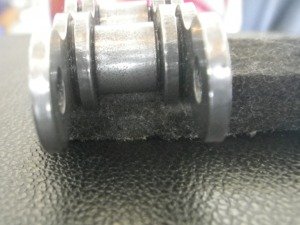

    Seems to deliver the oil via a felt pad...

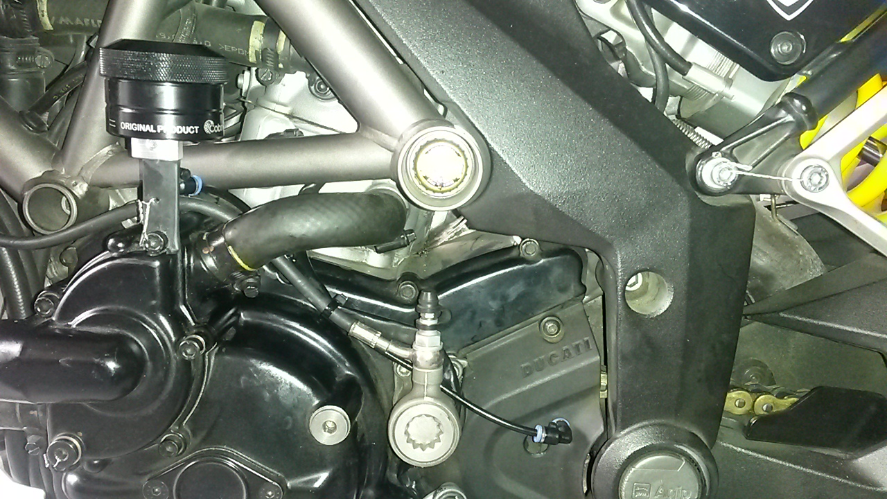

  7. I’ve routed my Scottoiler outlet pipe to the front sprocket. Seemed silly not to as the reservoir is so close.
    It’s a bit of a messy job at the moment - lots of cable ties, but I’ll neaten it up when I have time.

  10. I possibly could, but as I was adapting the Scottoiler from having previously been fitted on a Monster 1200, and another Multistrada before that, it was a case of doing a functional installation with what I had lying around in the garage.
    I’m thinking of designing a little block that the oil outlet pipe will fit into, and that I can secure to the chassis casting, adjacent to the swing arm pivot. This will facilitate dropping oil onto the chain just as it comes off the front sprocket. I’ll see about mocking something up on the CAD later in the week.

  12. I'll add by saying I've done about 500 miles over the weekend and my front sprocket outlet managed to loose the little narrow outlet pipe, so the oil delivery was a bit hit and miss! I'll be designing a more permanent solution, or I may just bite the bullet and try a double outlet thing on the rear sprocket (although it's about £25, which seems steep to me).

  15. Further to my post above, where I mentioned about fitting the outlet adjacent to the front sprocket, I've since relocated it to the rear sprocket. It's neat and tidy and drops oil precisely where I want it. Job done, as far as I'm concerned.
    Instead of using the usual clear hose to run oil along the length of the swingarm I've used the smaller diameter black piping, and sandwiched it between the swingarm and the chain guide. It's neat and out of harms way.
