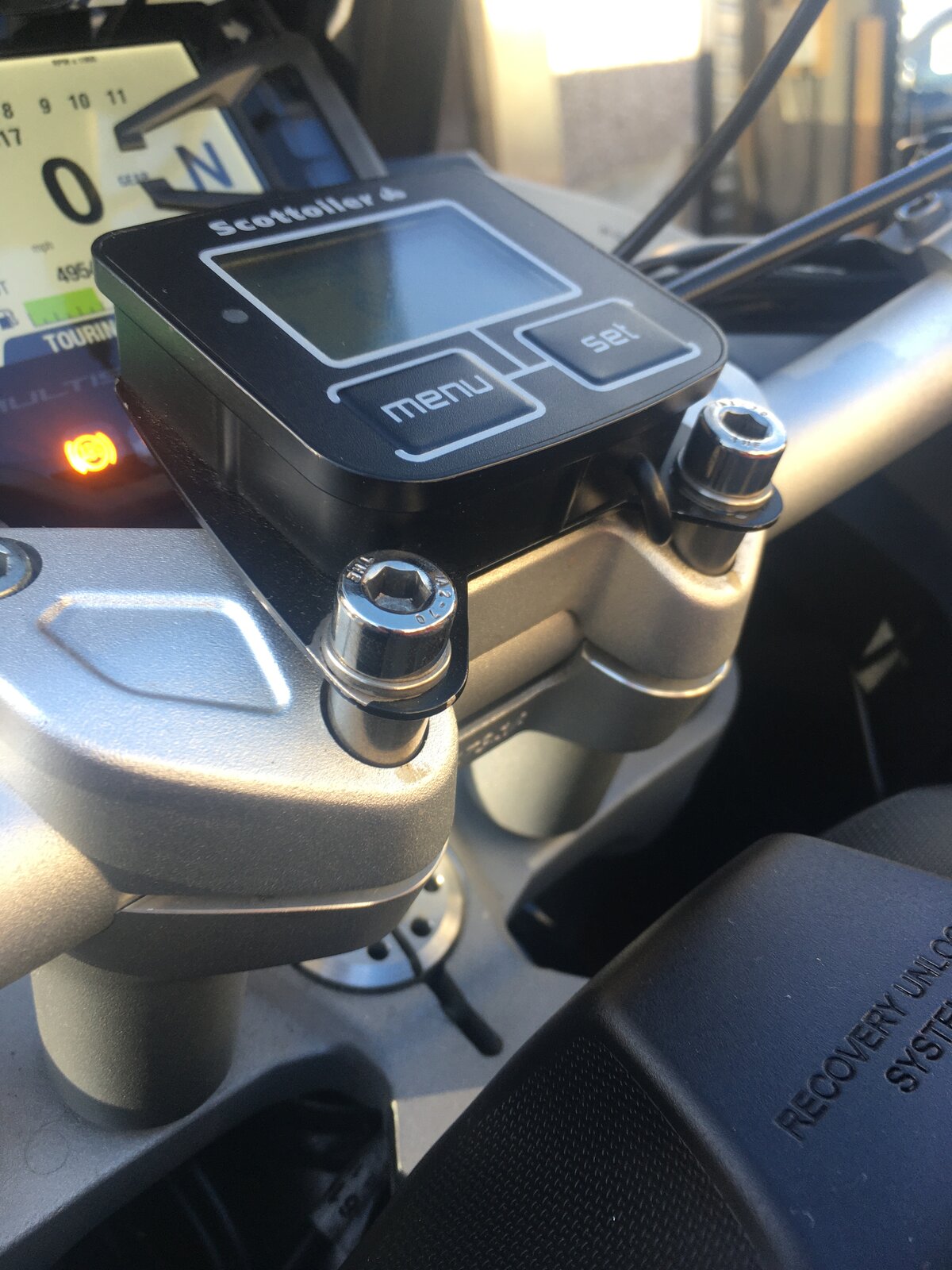

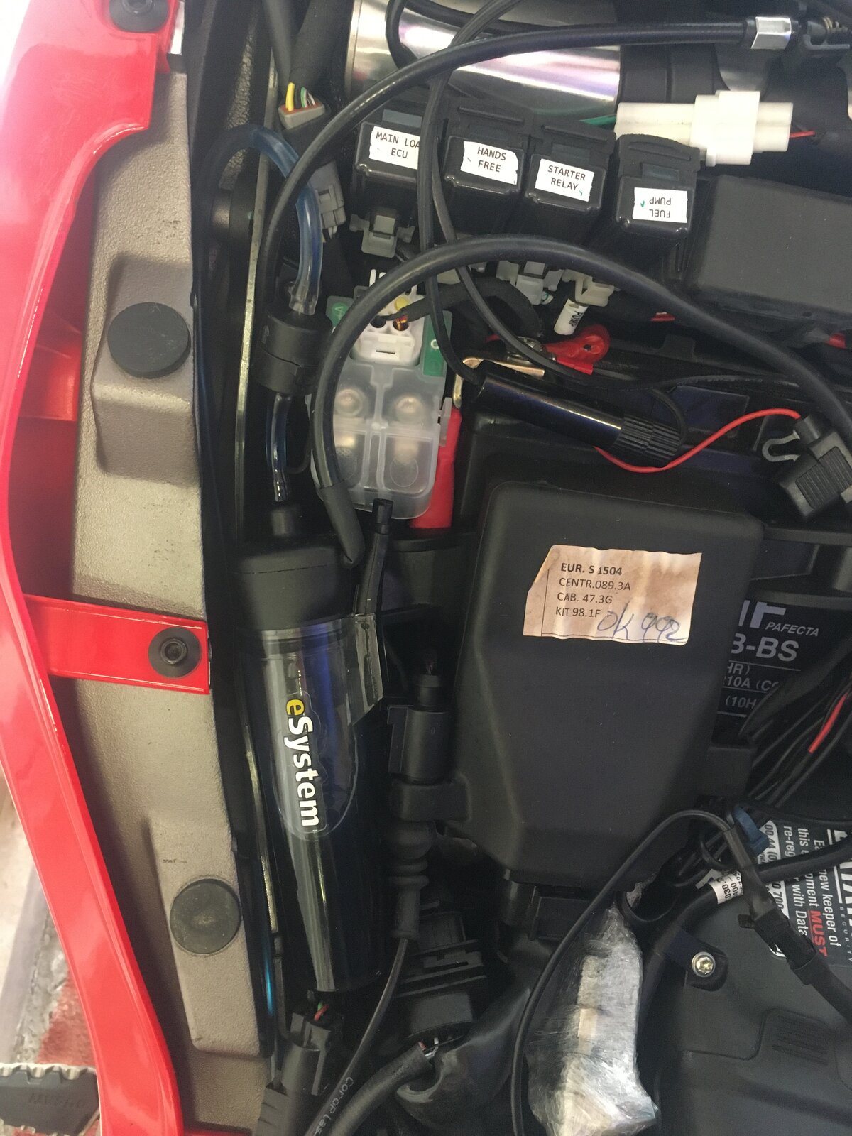

  6. Anyone managed to hide the reservoir away from the engine? I’ve been looking at the underseat area. On my Monster 1200 I managed to get it squeezed under there.
  7. Mines to the rear of the engine, under the seat and out of sight.did have to move a small electrical connector block forward to the bottom of the oil reservoir to fit in this position.It may get a little warm from the engine but would probably help the viscosity of the oil with delivery to the sprocket/chain.

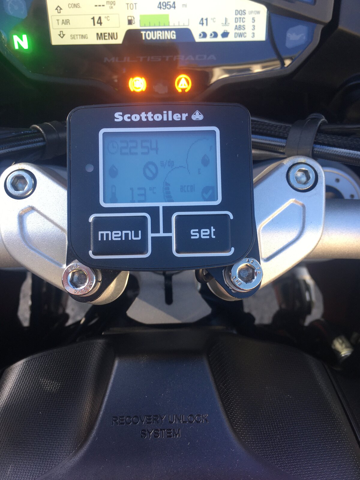

    I made a small plate and mounted the clock/dispenser at the handle bar mounts. Hope this help
  8. The xSystem has a different reservoir which may need a bit more space but I'll def have a look. No control panel or vacuum input to think about, just connect to the battery.
