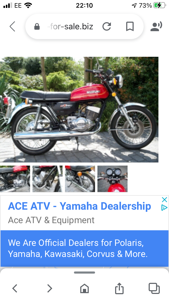

  1. The rear mudguard has issues! No way Suzuki mounted the light like that. Though the actual light does look like a genuine one but perhaps not the bracket? The front mudguard doesn't look like its the right one either.

  3. Yes, I tend to agree but I just found this, so that’s 2 I’ve seen apart from mine with the weird rear light/mudguard, foreign market?, aftermarket?, the thick plottens!
    The front mudguard looks like the one used on the ram air previous model, I’ve see a fair few GT250A’s with this twin stay front guard but they could have been retrofitted or maybe Suzuki used up old stock at the launch of the A model, I’ve joined the VJMC some anorak on there will have the answers for sure!

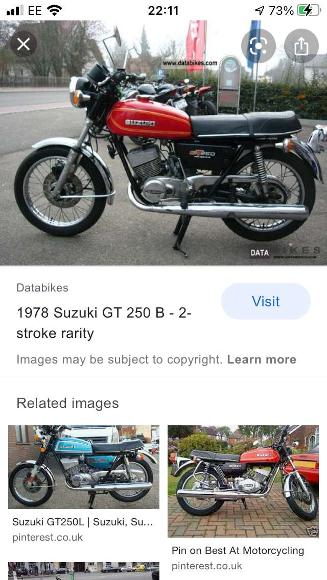

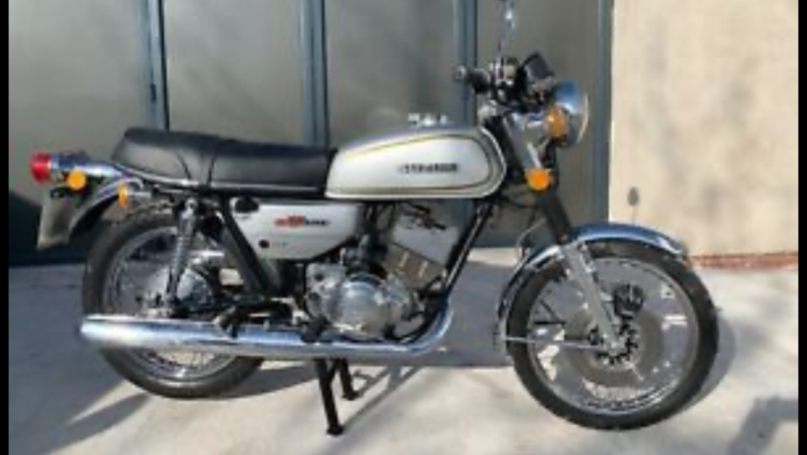

    Then how do you explain this beautifully restored example Jez, and the fact that one of the VJMC anoraks actually has a German import model himself with the same rear set up :)
    Or this one, btw these are both B models but the same applies
  9. Well as I said its possible that the Germans had a different light bracket for their market.
    However as you pointed out the bikes featured is a "B" and typically has a different light shape in all markets except for the two pictures you've attached. So its my guess that your original idea that a German aftermarket supplier made them & perhaps still does.
    Perhaps the anorak likes to think his bike is 100% original? (and it could be). I think the yellow side reflectors were standard issue by the time his bike was produced so something is a little strange. They are integrated into the sides of the "B" rear light lens.

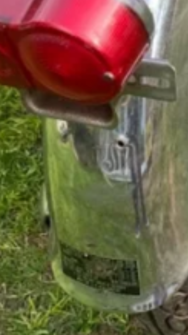

    Good point re part numbers, I’ll definitely check that out , on the photos I can see a decal at the bottom of the mudguard, it looks like one of those that the manufacturers put specs on, like total laden weight etc, unfortunately the photo resolution isn’t good enough for me to enlarge it enough to be sure but it does look like a Suzuki sticker, (just added photo, of course it could just be black gaffer tape:) :) ) the seller will be surprised on Saturday when I dash to the bike and start closely inspecting the rear mudguard!.
    I think it’s Suzuki Jez, I’ve now found too many examples of it on other GT’s with it fitted, why it would be different to the rest of the world is a different question though??.
    Edit: German law requires the mudguard to be 150mm from the axle centreline, that would account for it being longer.
