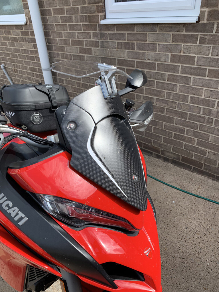

  3. I was in the same position as you, terrible buffetting. I am only 5'7" and sit lower, with the seat in the lower position.
    I tried various screens, with and without spacers. I ended up making my own spacers which lower the screen further, and then fitted the wind deflector as shown. Yes it looks different :blush:, but it has made a night and day difference. All the wind is kept beneath my helmet and it has made riding enjoyable once again.
    The helmet also makes a difference, my Shoei NXR is terrible, the AGV best, and Arai in between the two for buffetting.
    What also makes a difference is whether i have a tank bag or not, and with / without passenger.

  4. The Palmer bracket is definitely worth the money. I did the spacers beforehand. Big improvement with Palmer mount.
  5. I’m on screen #4, less than some here. Same as others have said, the smaller screens with lots of clean air work better for me at 5’9 & high seat position than taller screens with less direct air but lots of buffeting.

    since then, I put a little over 60,000 miles on the two multis (I now have a 2018 1260s), and have gone through 7 different windscreens and 2 different spacer sets, 3 different full face helmets, and perhaps 5 different brands of ear plugs ... and on both Multis, I settled on the Pikes Peak screen with Iconic Parts spacers.
    the current set up of pikes peak screen, iconic parts spacers, the seat set to highest position, Schuberth C4 Pro helmet, and Loop earplugs provides the quietest most buffet free ride, at all speeds ... and I am comfortable even on 600+ mile ride days.

  12. This intrigues me. Despite having a Puig sports screen I've only offered it up to the bike. Not that keen on the carbon effect in this case, I bought it used from a member on here. Was of the impression that it wouldn't offer much in the way of wind protection but from what you've said about the PP screen, which is even smaller, I think I'm going to give it a try. If successful I'll order a tinted acrylic one.
    Not too unhappy with my current setup of the std MTS screen and Iconic spacers but if the Puig improves on that and still offers decent long distance protection then I'll be sold on the idea of spending yet more money on this issue.

    have you looked at the stock Ducati Enduro windscreen? it's clear.
    I had one on my 1260s for a month or two, then another local Ducati Multi owner with a Pikes Peak wanted to swap the clear Enduro screen for the carbon fiber screen, and I ended up with that.
