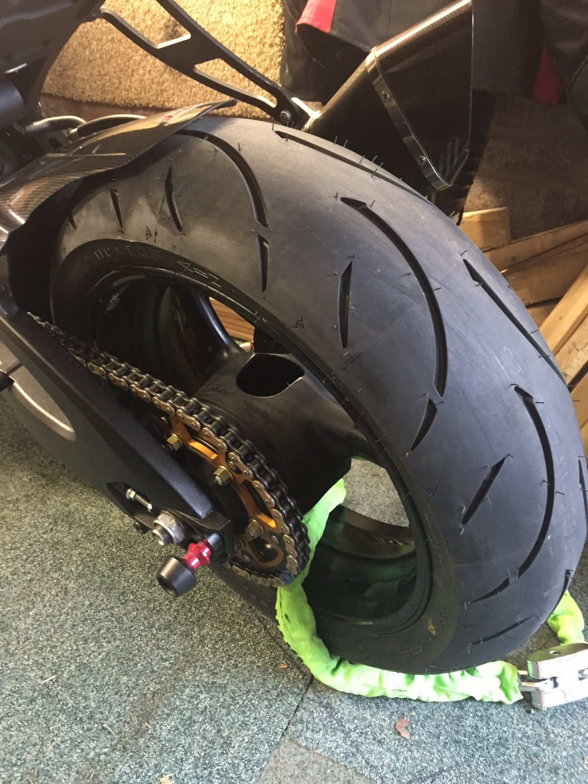

  1. I've got knobblies! Just very small ones:)

  6. Excuse my ignorance, is scrubbing not to the point were the tyre ripples? You know, like gets really sticky?
  7. No 'scrubbing in' is basically taking the shiney surface of a new tyre. When a new tyre is fitted its normally shiney (its still got release agent on it from the mould) so this needs to be 'scrubbed' off by running over tarmac. Tyres can be a bit slippy over parts of the surface till this is done.
    When people sell scrubs or go out on a set of scrubbed tyres (especially in F1) its basically because they have been run for a lap or 2 and the surface is worn slightly......in F1 they can be past their best already!
  8. on track 3 long rights and 3 long lefts is usually more than enough
    keep it smooth, brake gently and don't wind the gas on too hard while still lent over for the 1st 20 mins of a road ride and you will be fine
  9. I spent half hour with emery cloth on the tyres on Friday night as it was raining and I was cleaning the bike and check it over, it took all the shine off and I had no dramas over the weekend even with an emergency stop as it started raining yesterday. I wasn't going mad but had fun...
  10. I don't know if sandpaper / emery will do anything for it. I've not got a Duc (yet) but I do have the Dunlop Sportsmart 2's. On my Gsxr 600 they are fantastic tyres. Took no time to scrub in. Just go easy first few miles and gradually lean into the corners. The tyres themselves really inspire confidence.
