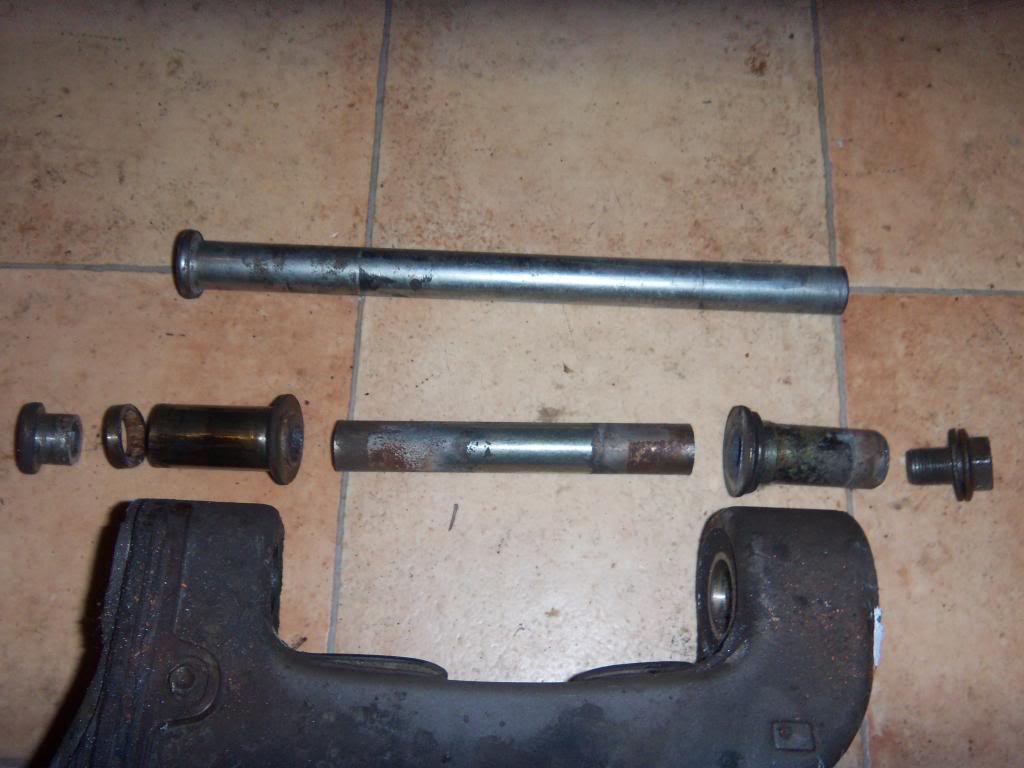

  2. Thought I would keep going with this, things had been put on hold for quite a while as I sorted some personal stuff out but am getting motivation back to crack on with this.
    So dragged the thing back out into the middle of the kitchen and realised I still had to saw through the swingarm pivot bolt, not only that but the bush that sits in the swingarm as they had pretty much fused together.
    Now I don't know what the bush is made of but if you have ever tried to saw through a padlock shank you'll have an idea of how many hack saw blades I went through!
    Didn't want to risk power tools as a) I didn't have a blade thin enough and b) Didn't have balls big enough to trust myself not to slip and graze the frame. But if you have both then I would guess that it would be a 2 min job and not the 6 hour on and off epic it turned out to be.
    Anyway, some pictures.
    Took 3 cuts in all to get to this stage, if ever there were any motivation to whip out the pivot bolt every 6 months and grease it up then here it is.

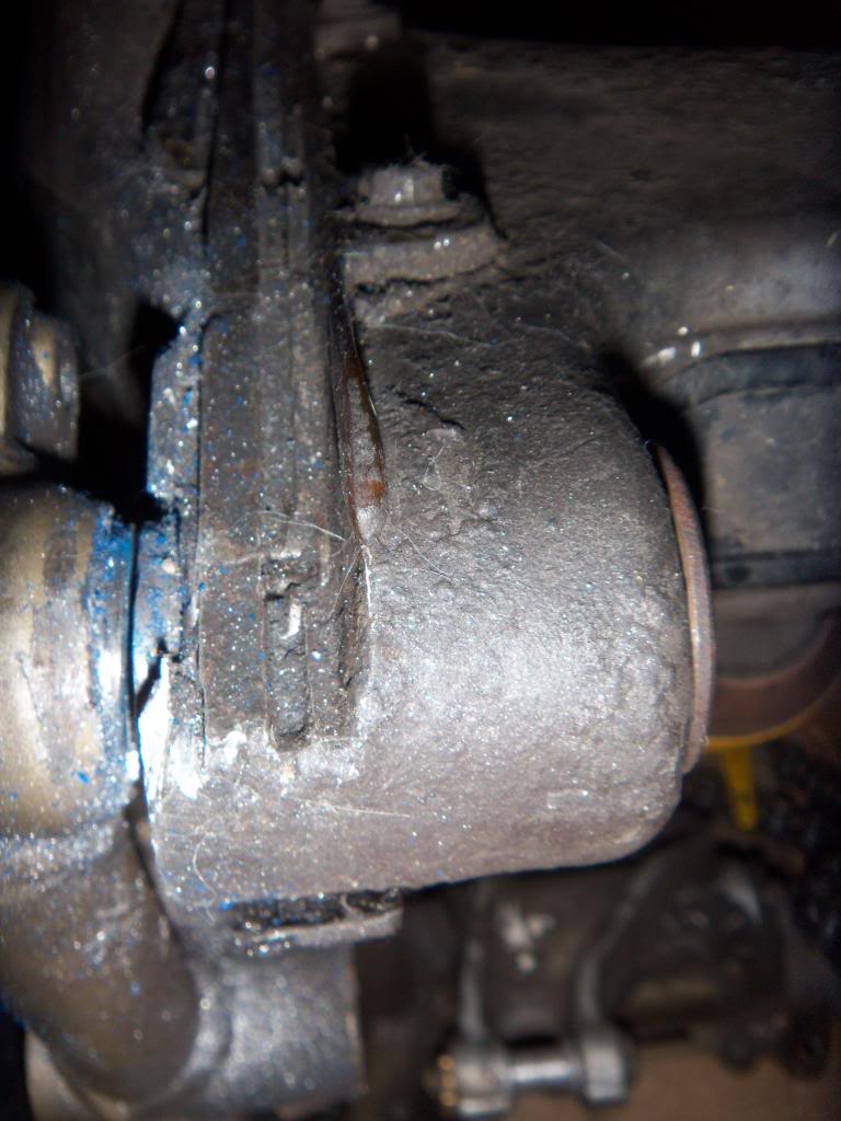

    Next job is to strip down the front end, forks need attention as one leaks, brakes could do with a full strip down and clean as they have fork oil all over them.

  4. I salute your tenacity, job well done.
  5. Good job :upyeah: Anyone who's been around Ducatis for long enough would've cme up against a stubborn swingarm spindle, luckily I've never had one seized like that!
  6. ^^ Probably one of the worst jobs you can do on the old 748 series bikes. I have done a few and one took me a week to get out once!!! Plenty of penetrating oil and regular bashing with a drift etc. So far haven't come across one that won't move after a time.

    Tomorrow's job is a full strip-down and clean of the front brake callipers.
