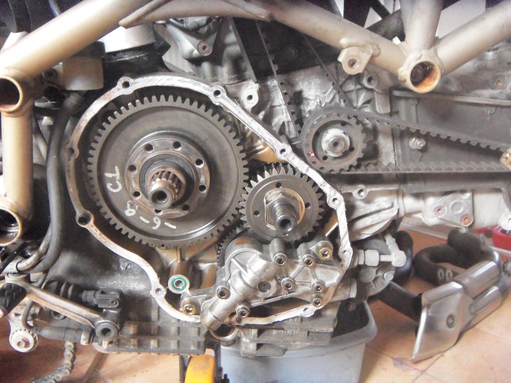

    Flywheel side cover is off, cant see anything amiss behind it.

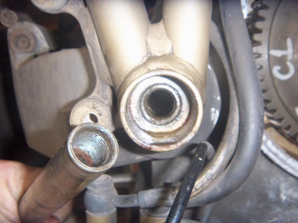

  8. Make sure the swingarm pivot is free to come out before you go for the final drop. They can be bastards if they've siezed in the bearings. Don't forget also the back end will collapse when you pull the swingarm pivot :wink:
    If you're doing the job on your own, i'd suggest getting as much of the motor stripped off while it's still in the frame. Heads, cylinders (you can inspect the crank with them off), clutch housing, primarys....all much easier in the bike and makes the bottom end much lighter to handle.
    The only issue I see you hitting is the priamry gear on the end of the crank. You'll need a puller and a hefty one at that. You can still split the cases, you just can't get the crank out of the RHS case.
  9. Which genius designed the swingarm bolt/pin affair!
    Cheers nelly, Going to let the penetrating fluid do its job and start taking the engine apart in situe now I've got the loom out of the way.

  10. Took me a full day to get the swing arm bolt out.
    #30 Birdie, May 2, 2013
  11. swing arm bolt is rediculase to get out still not got mine out on my 916 need too rebuild engine too i spent half a day at it till the missuses said that was enough banging keep the pics coming intrested in seeing whats wrong not sure what delights i will find when i get mine out of the bike good luck
  12. Have another swingarm "pin" from another swingarm so got a decent sized drift to hammer the other one out once the fluid had done its job.

    All that looks ok whatever it is, took the cover off what I assume is the oil pump and everything is fine in there, no blockages or bits broken.
    Had a quick look at whatever valves I could, seem pretty straight and undamaged, might be adifferent story with the other 4 I cant see but will come to that later.
  13. The swingarm seizes in the bearings in the swingarm...try and flood the area with penetrant, behind the frame boss and between the engine cases and swingarm.
    If it's stuck, it's about the worst chuffin job you can get :mad:
  14. Haha, yea am drip feeding it penetrating fluid as I type but also pondering exactly what shape Italian spanners are because for the life of me I cant get British ones onto 4 of the cylinder head nuts!

  18. Can you pull the primary gear off . That will disconnect the engine from the gear box . If you can turn the engine then you will know its the gear end or vice versa .
    The big one . Sorry if you knew .
    #38 ducati2242, May 2, 2013
  19. Cheers, I had no idea what it was, will give it a go in the morning.
    So the big one is attached to the gearbox gubbins behind? Is it a simple jiggle and slide off sort of thing or will it require a puller?
