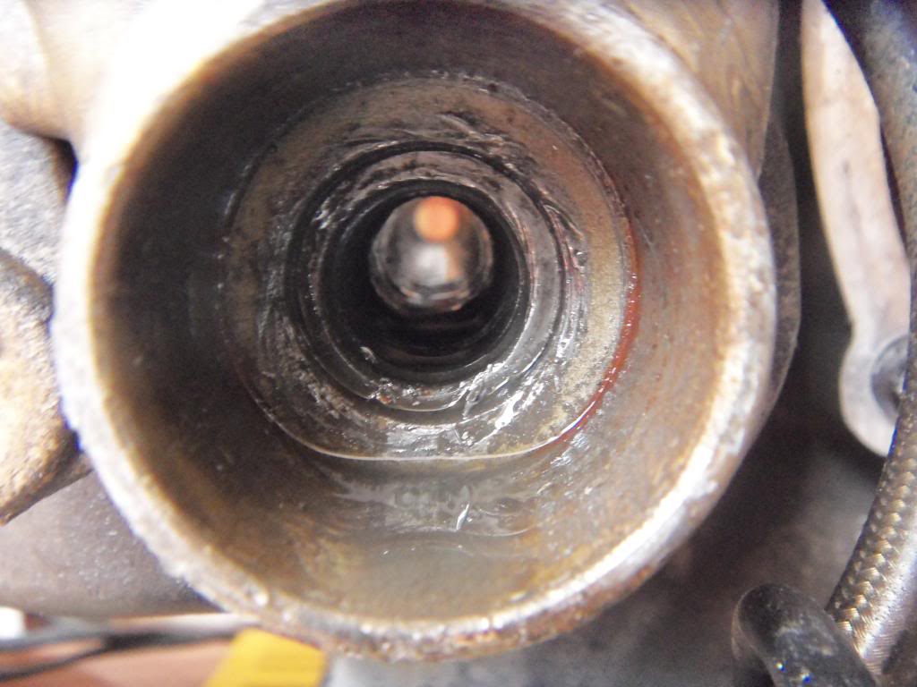

  7. Tried having a look around for Plus Gas as that's always worked for me, might have to wait til Monday for the decent family owned motor factor place to open.
    Might be my mind playing tricks on me but it looks like its shifted about 1mm maybe 1.5mm, WooHoo!
    Oh, bought a bigger hammer..
    The b$%^&*d in question:
    #67 luckymarine, May 4, 2013

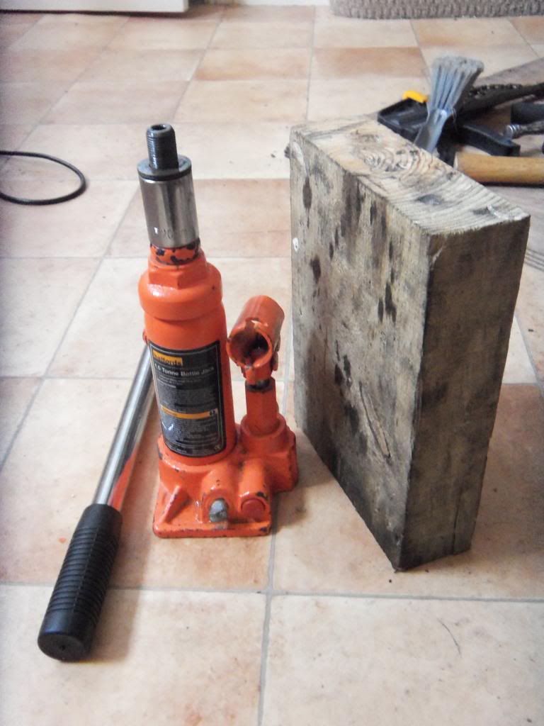

  14. or even better,with a bit of imagination.you could get it out using your trolly jack(using the hydraulic pressure).get the bike up against the wall,set up the jack so when you pump it it puts pressure on a shaft that fits onto the stuck axle.block of wood behind the jack and pump away.i know it sounds a bit A TEAM,but it will work.

  16. Anything A-team related sounds amazing, might have to wheel the bike outside for that one or will probably end up pushing the bike through an internal wall!!
    I was thinking of using a G clamp whilst I was pottering around machine mart for inspiration. Just couldn't find one big enough.
    Like the thought of using hydraulic power though, have a bottle jack knocking around somewhere....
    Watch this space.

  18. Tomorrows plan.
    These tools.
    This gap.
    Will probably end up breaking something, just hope its not the frame..
