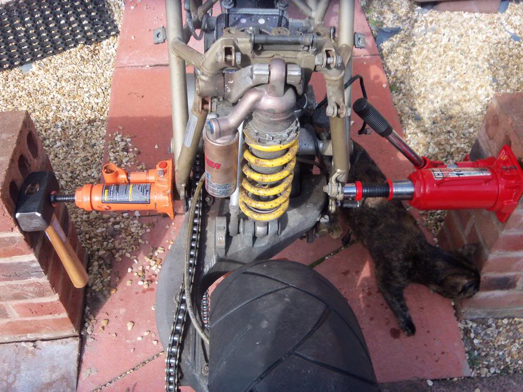

  1. [​IMG]
    This was working till the wall on the left side started to lift. Hammer is being used to spread the load as the block of wood just split in two...
    Ram it, Im going to cut the thing off, have another spindle, and another swingarm if I need it!
  2. Have you crushed the cat?
    One more try with a larger hammer?
    Did you manage to get any Plus gas yet, it's got to be more effective than WD40!
  3. Not got any Plus Gas yet, might have to wait till Tuesday as I'd forgotten it was a bank holiday.
    Will leave it till then and have another go with the jack/cat combo after soaking the whole affair in Plus Gas.
    After that will phone the dealership an ask how much they want to get it out, if that turns out to be an epic amount I'll cut the "minchia" out!
  4. Mate, I have told you how to get it out. Bottle jack and a hacksaw blade.
  5. Yea wanted to see if I could get it out without resorting to cutting anything.
  6. You need a set of bearings, spindle and spacers anyway.
  7. If it's not budged yet, as has been said, cut it out. If the spindle is that seized, even if it cleans up are you really going to want to put it back in!

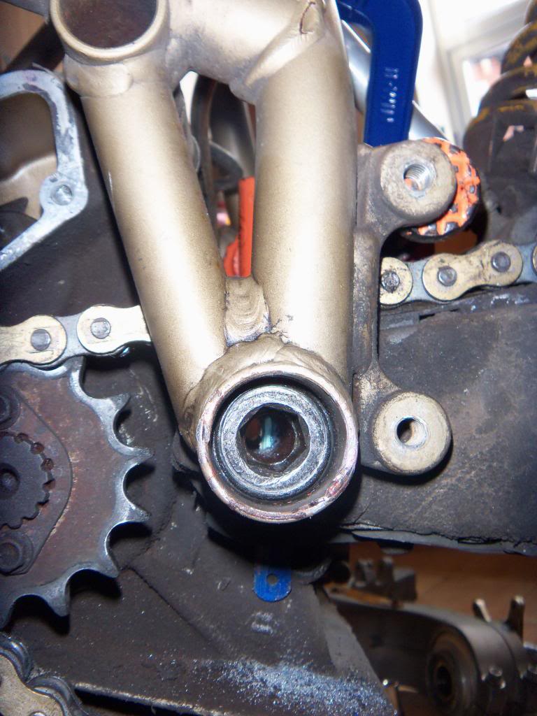

  14. Just found this.
    Sweet!
  15. Might as well keep up with the pictures, might help someone else some day.
    Took about 15 mins to get to this stage, thankfully the spindle is hollow so the toughest parts seem to be the beginning and the end.
    Engine mounting bolts have their nuts off but are left in place, allows the engine to slide from side to side and creates the gap for the saw blade.
    Have the trolley jack under the engine because when the final cut is made the swingarm should come free and the engine and frame would drop otherwise.
    #115 luckymarine, May 6, 2013
  16. Excellent photos:upyeah:
  17. 2nd pic down,is that a crack in the weld on the frame mate?.:eek:
  18. Nah just a bit of surface rust where the paint had been worn away where the weld bulges out.
