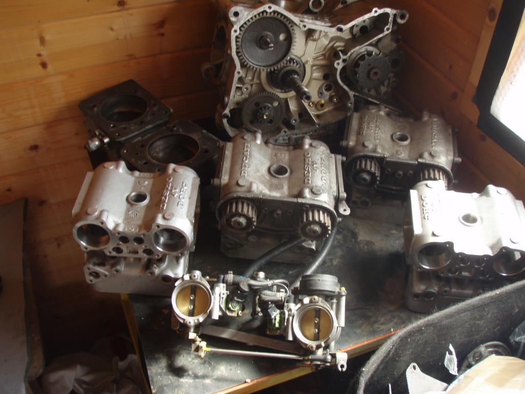

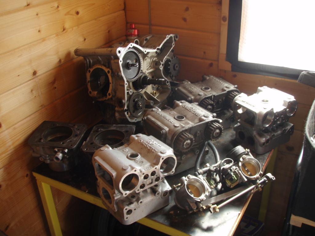

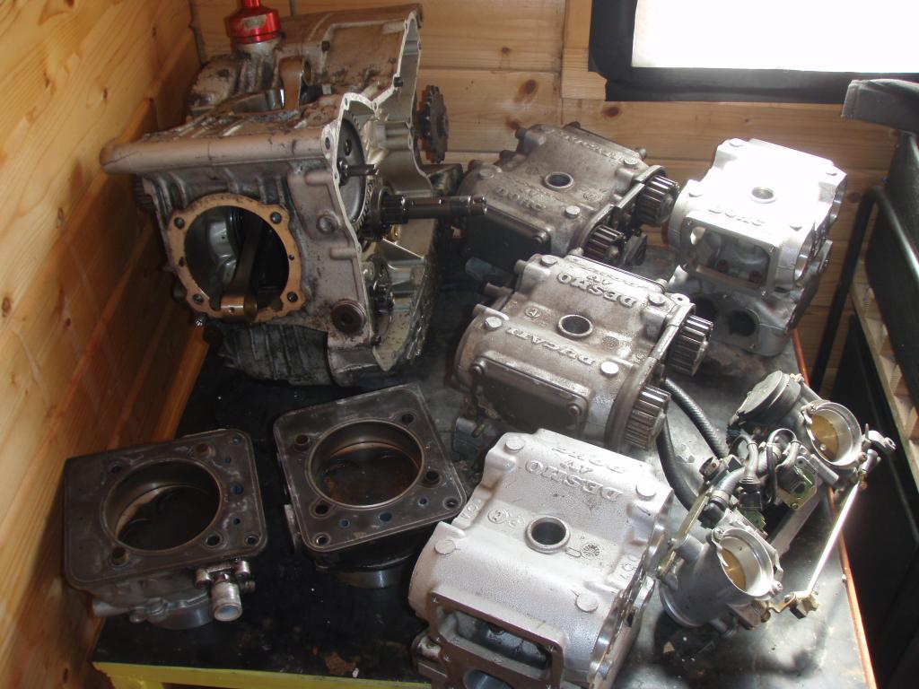

  15. 748 engine 003.jpg 748 engine 002.jpg 748 engine 001.jpg if you need any bits,i have all these from a 748 mate. :upyeah:
