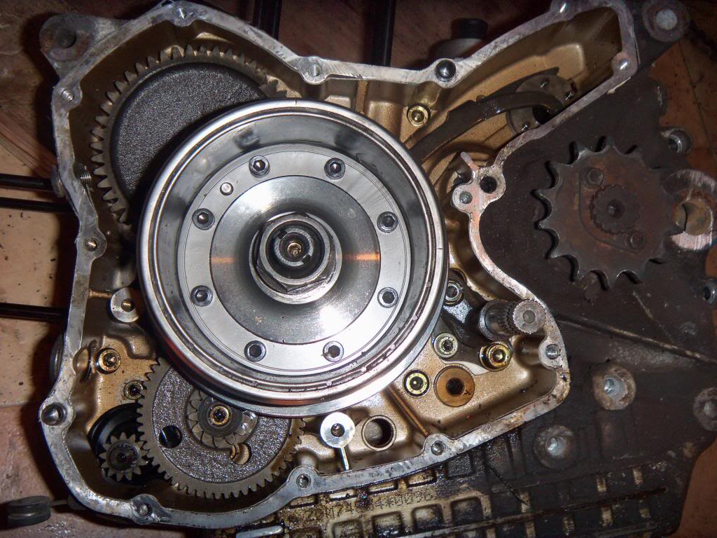

    As the innards of my engine are probably mangled to hell anyway have started on my quest to split the engine on my kitchen floor.
    Got this off...
    Do all the golden hex bolts have to be removed?

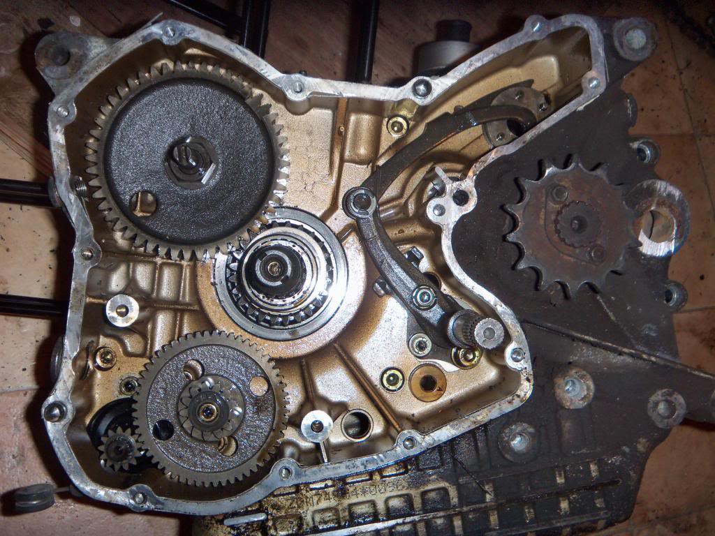

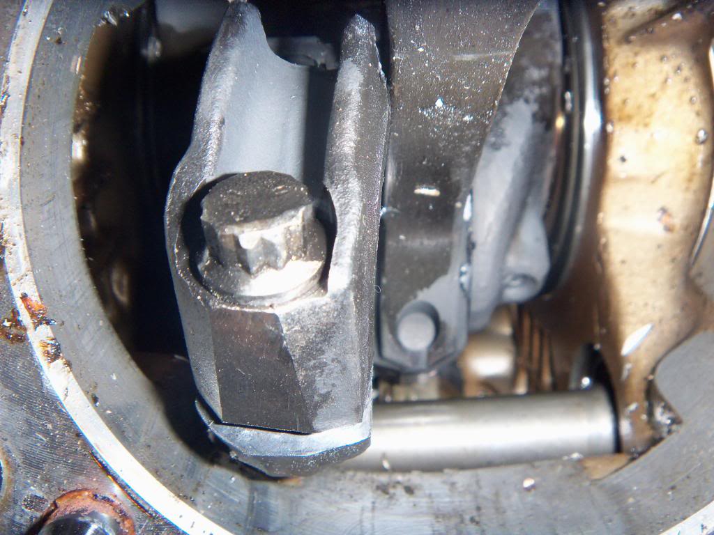

  4. This shaft has been bent by the force of the conrod slamming into it.
    Means I cant turn this in order to line up the hole in the gear with the hex holts holding the engine casing together, I think there are 2 of them to undo under the gear. Will have to figure out a way of shifting it...
  5. "conrod flailing radius." Brilliant:biggrin:
  6. Going to try and cut here, should allow both ends of the shaft to just slide out of their respective sides.
    Im guessing its going to be strengthened steel, any ideas on how to get through it??

  9. check it with a file.it looks like alloy to me?..

  19. I can only assume that the key in the timing gear has to line up with something on the shaft in order to be slid off as its really really tight and there's no movement whatsoever.
    Either that or the bend in the shaft has locked the teeth with the other gear you can see on the crankshaft, not really enough space to get a puller in there either.
    On the other side there is a weird nut holding on the gear that spins both belts, have tried nicely to get it off but I grow weary of its stubbornness to move. Tomorrow I'll nut split it off, hopefully slide the gear off and then hammer the shaft far enough out for this end to disengage.
