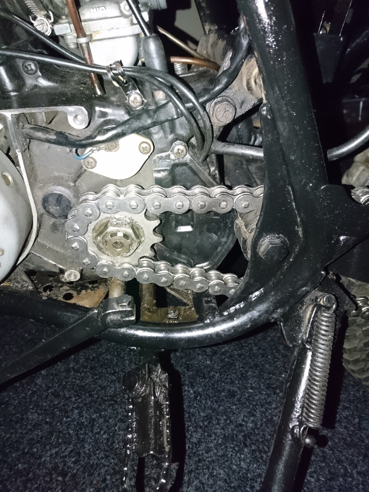

  6. Yeah I know, but I can`t believe it`s still stuck fast. Look at the picture in post 210, a hard stare should be enough to make that sprocket fall off.
    I still think the sprocket tabs or the splines have become distorted and that is what is holding it. A bead of weld around the sprocket close to the spline may get it off, an old engineer told me that years ago, it concentrates the heat better than a naked flame, and if you wrap a wet rag behind the sprocket the heat won`t damage the oil seal.

  15. I know how to remove it
    • Useful Useful x 2
  16. we are all ears..
  17. I cant wait till Wednesday!Lets all pile round!
  18. Point 1, that little puller won't work.
  19. Isn't that where it's meant to be?
  20. After reading this thread for the past two weeks, I began to feel restless. I wondered -what must it be like to be Paul? To faced with this enormous challenge against such a formidable enemy... I couldn't sleep properly and thought about it all the time. I had to know if I could gaze upon a Sprocket of my own, stare into its eyes, see its black heart and not run away. Would my trusty Chrome vanadium spanners & socket set wound this beast? Could I grab it with both hands and tear it off its spline to victory? I woke today and knew it was time...
    Took twenty mins start to finish including washing my hands. Easiest job in the world on a 1980 trailbike.
