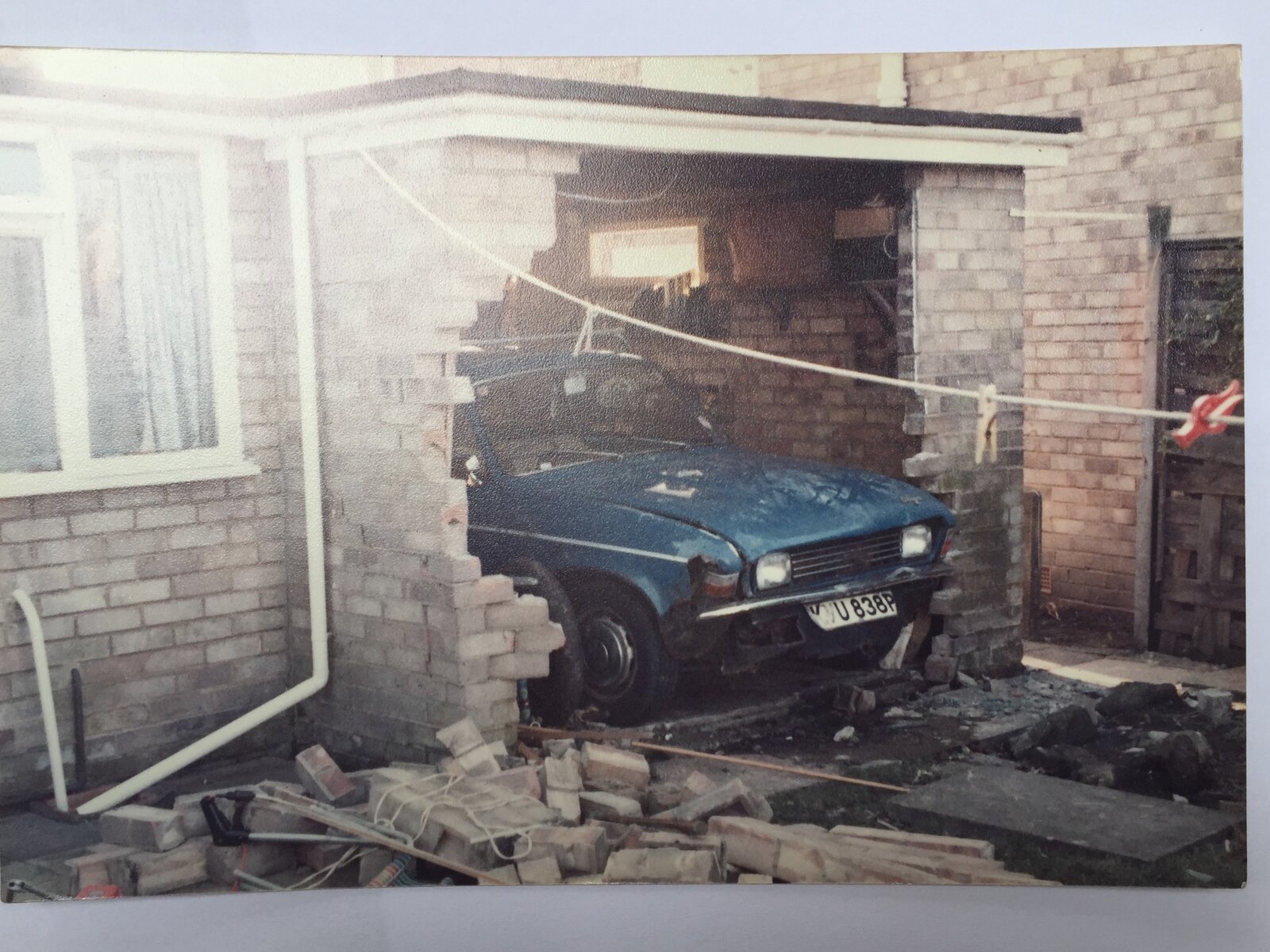

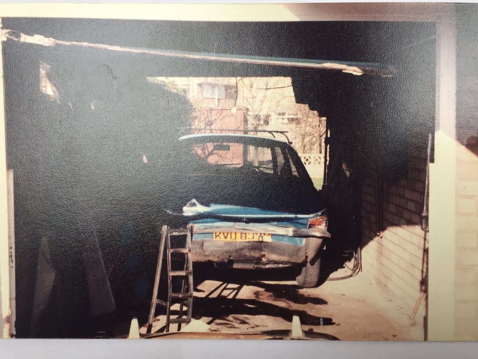

  5. I'd sue the garage door makers. The mountings were obviously substandard.
  6. Well, I don't feel so silly now. It genuinely can happen to anyone.
    Thanks, Borgo!
  7. You a dentist by trade?
  8. Novice mistake! The hole should have gone through the wall not the door :rolleyes:

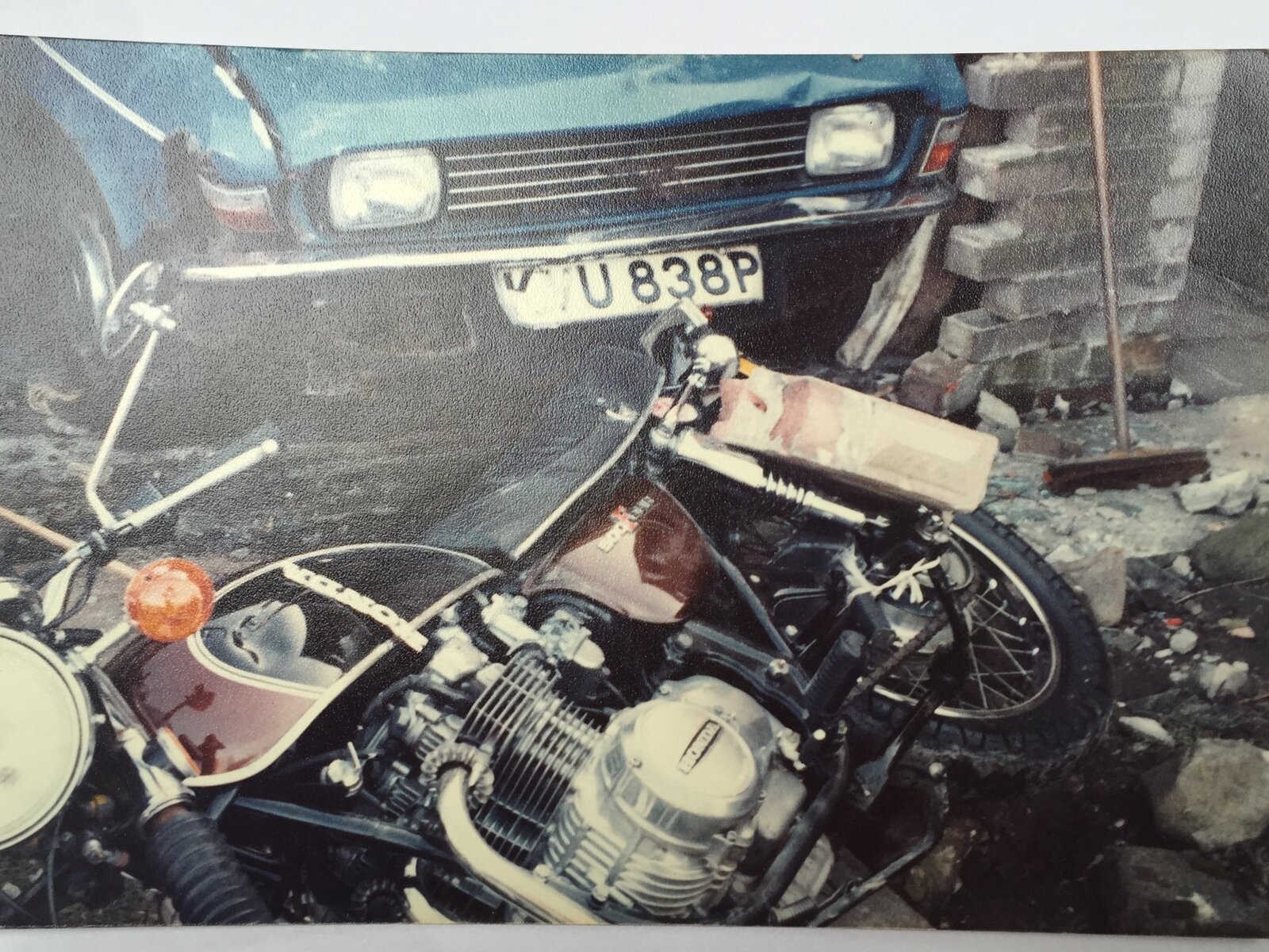

    Worked a treat back in the day with my mates Honda, we tied it to the front of the car too not the back :thinkingface: but got a bit of recoil, your rope idea is better than a bungy, granted o_O
  9. Perhaps a VET - should've used the tractor..... :thinkingface:
  10. The problem there is you were using an Allegro by the looks of it. Should have used something a bit stronger/sturdier:)

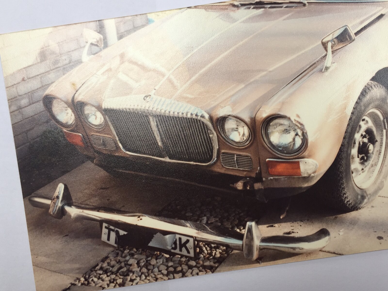

  11. It was momentarily connected to a Jag, but perhaps not for long enough :thinkingface:
