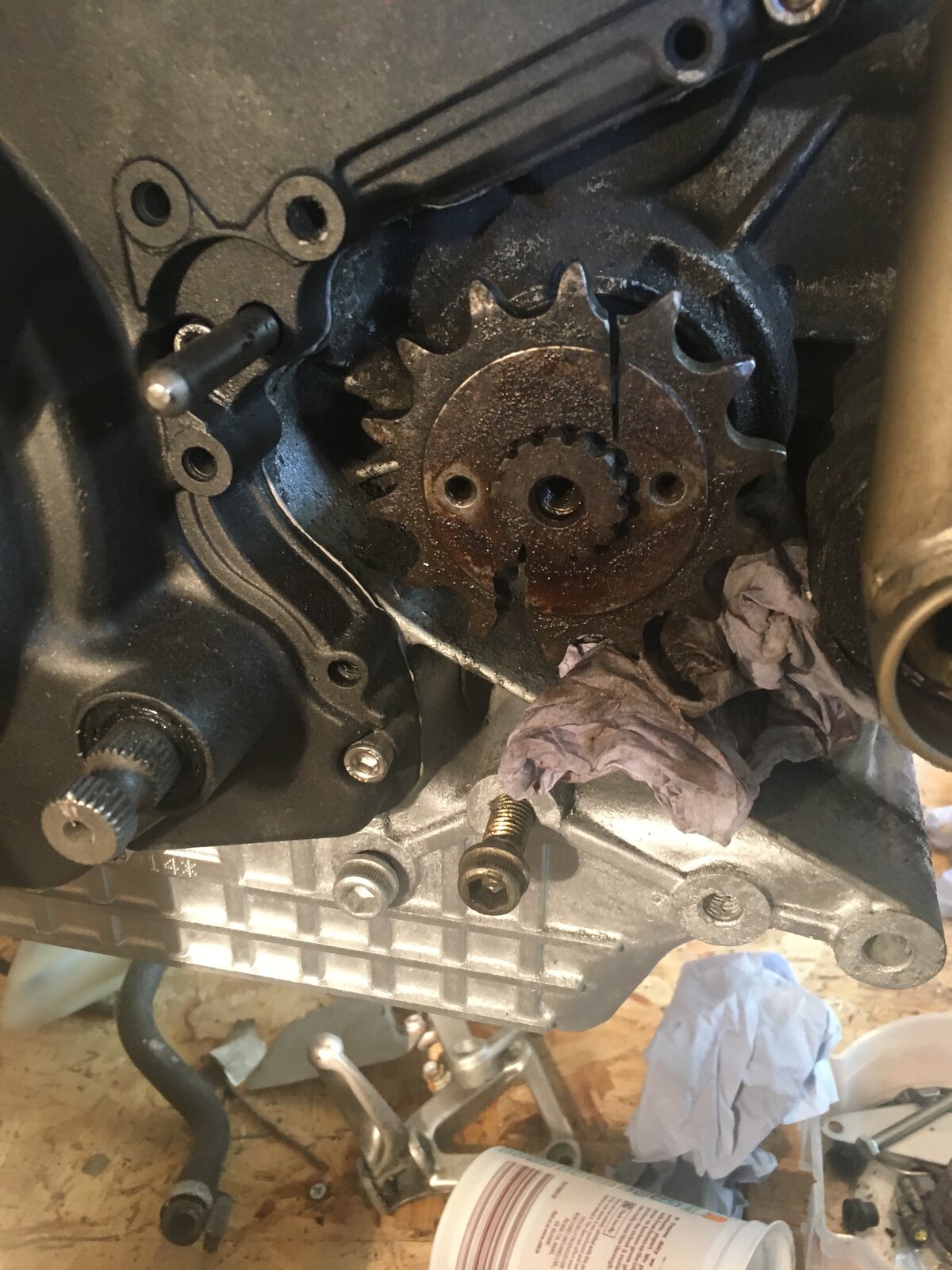

  1. and once the sprocket is off he will be able to fix that too. :p
    its a method i have used to free seized wheels on hubs. i'm guessing the sprocket bolts will be renewed too so i would leave them in loose.
  2. With the couple I had to cut off, I found it necessary to remove a section (sector) like a pizza slice. This removed the tension on the sprocket and it fell off.
  3. he’s done that duc2 - it’s the rust bonding that is the problem now.

  5. Yes, more like an alternator case puller. You’ve already got a template for the hole centres as it’s the same as the lock washer.
    Wind it tight then tap it with a big hammer.
    Make sure there’s something soft to land on!

  8. Aha, Thurs (ie today) became Wednesday as the family had different plans for me for Thursday (ie today):(. Although as I type I’m trying to work out a way I can get back into the garage to attack it again:thinkingface:.

  9. I will sneak out to the garage and take a photo as it stands at present
