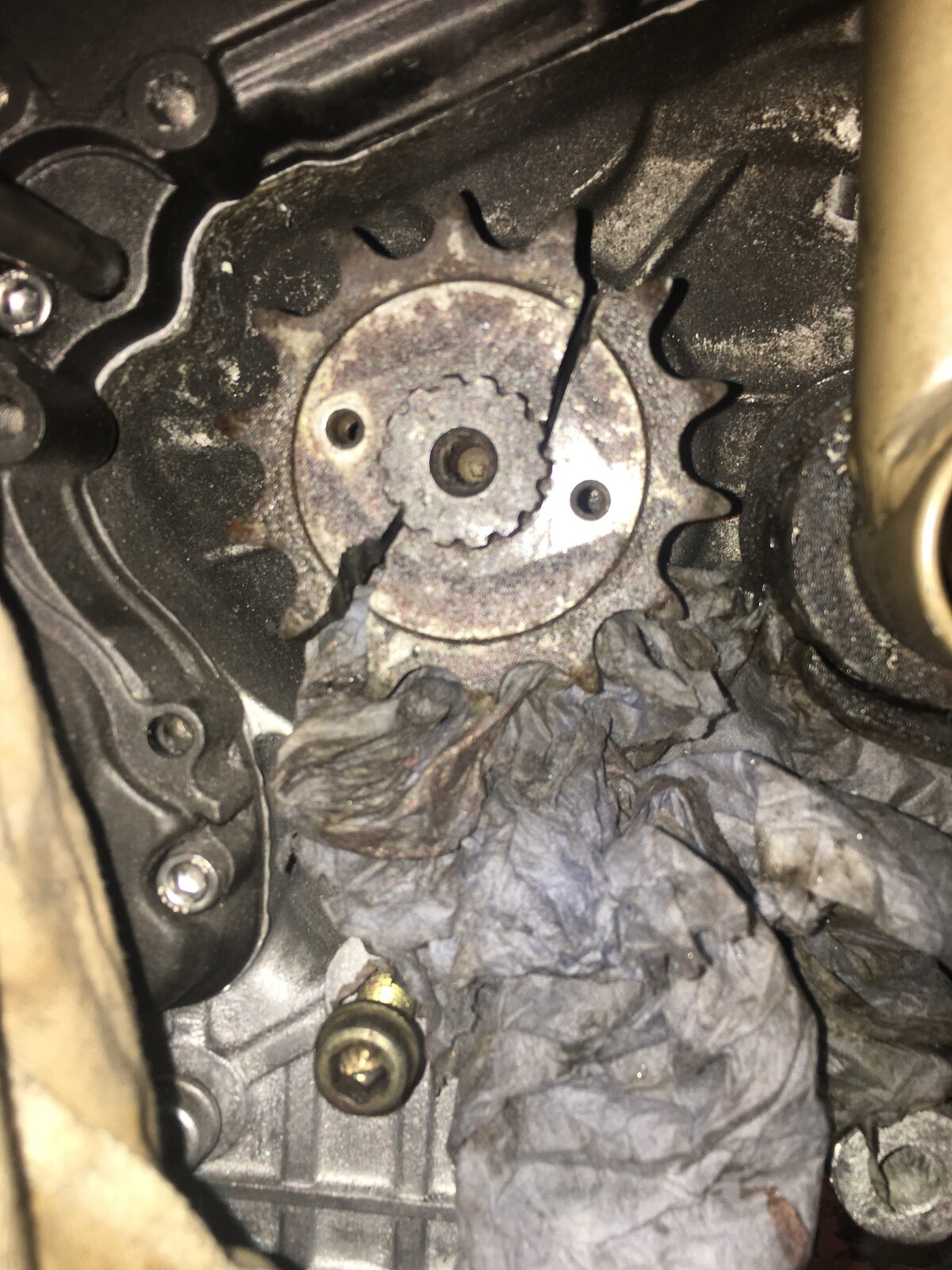

    As can be seen the split is 52/48 in favour of the bigger side but still it refuses to leaveo_O
  8. Can we use spoiler tags please cos my anxiety levels are now through the roof.
  9. So far I have overheated my 4” angle grinder (but that was too big anyway); broken 2 Dremel bits; cooked my Dremel; blunted the hacksaw blade; and, damaged the tendons in my wrist when the Dremel got caught, stopped and kicked back as I tried to extract it pronto :confused:.
    But, I will not let the sprocket win.
  10. Cut through where the right hand hole is and remove a section. Then it will come off
  11. Or screw in a couple of bolts and pull the 2 halves off - might as well strip those threads now :bucktooth:
  12. Lucky you've decided to change is as it looks like you have a broken tooth at the bottom - that may have caused you some grief.... :eek:

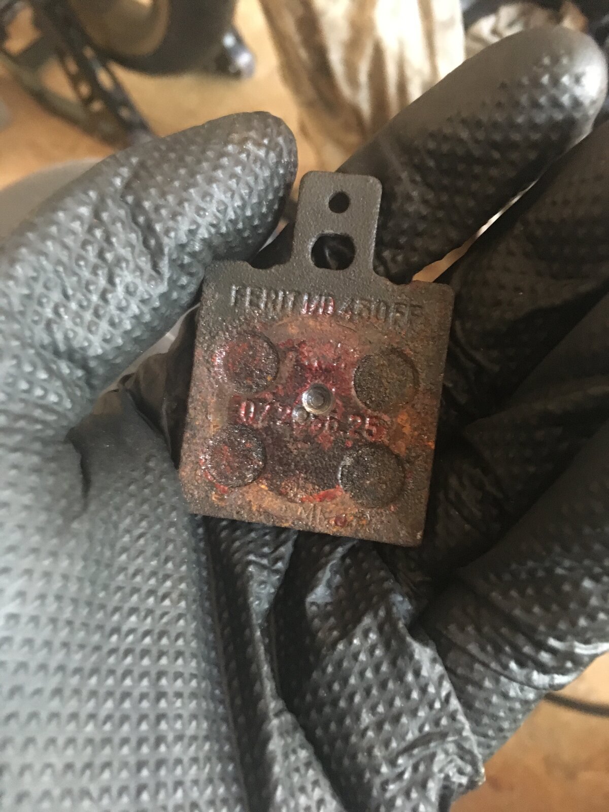

  13. I’ve also been investigating hydraulic pullers however as they seem to work on the same basis as my regular puller I’m not sure it’ll do the job without inflicting damage.
    You may recall from an earlier episode the central bolt of the regular puller was just pushing its way into the threaded central hole on the gearbox output shaft and the socket was not budging. Somebody suggested to avoid damage to that threaded hole I put a metal plate across the end of the output shaft. I tried that. I used an old brake pad I’d taken out but, as you can see, the central bolt on the puller just embeds itself into it and starts to drill a hole:confused:
    This socket is one tough bugger:mad:

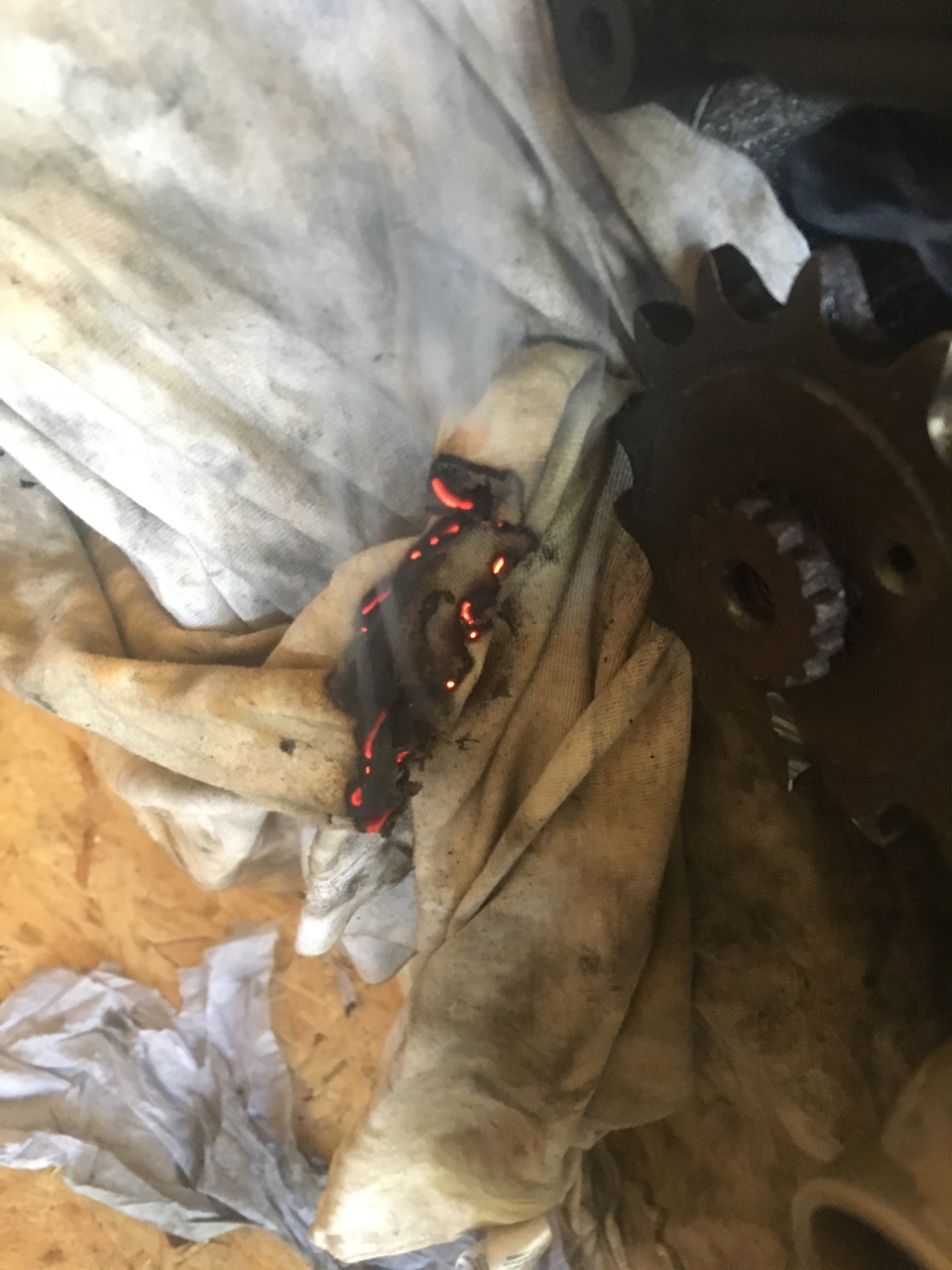

    No broken teeth, that was me with the 4" angle grinder at the outset. Mind you I did set fire to the old t-shirt I was using to stop the sparks from damaging my freshly coated crankcase:eek:
    I did but to no avail, neither the tips bent nor the sprocket budged:weary_face:.

    You should've left the t-shirt to burn, the heat would have helped loosen the sprocket ;)
