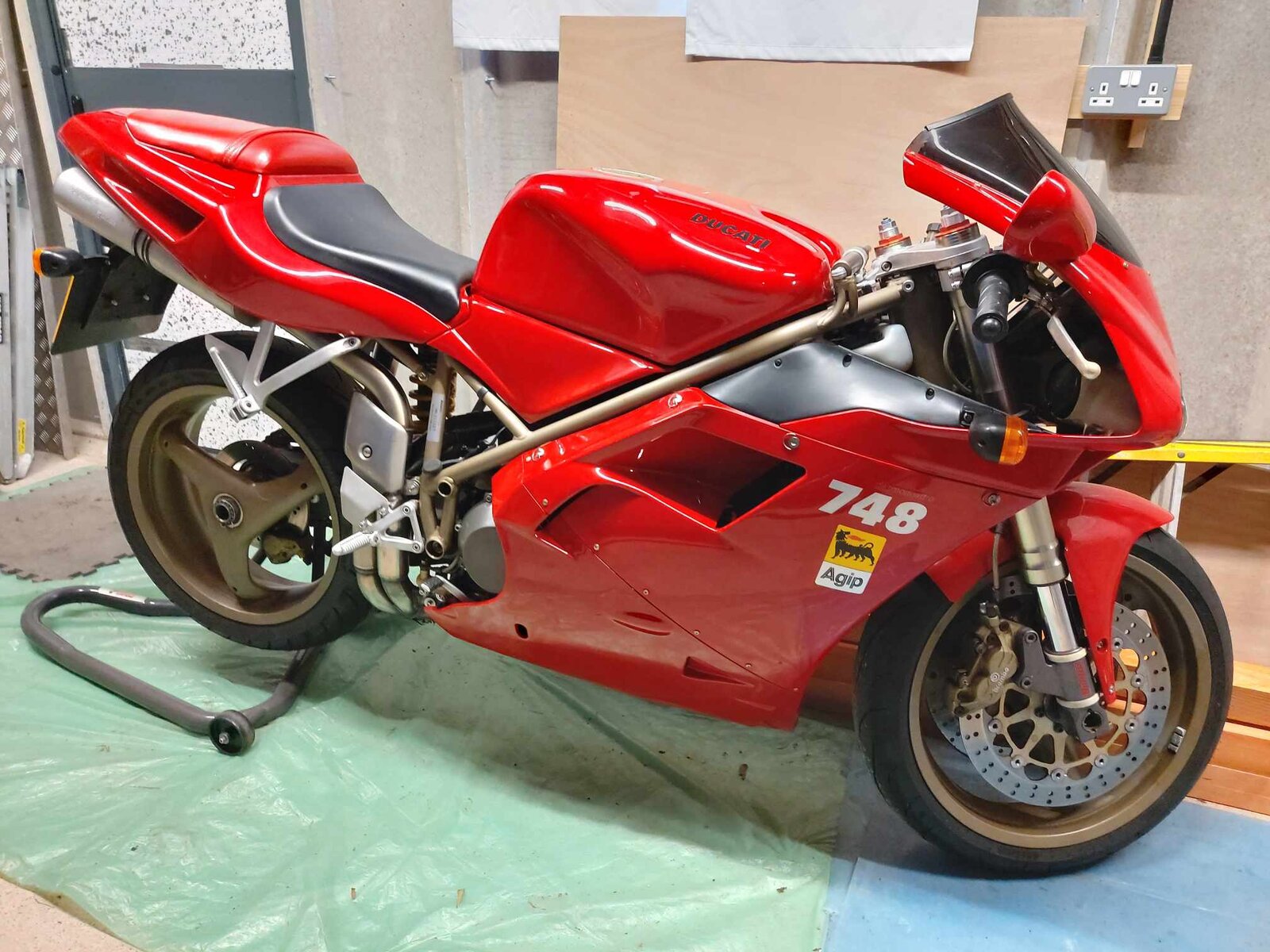

    Back to the 748 - it's not the best looking and by all accounts it's not original. But working on it has helped retain some sanity and there still plenty to do. I do have 3 of Ian Fallon's excellent Ducati books one of which provides all the data as mentioned above except the volume of each model built! Anyway, below is a pic of the rescued bike which has been serviced and given a clean bill of health (thank you Nelly). Happy to have non-original parts pointed out; I know about the tanks decals and the wheels/engine paint is scabby! RR

  10. RR - so sorry to read about your unbelievably shitty time and very much hope that you're finally climbing out of the primordial soup.
    Your bike [courtesy of the one image] looks extremely promising. Departures from 'standard' are the black touring screen and the painted Fogarty rep mirrors...... but you knew that already! ;)
    Unsure about the brake discs [others will clarify] but they don't seem very year 2000 to me - Ducati used the Brembo multi-holed bell from 1994 for many, many years.
  11. They look the same as the discs on my 2000 748, although ISTR to recall I have changed them, they certainly wouldn't be the originals.
  12. Thank you big_duc; Re health I should know a little more next month.... can't wait! Seems like I've been drip fed info but I feel okay and the longer I go without symptoms re occuring the better I guess. But going from near perfect health to struggling to breath was somewhat disturbing. But back to bikes... funnily enough I wasn't aware the mirrors were incorrect or the disks. I like my bikes standard, but had to rescue this one - why, no idea! So should the mirrors be black? I know the tank decals should be silver. Hopefully I'll get more time to bike it this year once its a tad warmer. Its only done 3,800 miles, just had it serviced by Nelly who gave it the 'all clear' thankfully. Even with the low mileage it'd been stood outside under a tarpulin for 2 years so it was a bit of a gamble! I'll post more photos at somepoint; the engine paint is really bad and the wheels need refurbishing. I've replaced many of the fastenings with genuine ones (££££'s!) since they looked really rough. Still lots to do though and please feel free to highlight other non-standard bits. Cheers RR
