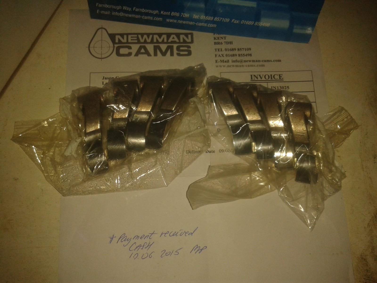

  7. Hoping to get some time this weekend and get the rockers in, fingers crossed shims will be a little on the tight side and can lap them down, what's the chance off that? Also think I have messed up the timing ,moved bike with it in gear, crank has done x number of revs ,no valve damage they're all shut at mo ,if I line crank mark up again I am thinking I could be 360 out is that right?

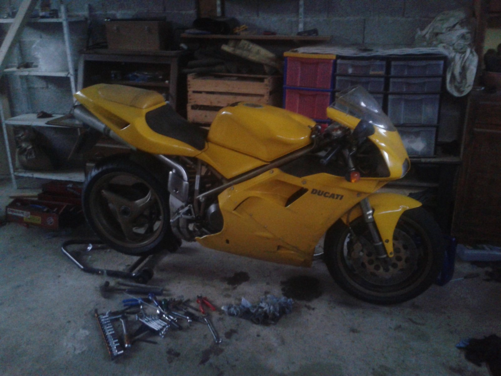

  11. All dressed up, still have to check the alternator nut plus fix the shity connections to the rectifier and give her and early oil change to see if I can find some glitter, happy she's in one piece again
